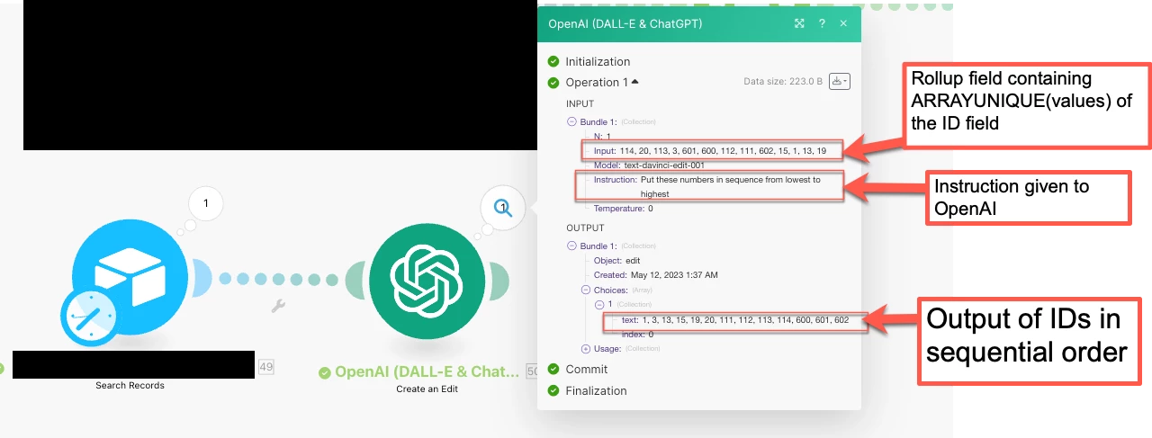

Hello - you can now do this with OpenAI / ChatGPT using Make, allowing it to happen real-time (aka without you having to manually trigger a script or other method) based on a LastModified or other trigger field invoking the Make scenario. Here's a screen shot of how I did it.
