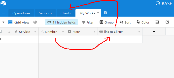

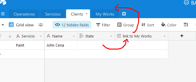

I will attach two pictures so you can see where is my mistake
My idea is to have every project data in a Record at Table1 (Clients), and share Table2 (My works) to an employee. Where he will read Clients info population like Adress, Name and he will able to set “State” that can be “In Progress” or “Finished” so in my “Client” table i will read whats is going on with that project.
If {Servicio} is the primary field in the table [My Works], you have to enter the corresponding service into the {Link to My Works} field in the [Clients] table.
Therefore, in your [Clients] table you should type Paint not in the {Servicio} field but in the {Link to My Works} field.
Your primary field in [Clients] should probably be the client’s name, not the service they ordered. Also, since you have a [Servicio]table, it sounds like the {Servicio} field in the [My Works] table should be a Link to Another Record field pointing at the [Servicios] table. If that’s the case, keep in mind that Link fields can’t be the primary field, so you’ll have to make a new field to accomplish that and maybe make the primary field a formula or autonumber.

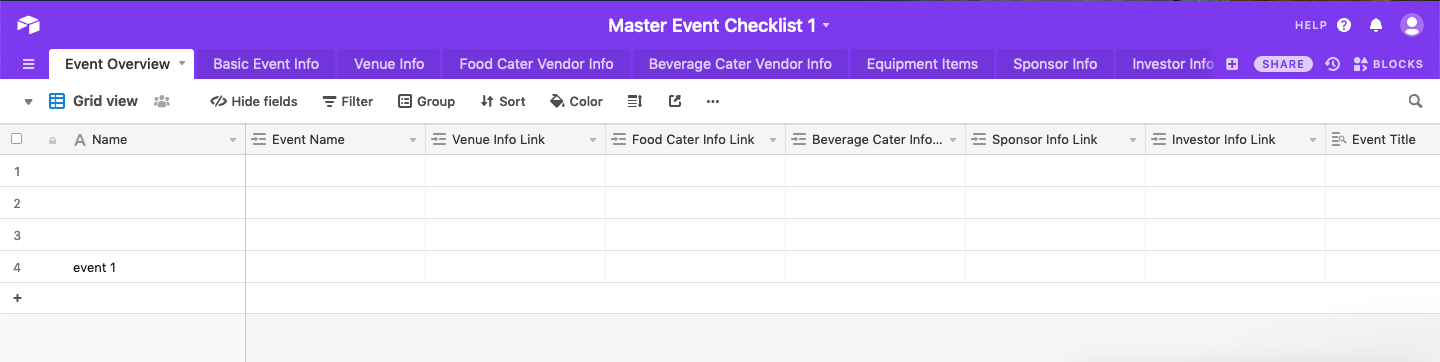

Within the attached image, I have the Event Overview table, and it is only supposed to pull information from other tables (Event Basic Info, Venue Info etc.) to display it. It has no function besides displaying aggregated information. There are other links between the other tables as well. I think I’m getting most confused by the linking to the first column design within airtable and don’t know how to accomplish the things just stated within that structure. Does that help describe my problem, @Kamille_Parks ?
If you want to pull info from other tables, then you’re using the wrong type of field. Link fields don’t pull information from other tables. They let you create links to specific records from other tables. It’s a manual process of choosing which records to link.
You’re not linking to the first column. You’re linking to the entire record. Because Airtable needs to show you something so you know which record is linked, it uses the contents of the primary field (the first column) as that link label, which may be why you think that the link is pointing to the primary field.

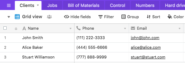

Once you have some linked records, then you can pull in data from other fields in those records using a Lookup field type. Here’s an example. I’ve got a [Clients] table that looks like this:

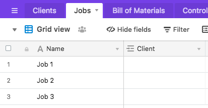

I then make a [Jobs] table, and want to link to a specific client for each job, so I make a {Client} field that’s a link to records in the [Clients] table:
In this field, I’ll choose the record for John Smith for my first job:

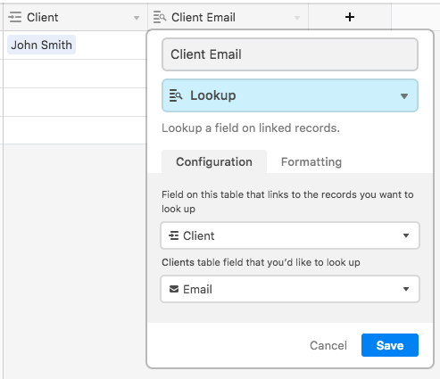

Again, this is a link to John’s record, not just a single field. Because it’s a link to a record, I can use a Lookup field to pull in any field from that linked record. If I want to see John’s email address, I’ll set up a Lookup field like this:
What this does is look at the record linked in the {Client} field, then pull the data from that linked record’s {Email} field into this one:
If John’s email ever changes, I modify it in his record in the [Clients] table, and that change is automatically reflected anywhere that {Email} field’s data is pulled, like my lookup:
