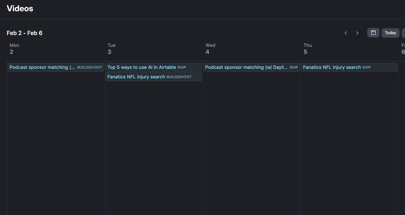

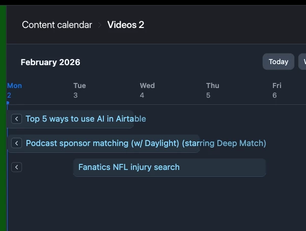

​@hello161 interesting, seems like you want to group/view by the calendar date itself rather than by the start/end date on the actual record as shown in your screenshot.
In that case, I would suggest using a calendar or timeline (as a view or interface) and that shows the multiple date types
for example, here is a content calendar that has different dates for when I’m shooting each video vs shipping it. That would be a parallel to how you have a start and end date for each booking.
This would give you a view of all bookings starting and ending on a given day.

Yeah, you’re probably going to want to build out an interface to get things just right, and timeline or calendar views are helpful for that. Aside from the basic filter conditions, this is when adding group, sorts, and colors on top becomes handy. You could add to ​@alexmcdonnell’s suggestion by coloring the records by Booking status.
