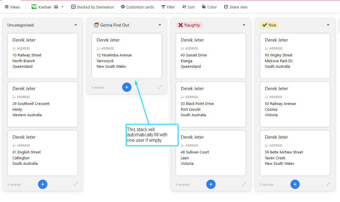

So, within the Uncategorized stack - you’re only wanting one of the duplicates names listed and then once it’s assigned, you want it to populate with the next duplicate?

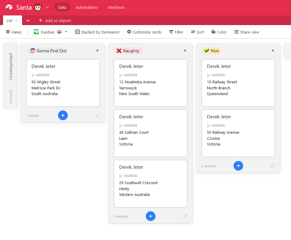

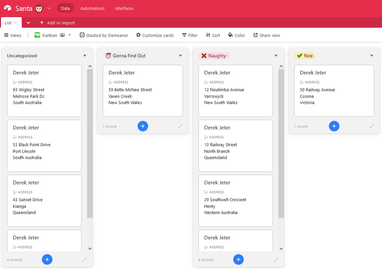

Here is the result that I just got working with an Automation Script - as with all Automations, it takes about 5 seconds to update;
So, my initial setup is this;

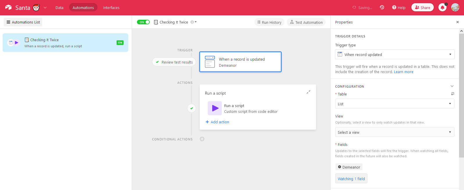

To get a step closer to what you’ve described, we’ll need to make our own “Unassigned” type;
We’ll then need to monitor that stack with a script, that scans the Uncategorized duplicate records and then adds the next duplicate to the custom “Unassigned” stack, limiting it to one at a time.
I wrote this Automation script in haste, so it might be buggy, but it worked well enough in my quick testing;
