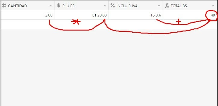

Hi, can you help me? I need to sum 16% if the field “Incluir IVA” contains 16%, if it doesn’t, just do the first arithmetic operation. Thank you
