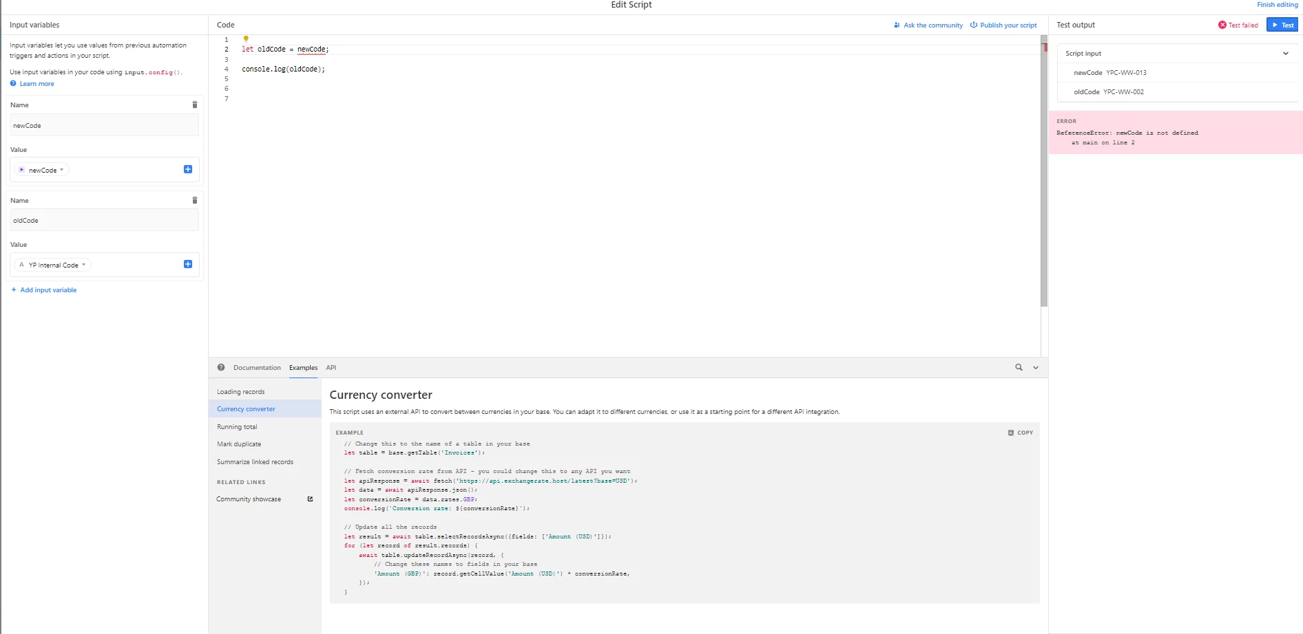

I'm trying to pass the output variable newCode into a new script, however I'm not sure how to define the variable before I pass it to the oldCode variable (see screenshot). Any suggestions would be appreciated!

To use the value of an input variable in the script you must use input.config(). Look at the top of the left panel of the script editor in your screen shot. The words "Learn more" are in blue. Try clicking that for more info.

@kuovonne thanks! Couldn't "see the forest for the trees"...appreciate the help.
