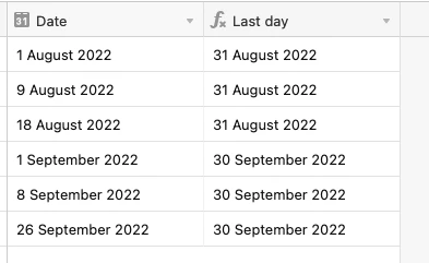

Hey @Erik_Peterson, this should do what you’re looking for I think:
DATEADD(
  DATEADD(
    DATETIME_PARSE(
      DATETIME_FORMAT(
        Date,
        "01 MM YYYY"
      "DD MM YYYY"
    1,
    'months'
  -1,
  'days'
DATEADD(
  DATEADD(
    DATETIME_PARSE(
      DATETIME_FORMAT(
        Date,
        "01 MM YYYY"
      "DD MM YYYY"
    1,
    'months'
  -1,
  'days'
  • Aug 25, 2022 9:40 AM UTC
One key thing to note here is to leave GMT turned on in the formatting preferences for the formula field.

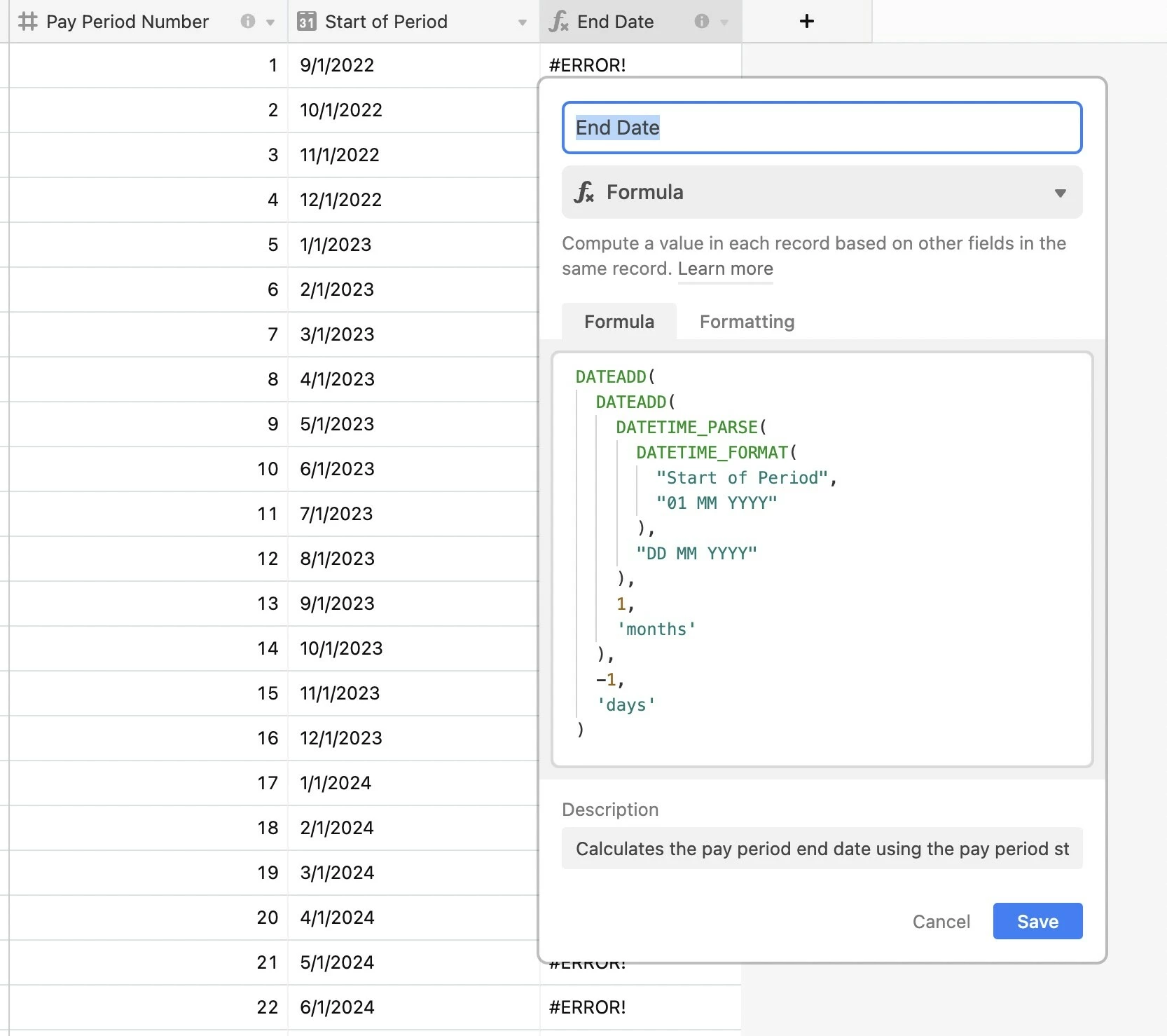

  • Aug 25, 2022 3:11 PM UTC
ok this awesome, but I’ve got something incorrect b/c I’m getting an error. I do see you were using a euro format date and I’m using a US based date format. Even when I swap the DD & MM in the formula it doesn’t seem to work. See attached screenshot.
  • Aug 25, 2022 3:48 PM UTC
“Start of Period” is a field name, so it needs to be in {curly brackets}.
That piece of information was missing from @Adam_TheTimeSavingCo’s formula above.
  • Aug 25, 2022 4:07 PM UTC
oh duh! Thanks so much!
