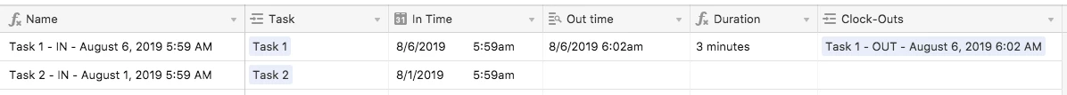

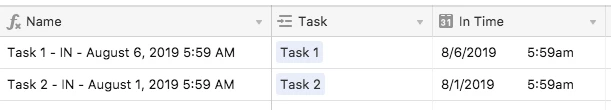

This may be possible to do in a single table, but it would likely be a fairly complex system to set up. With clock-ins and clock-outs in separate records in the same table, and no guarantee how many records separate the clock-in from the clock-out for a given task, it becomes extremely challenging to connect the two together.
One possible alternative is to use separate tables for clock-ins and clock-outs, each with a separate form for users. Each clock-in record would link to a task, and each clock-out record would need to link to a clock-in record, which could be made easier by creating a view in the [Clock-Ins] table to filter only records that have no link coming from [Clock-Outs], and target that view when users pick a record on the [Clock-Outs] form.
Here’s the [Clock-Ins] table in a test I made:
and the [Clock-Outs] table, which looks up the task from the linked clock-in record to build its name:
After linking the clock-out record to a clock-in record, the latter record can look up the out time and calculate the duration of the task.
