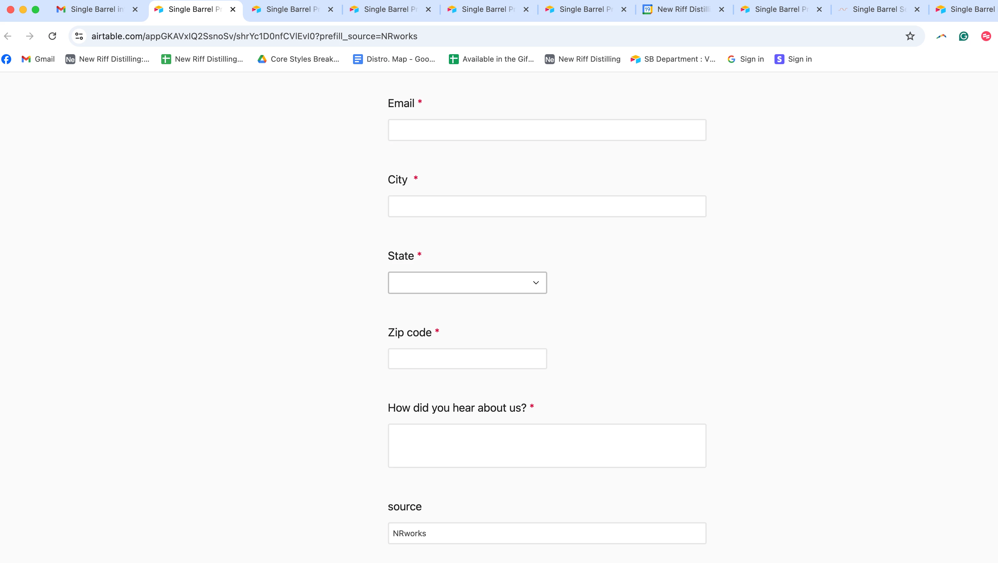

Can someone help? I am trying to prefill our customer intake form with the source so I know where the form was filled out (i.e. from our website, at an event, ect.). When I change the URL it is showing correctly in the form, but when I submit it to Airtbale the source field is empty. Am I missing something?

Hmm I just tested this out with a prefilled form link and it worked fine; the prefilled data showed up in the table
Is that field hidden by any chance?

I made it hidden with a condition, once a customer fills out the first required field I have it go away. I don't want it showing on the form as the customer doesn't know what the source means and I am trying to avoid confusion. Would that mess it up?
Yeah, hidden prefilled fields aren't submitted I'm afraid.  As a workaround, perhaps you could try hiding it via the URL params instead?
