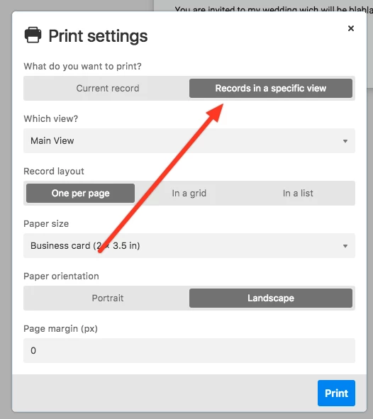

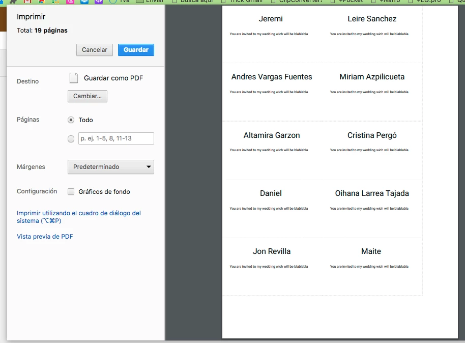

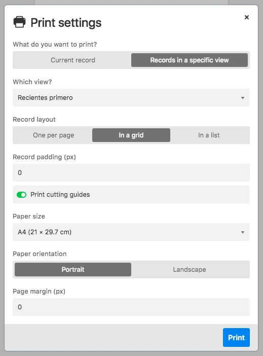

@Elias_Gomez_Sainz didn’t link to the info on the Page Designer Block, which is here:
https://support.airtable.com/hc/en-us/articles/115013405168-Page-designer-block
I’d say using the “business card” page size is your best bet, and as long as each record (row) has each piece of info that you need to be on the label, you can design the label once and then apply it to all records. And I’m pretty sure they have a “print all records” option too.
So the Page Designer Block really is the best tool for this in Airtable.

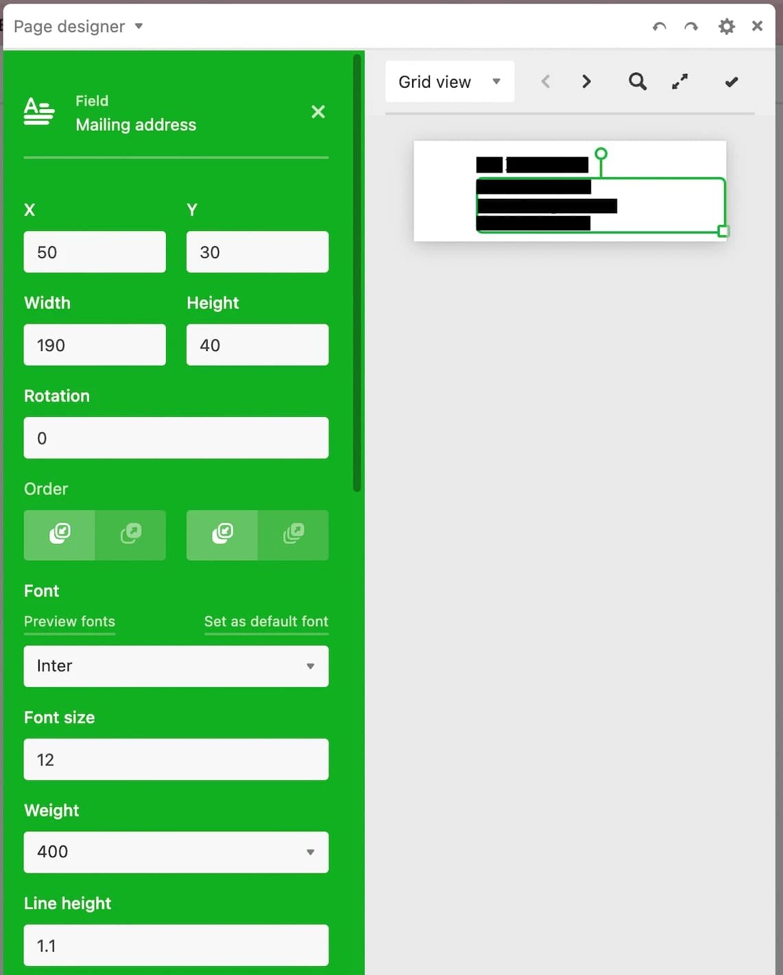

I was looking for the specs to print from Page Designer to Avery Label 5160 (30 per page), and couldn’t find in any chat room or airtable template. After 10 pages of test paper, I got some workable settings. They are not perfect; but thought they might help someone:
Print Settings for Avery Label 5160:
Record Size: 280 x 106
X/Y position: 20 / 20
Font: Inter 14, 1.4 line height
Print from Chrome: Grid, Record padding- 0, page margin 40

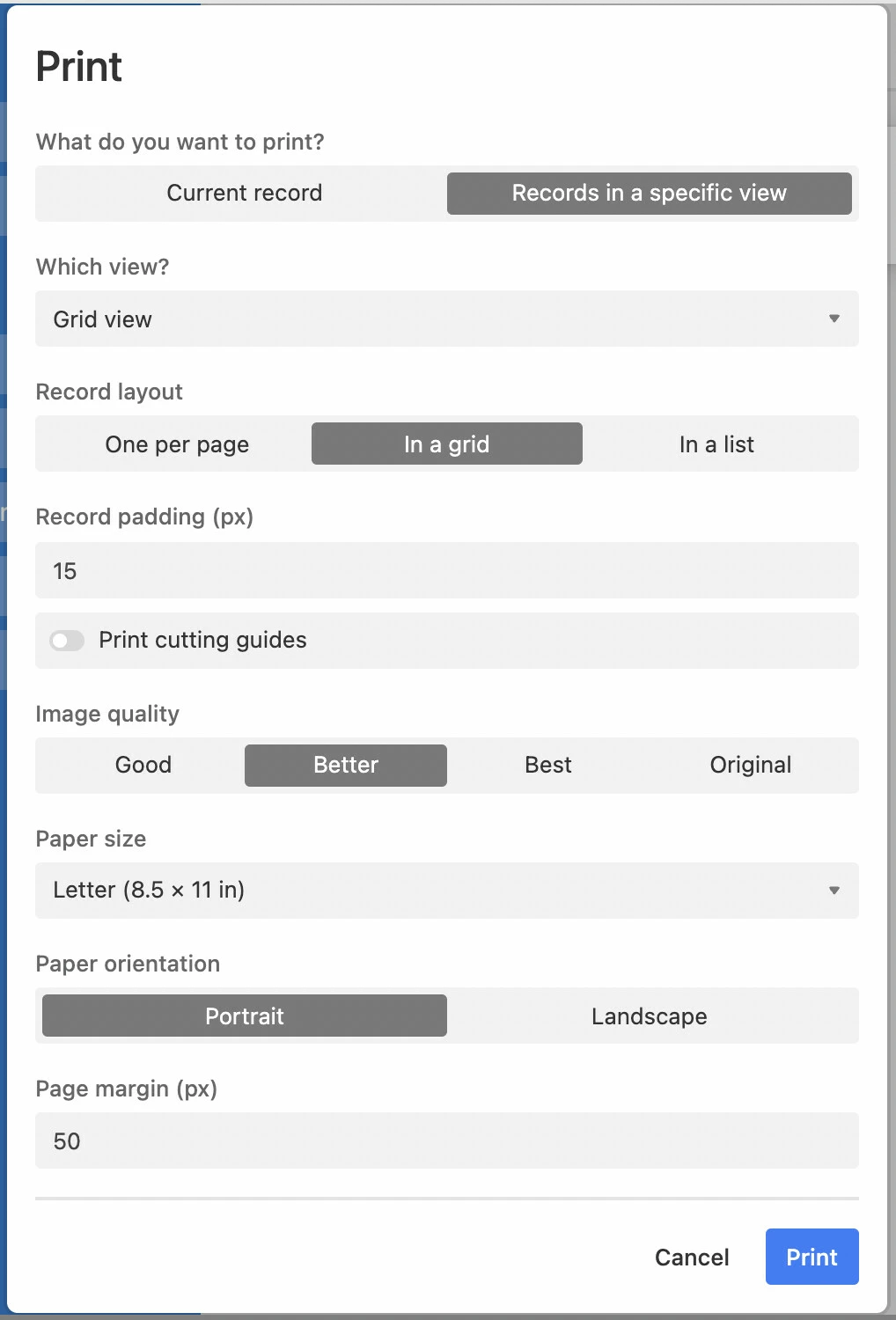

  • Sep 12, 2022 3:20 PM UTC

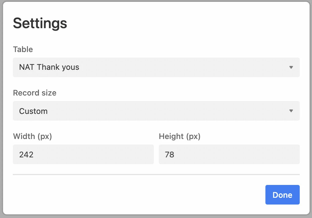

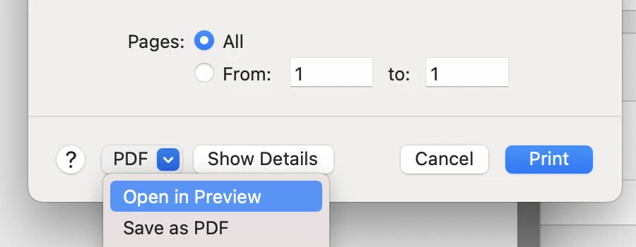

:clap: Yes! Super helpful Laura! Following your lead, here are the settings that worked for me on a slightly different Avery label layout:
Print Settings for Avery Label 6870 (also 30 labels/sheet, but shorter)
Record Size: 242 x 78
X/Y position: 50 / 10
Font: Source Serif Pro 12, 1.1 line height
Print from Chrome: Grid, Record padding 15px, page margin 50
(Note: it was very useful to print to PDF and preview the sheet as I adjusted my numbers)

I just played with this and came up with what I feel are the BEST settings for an Avery 5160:
  • 290 px by 110 px record size
  • fields placed at X50 Y50
  • fields = 13 font, 500 weight
  • Letter 8.5x11, Record Padding = 0, Page Margin = 40
