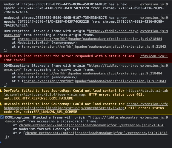

The error messages were about the same in all versions. Here’s what I got from the RapidWeaver version:
------>Begin error messages
[Error] Feature policy 'Fullscreen' check failed for iframe with origin 'https://airtable.com' and allow attribute ''.
	(anonymous function) (share-br.js:1:7196222)
	o (share-br.js:1:366)
	(anonymous function) (share-br.js:1:4063832)
	(anonymous function) (share-br.js:1:9326903)
	(anonymous function) (share-br.js:1:2545)
	Global Code (share-br.js:1:2557)
[Error] Failed to load resource: the server responded with a status of 403 () (jquery.min.map, line 0)
[Error] Failed to load resource: the server responded with a status of 404 (Not Found) (jsSourceMap, line 0)
[Error] Failed to load resource: the server responded with a status of 404 (Not Found) (favicon.ico, line 0)
------>End error messages
They come across better in the web inspector for anyone who wants to look. Although it implies that jQuery didn’t load, I see it listed under Scripts in the Web Inspector.

I just checked out the link you posted for RapidWeaver in Chrome (on a Mac using Big Sur) and I only get one (favicon related) error—which leads me to think this is probably a Safari-specific problem.
The text editor version has no errors on my side as well.
I know Safari is kinda finicky at times, its probably related to some internal Safari asynchronous problem of loading jQuery out of order. If it looks good, and works on both browsers, then I think you should be good to go and shouldn’t worry about the errors.

Very good to know that you didn’t get most of the error messages I did. You’re probably right that they are a Safari issue; I should have thought to test that. Thanks!
