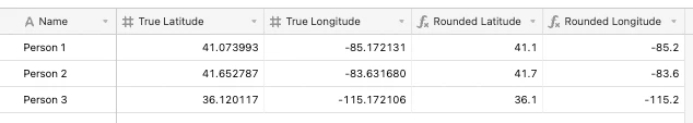

How random do you need it to be? You could do a simple rounding of the Lat/Lon numbers to generalize. For example, rounding them down to one decimal place will reduce the accuracy to 100 sq km. In that case, you could simply do this:
Formulas in this are:
Rounded Latitude:  ROUND({True Latitude}, 1)
Rounded Longitude:
ROUND({True Longitude}, 1)
Since Airtable doesn't have a random number generator, you could also convert the Ruby script to JavaScript and use the scripting extension to truly randomize it. Using a convertor, it looks like that JavaScript would be something like:
