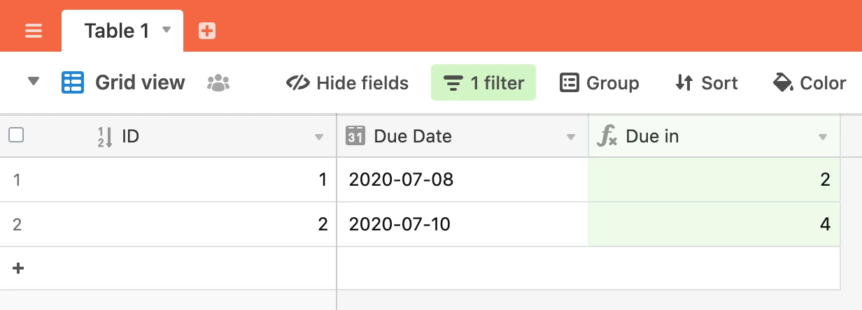

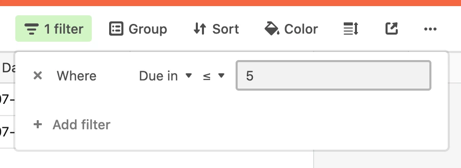

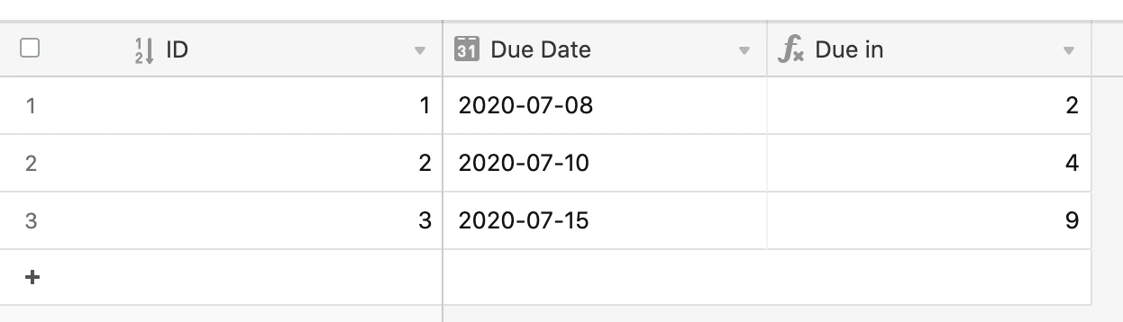

Hi @Alison_Roadburg - this is my table:
Then I can create a filter like this:
Resulting in this:
