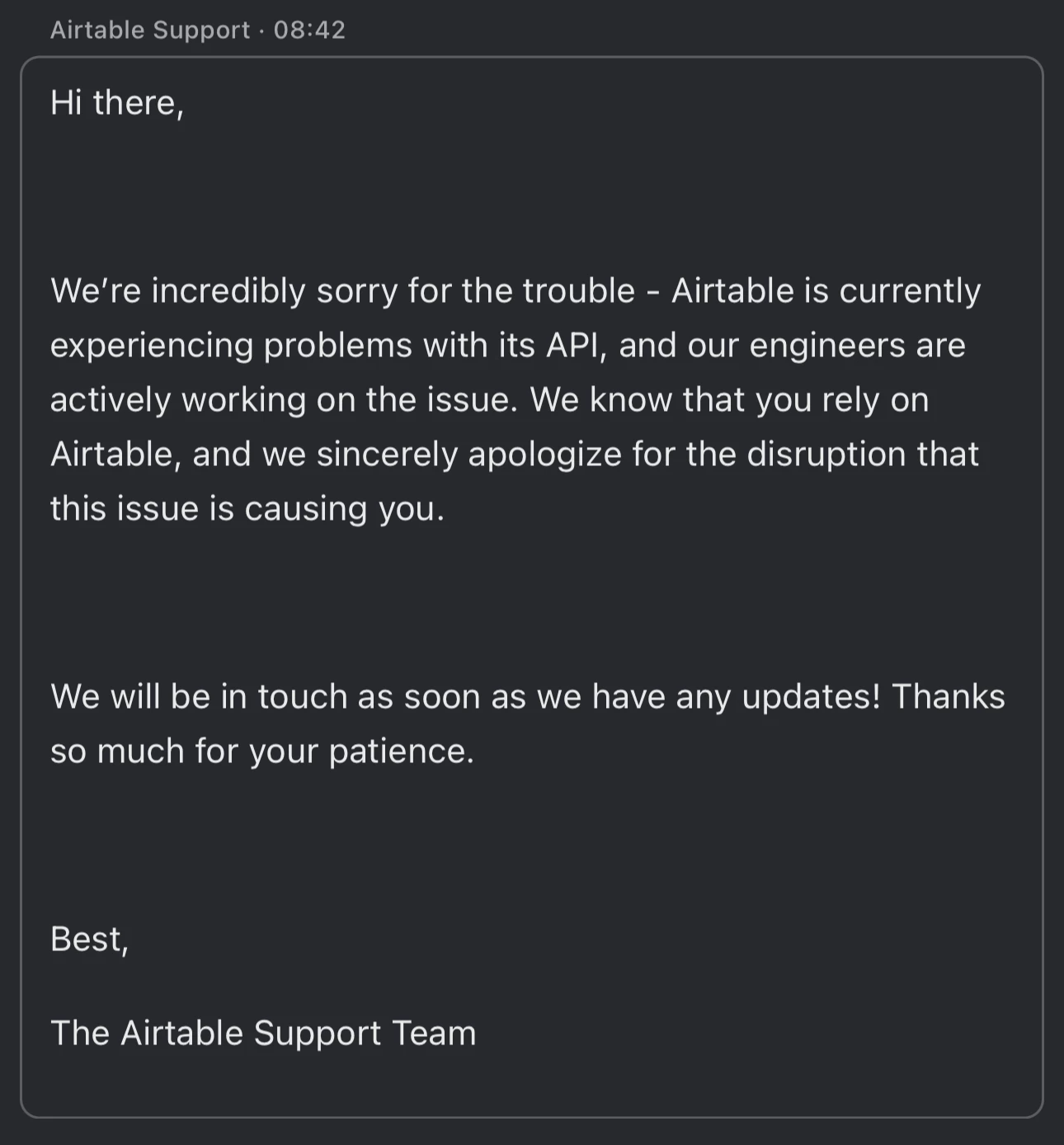

  • September 14, 2023
Definitely is linked to a recent update on the Airtable side. The reply I got was super vague though, and this has brought several of our bases to a screeching halt.
