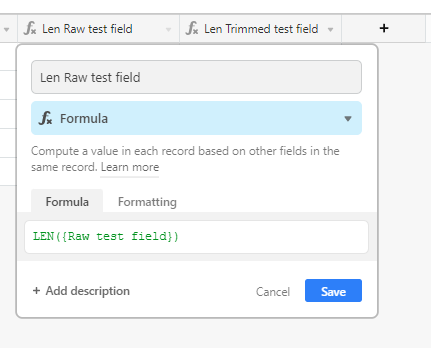

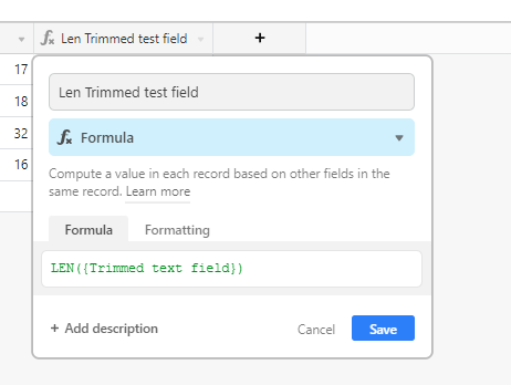

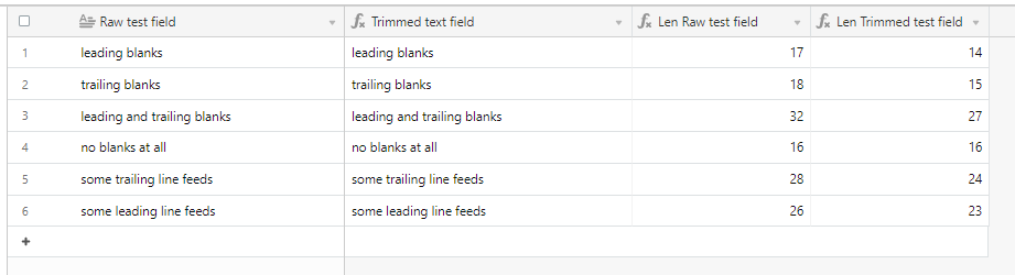

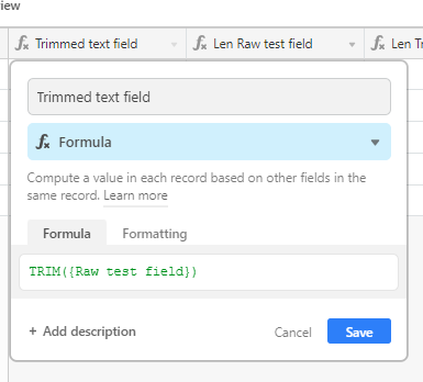

Hi Kim,
I agree with Databaser, the TRIM() function should do the work to remove leading and trailing blanks
I did a test just to ensure about that, same as Databaser. Check the screenshot of the table and the formulas.
I was thinking about your text containing “non white spaces” that look like “whitespaces” but TRIM() should also pick them up, see my example where the Raw test field is a long text.
Hopefully this helps, good luck
