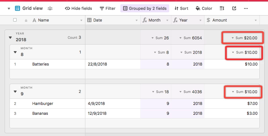

You could also use Grouping, easy and flexible. Moreover, you have Yearly sums.

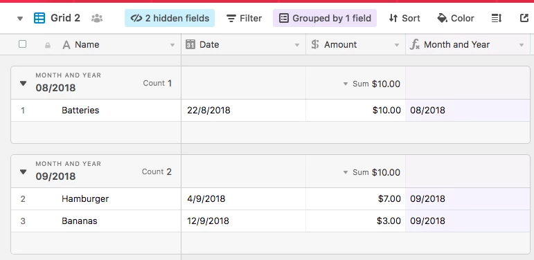

You could do the same but combined, as you described:

I had shelved AirTable for a few months because I couldn’t get it working and then life got busy. Just came back to this, and you’re right. I can just do this as a new view with grouping. No need to create a new table with that data as it’s already there!
That’s awesome and I’ve achieved the desired result now.
