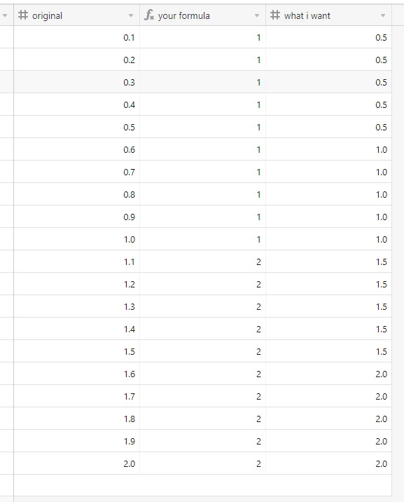

thanks for your help and perhaps you can have a look at this again , for me
below is what your formula gives me and i have inserted a manual column of what i hope to get . can you have a look at this again please
  • Feb 10, 2021 3:58 PM UTC
Check the formatting tab in the formula field to make sure it is set to decimal with the correct number of places.
