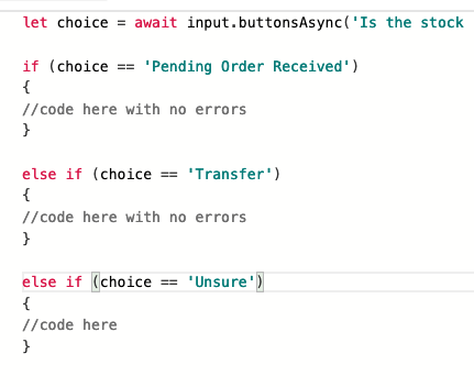

My code is really long so I'm not posting the whole thing, but here's the gist:
let choice = await input.buttonsAsync('Is the stock received from a pending order, transfer or unsure?', ['Pending Order Received', 'Transfer', 'Unsure']); if (choice == 'Pending Order Received') { //code here with no errors } else if (choice == 'Transfer') { //code here with no errors } else if (choice == 'Unsure') { //code here }

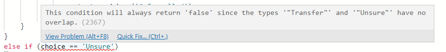

I'm getting this error with the last if statement for 'Unsure' and I don't know how to fix it:
Best answer by Grunty
I think you missed a { between each 'else' and 'if', and the corresponding }} to close them at the end.
Did I hit it?

Weird, there's no error when I paste your code into a script extension
Did I hit it?

Hey @Sarah_Viljoen!
Huh... no idea what's causing intellisense to flag that.
Similar to @TheTimeSavingCo, I pasted in your script and intellisense didn't flag it for me. Nevertheless, just because intellisense flags a potential issue doesn't mean that your script will actually fail to run or throw an exception.
You can test it by simply tossing in a console.log() into your code block for the else...if condition in question and confirm that it actually runs as intended.
There are many things that you'll commonly do when scripting in Airtable that intellisense isn't a fan of.
In any other IDE, we'd be able to just flag that it should be ignored. Unfortunately, Airtable's built-in code editor doesn't allow us to do that.
