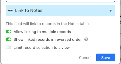

Hi @Katelyn_Hill – I think there are a couple ways you could handle this, but it is definitely possible to limit linked records to a single, one-to-one, or one-to-many relationship.
In the options for your linked record field, where you are linking Students to to Jobs, just switch off “Allow linking to multiple records”:

I think I understand, and if I do, then this is what my proposal solves. You only want to switch this multiple links option off on the Student side of the linked record relationship (the field that establishes this link in the Student table). On the Job side of the relationship, you can leave the multiple links option on, so that you can still link multiple students to one job.
Does that make sense?
If that still doesn’t do what you are wanting, we can explore other options.

Ah, I see — you are choosing Students to link from the Jobs table, not the other way around.
Ya, that’s an annoying little bug in Airtable.
So next step is to do this:
  • Create a new View in your Students table, and filter this view with the filter menu at the top such that it only shows Students where the Job field is Empty
  • In the options for the Linked record field in the Jobs table, where you are selecting Students for jobs, select “Limit options to a particular view”, and select this new View that you just created
I think that will get you at least closer to what you are wanting.
