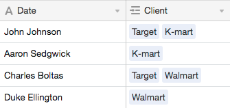

To do this, I suggest making a [Clients] table, and adding a record for each client. Here’s a quick dummy example (primary field only):
Back in your [Masterlist] table, add a {Client} field (Link type), and link to the appropriate client(s) from the [Clients] table.

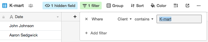

Once all the links are added, add a new grid view to [Masterlist], and name it for your first client. Add a filter that targets the same client, then hide the {Client} field, so that it looks like this:
With the {Client} field hidden, you can share this view with your contact at K-mart, and they’ll only see the lines you tagged for them to see, without knowing anything about any other clients.
