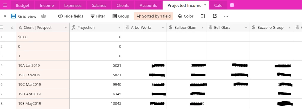

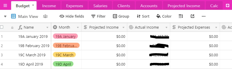

I have a Budget table with records representing each month. One of the fields is “Projected Income”. For each cell in that field, I am seeking to show the corresponding month’s Projected Income from another Table called “Projected Income”.
In the Projected Income Table, I have configured it so I have records representing the month, and currency fields representing the client monthly payment. (I have also configured it so I have records representing the client & fields representing the month - I’ll remove the records/fields I don’t need.) So, I am looking to insert the totals of the projected client payments for each specific month into the Budget table’s record cell for that month in the “projected Income” field. I also have a “Projection” formula in the “Projected Income” table that sums the values of those fields, so in effect that monthly projection is represented in the Projection formula. If that Projection formula could just show up in the Budget table, I’d be set!

Actually I see that I just need to configure the target table differently and do a rollup against the field with SUM(values) as an aggregation function.
Instead of various fields representing the months, each with their own currency, I have one field with the amount being received, then a field with the client, and a field with the month, which pulls from the budget table. Now the projections are showing up properly in the budget table.
  • Jun 1, 2019 11:37 PM UTC
