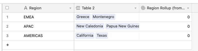

This is very helpful! Thank you! - I cant seem to make the rollup file type work though. I must be doing something wrong.

Are you getting an error? can you post a screenshot of what you have thusfar?

Hi Kamille,
All I get is 0.

Is your Count field in Table 2 working properly? The {Region Rollup} field should be doing SUM(values) for the Count field, so if the Count fields are showing values greater than 0 this is an issue.

I figure it out - thank you for your help!
