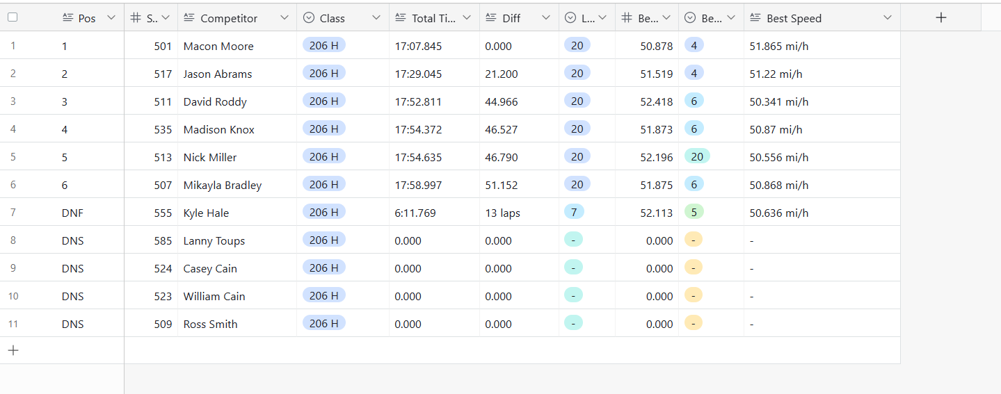

Hello, hope you are all doing well.
Need some help giving points to each participant per race result, would like to create a field on the same table with a formula that does that automatically.
The point system is basically the reverse order of the number of participants, ea: 1st place gets the total number of participants in points, the 2nd place gets one less, and so on, with last place getting 1 point
Here is the condition, only the "Pos" with numbers will get assign the points. Positions that have a DNF or DNS will get just 1 point
Here is the table:
Any help will be grateful, my brain is toast for the night, trying all kinds of ways.
This might be super simple for someone out there 😆
Thank you!

Is it correct that number of participants 11 here? And Pos1 gets 11 pts, Pos2=10 pts, Pos#6 gets 6 points, the rest (Pos 7-11) are 1 pts.
Your formula will be
1+IF(VALUE(Pos),11-VALUE(Pos))
if you have different total number each race, to count total, you need to link and do the stuff according to @TheTimeSavingCo  instructions

Thank you guys, will get working on this  😀. @Alexey_Gusev already applied that formula, thank you man. @TheTimeSavingCo  will work on those tables tonight. Thank you all again
