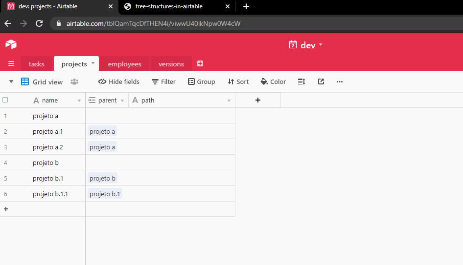

You could create a single table for all the vertices of your site. In that table create a parent field so each record could point to its up level. Then create a path field to hold the whole item hierarchy. This will allow you to filter and order the items using the path field.
The only way I found to fill out that path field was through Airtable API with a script. The gif below is an example of a multi-level project tree.
If you found that promising, I wrote a post detailing that API approach and also open-sourced and provided free access to a hobby app to do that.
