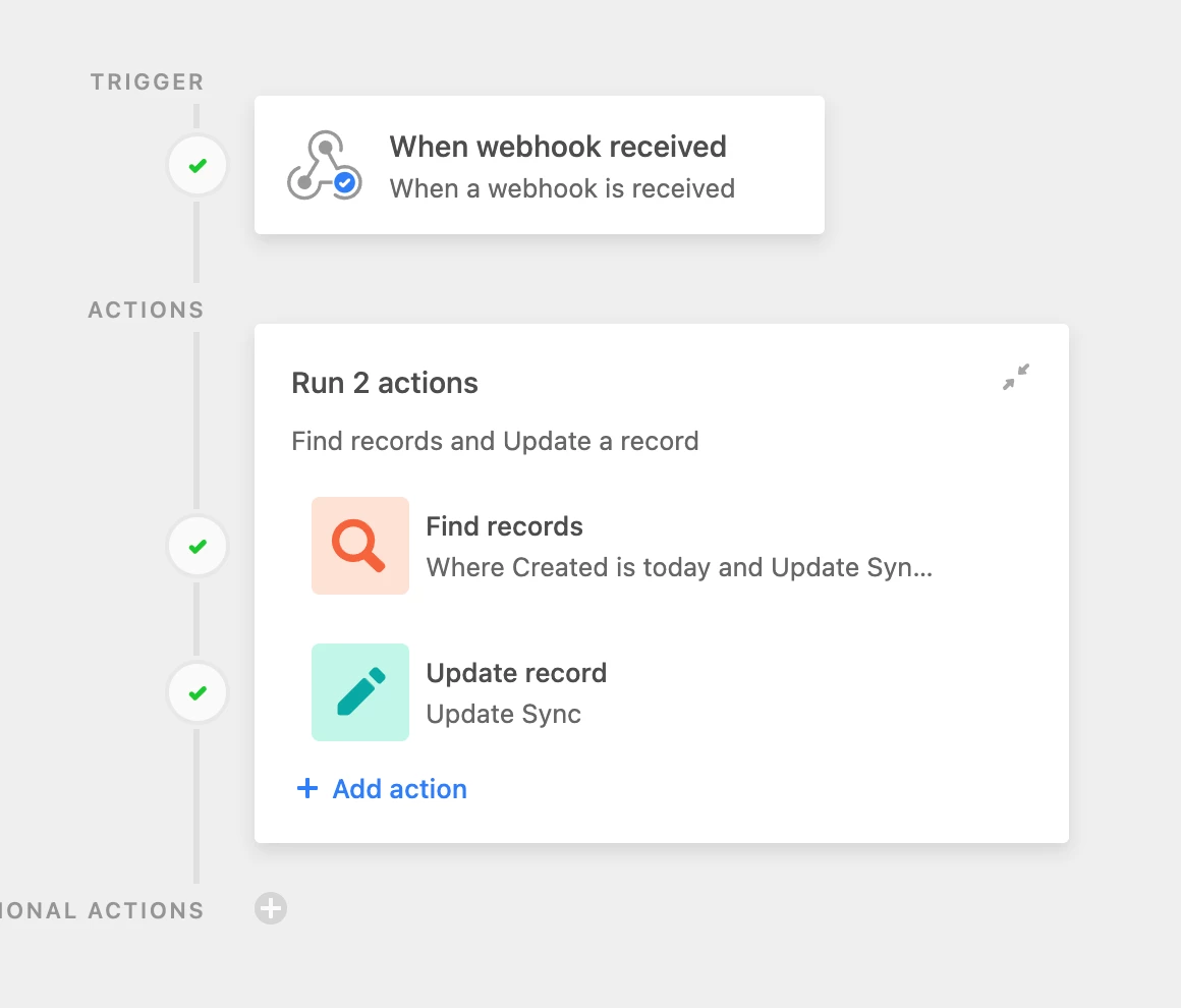

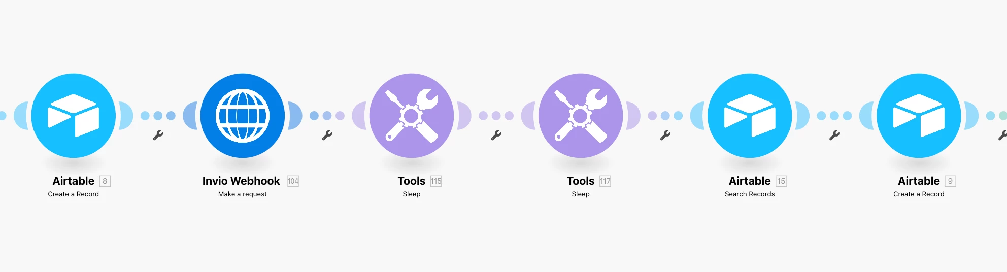

Hi! Thank you very much for your precious intervention. I have a further question, thee is a precise synchronization time following the "Source Base" update?
My process is this:
- When the event occurs I send a webhook via Make
- The webhook triggers an automation inside the Source Base on Airtable (this automation looks up the last created record and updates a field by setting a checked field)
The problem is the time between this update on the "Source Base" and the synchronization on the "Sync Base"
I realized that up to 9 minutes pass and for this I had to insert 2 "Sleep" modules set to 300 seconds (screenshot attached) each on Make before looking for the new (synchronized) record on the "Sync Base".
Can you confirm that the process described is correct? I had read that the ""Sync Base" synchronization takes place within 5 minutes following the "Source Base" update.
Can you give me some information about it? Thank you very much and Happy New Year!
