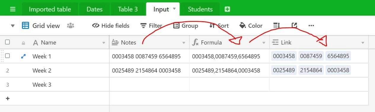

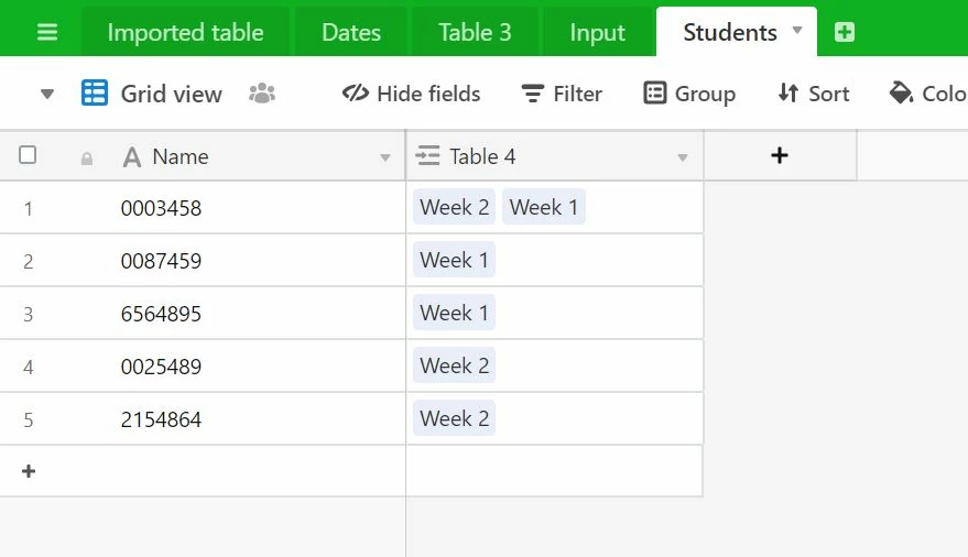

Create a formula field which separates your student numbers by commas: SUBSTITUTE({Whatever field your student numbers are in},' ',',')
Then make a Link to Another Record field linking to the separate table. Copy and paste the Formula Field entries into the Link Field. (you can copy the whole column at once, a select few records, or one at a time)
Your result will look something like this:
Thanks @Kamille_Parks, I didn’t even think/know about the substitute formula. It didn’t work initially, however I realised by student numbers were separated by a line break not a blank space. As found on this form I used the following: SUBSTITUTE({Whatever field your student numbers are in},’\n’,’,’) and it worked perfectly.
Going to implement a zap to copy paste from the formula field to the linked students table.
Thanks again!
