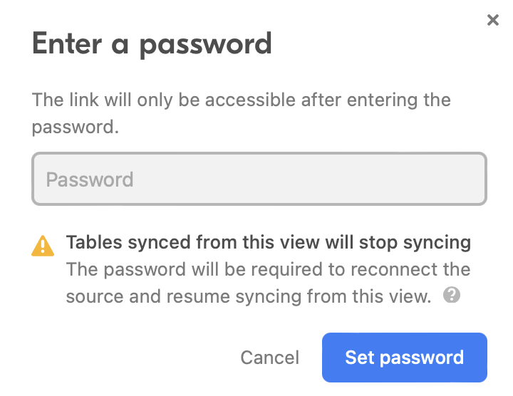

But if you add a password to the source view after you’ve setup the sync, it gives you the warning in the screenshot below to let you know that you need to update your destination sync table.
However, you don’t need to remove the sync and recreate it from scratch in the destination table. You just have to choose “reconnect” in the “update sync configuration” screen, and it will prompt you for the password on the next screen.
