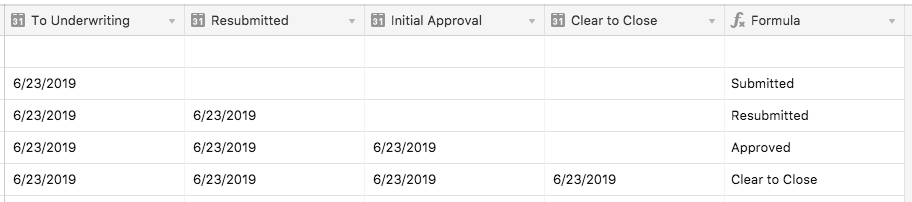

I am trying to get a singular text result depending on what date fields have been entered. I can get each one to work separately with the IF(AND statement but I can’t get all three to work as one formula?
Here are the three formulas I have so far:
IF(AND({To Underwriting},{Resubmitted}),“Resubmitted”,“Submitted”)
IF(AND({To Underwriting},{Initial Approval}),“Approved”)
IF(AND({To Underwriting},{Clear to Close}),“Clear to Close”)
Thank you in advance!
Because {To Underwriting} is common among all three formulas, you can start by checking for that, then check for the others in turn.
    {To Underwriting},
        {Clear to Close},
        "Clear to Close",
            {Initial Approval},
            "Approved",
                {Resubmitted},
                "Resubmitted",
                "Submitted"

Thanks Justin…greatly appreciate the help!
