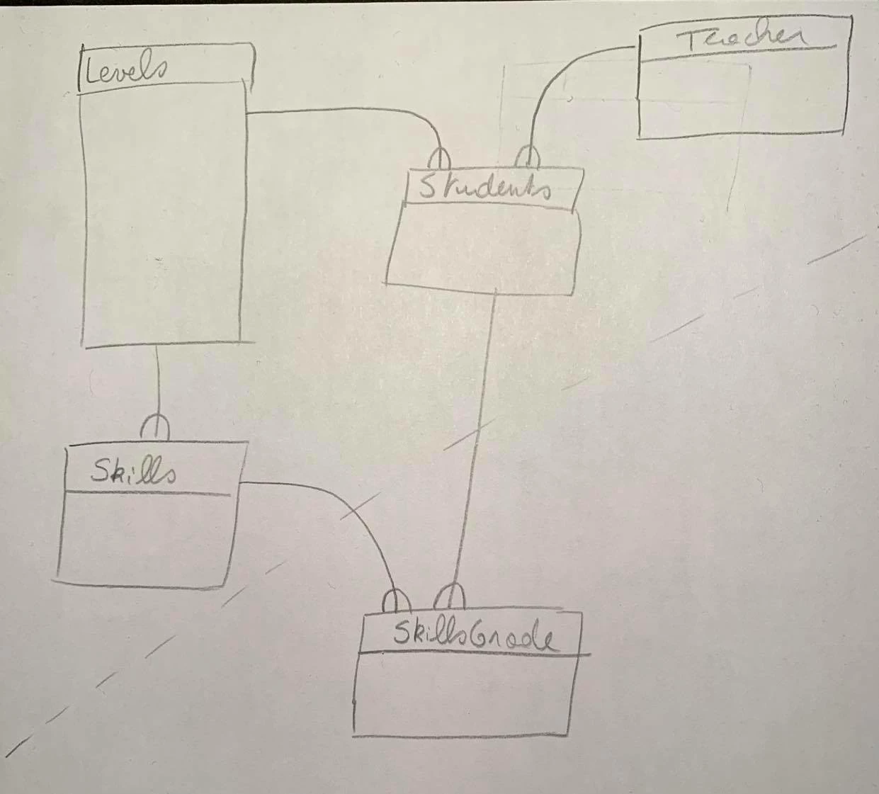

Hello Susan !
I guess you are not familiar with ERD Design but, let’s present it in a few words.
It’s a way to represent the different entities (and relations between them) that we need to interact with.
Here is the ERD Design for your project, please tell me if you need further explanation on this.
The “top” part is what you explicitly explained. The “bottom” part (under dashed line) is what you try to achieve in point a).
The [Skills] table will keep the different skills required to achieve a level.
The [SkillsGrade] table will hold all the progress of students. Each grade will be linked to one skill and to one student.
Point B) is possible too, with Airtable Automation or using external tools. (Integromat or Zapier)
Point C) is the same as point B, you need an automation tool to achieve this, either the Airtable Automation tool or external ones. Yes it’s possible to make it pretty, you can send template e-mails using dedicated tools (like Sendgrid).
Anyway, I would suggest you to design the Airtable Base first, see if you can get all the information you need and then automate it.
Do not hesitate to reply in this topic if you need more help regarding Base Set-up or Automation.
