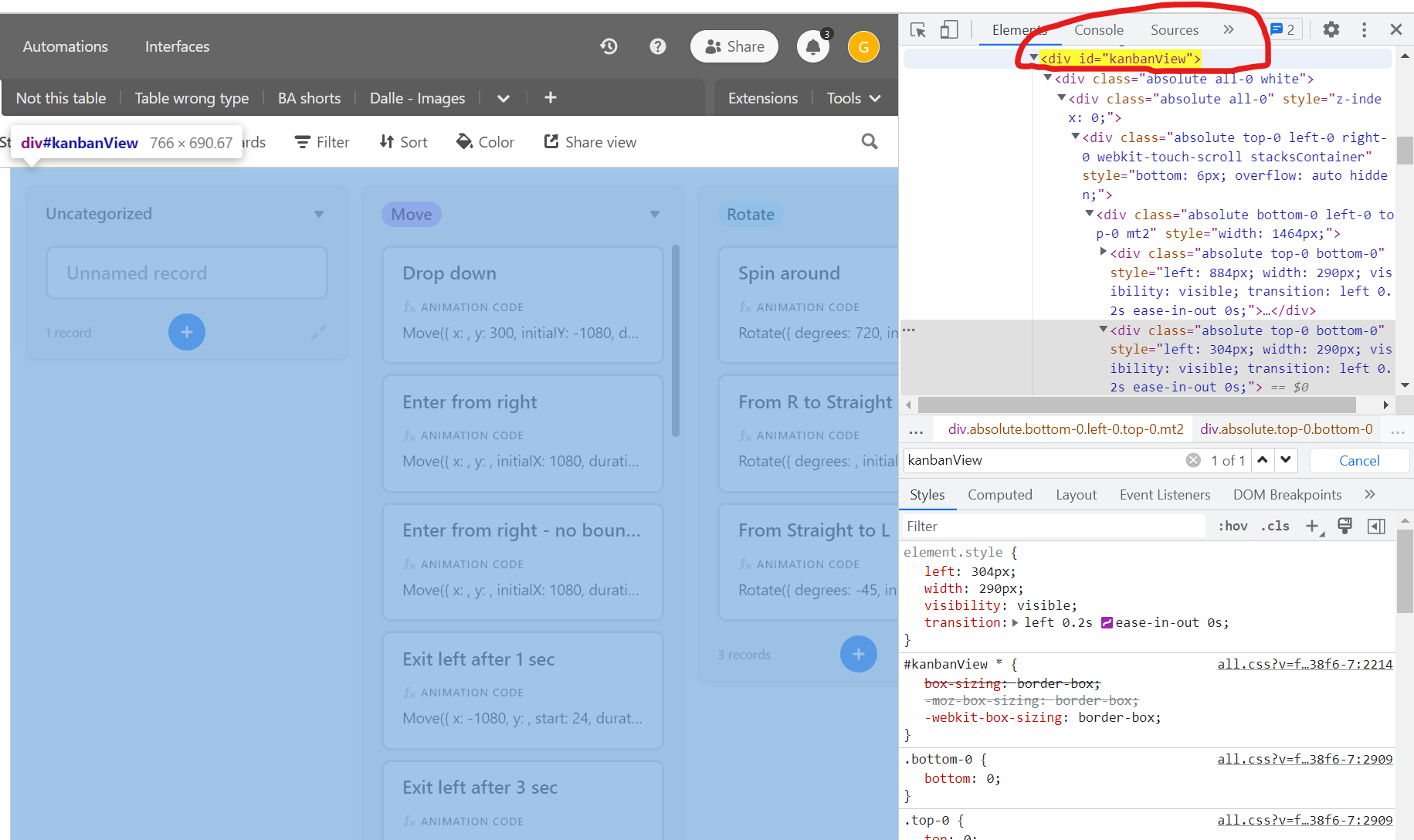

# means id in html, you can see in the screenshot below
> div.white  means a child div with  CSS class "white"
So basically this #kanbanView > div.white  is describing the targeted element which style will change
{ background-color: aliceblue !important; } sets element above to contain style of background color "aliceblue"

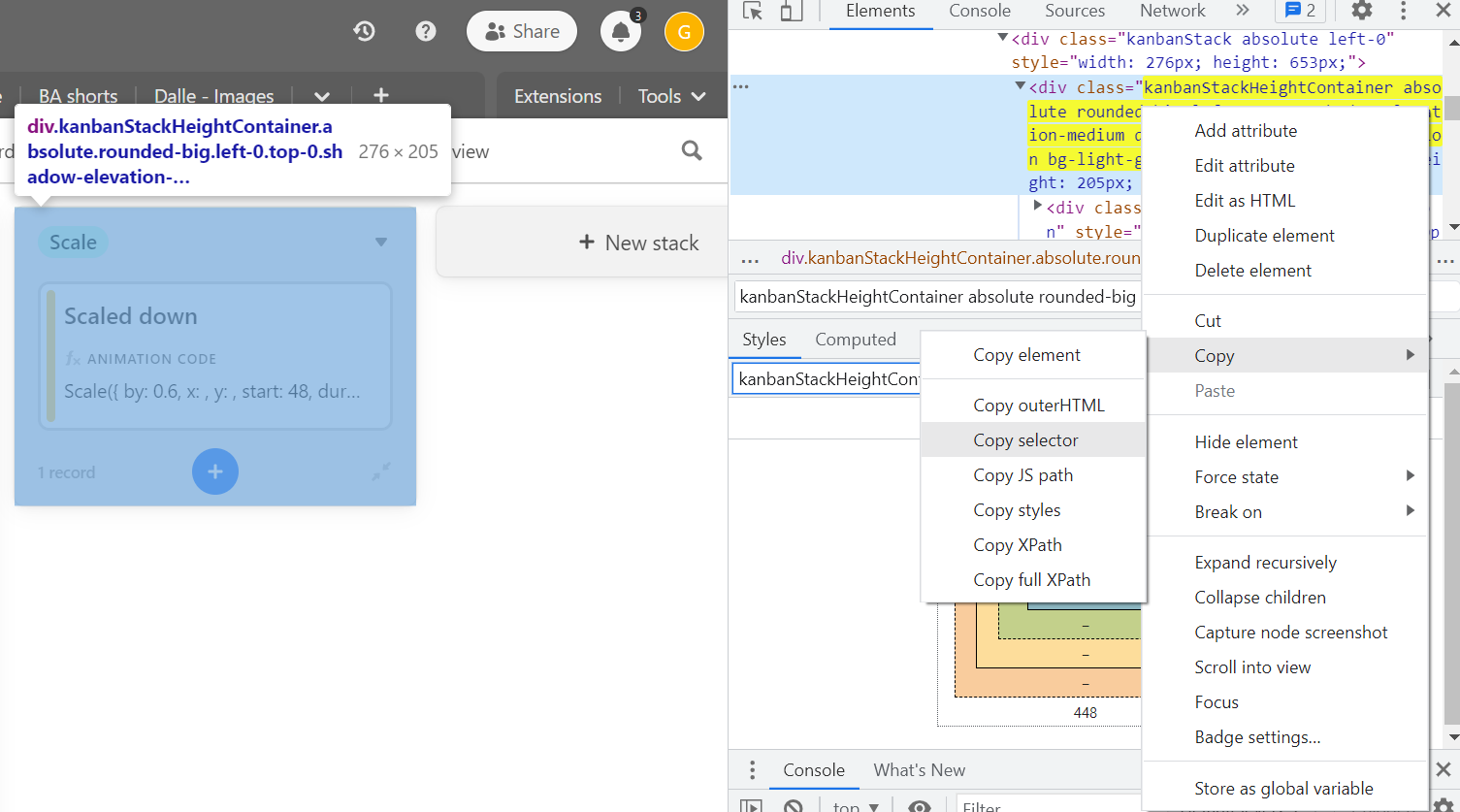

As for finding the div  of stack?  I  guess best  would be to use the Inspector find the div with arrow tool and then copy the selector:
This will give you something like this : #kanbanView > div > div > div > div > div:nth-child(1) > div > div 🙄 there might be some more nicer/more stable way of getting the selector, but you would have to experiment a bit.

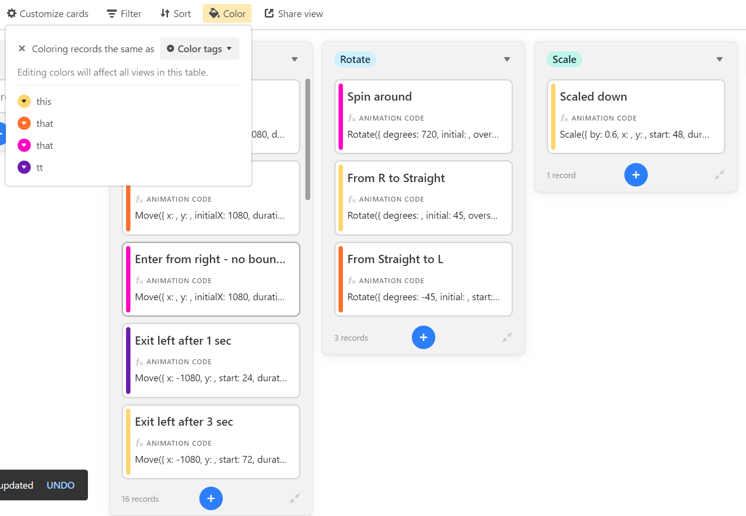

As for changing color of task probably it would be  easier to  just use  Airtable tags  like this:
Let me know if this helps!
