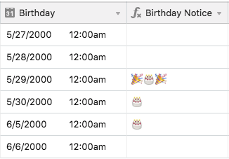

Alright - hereโ€™s what I came up with:

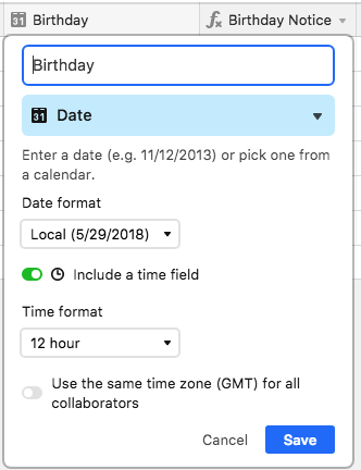

First of all, Airtable has some strange quirks under the hood when it comes to dates, times, and timezone recognition. For that reason, in order to make this work, youโ€™ll need to enable the โ€œTimeโ€ portion of your โ€œBirthdayโ€ field:
Itโ€™s unfortunate, but youโ€™ll see that if you switch that off, the dates in the calculation are thrown off by 1 day, even though I am using timezone conversion in the equation (perhaps I can figure out how to avoid this at a later time, but for now, the easy work-around is just to enable the โ€œTimeโ€ portion, and set it to 12:00am as a standard).
And then here is your formula for the Notification:

This will show :birthday: when it is the week of a personโ€™s birthday (within 7 days, inclusive), and will show :tada: :birthday: :tada: on the day of their birthday.

You. Are. AMAZINGโ€ฆIt works!!!
Thank you :slightly_smiling_face:
EDIT:
@Jeremy_Oglesby actually it works when it actually is someoneโ€™s birthday, but for the days leading up to the personโ€™s birthday it doesnโ€™t work :confused:
EDIT
The code works!!! :slightly_smiling_face:

Odd partial-day time shifts are almost always caused by not having all of your date fields set to use (or not to use) UMT similarly. Take a look at this reply on UMT (aka GMT) issues in calculated datetimes. If yours is a problem that canโ€™t be fixed simply by ensuring all date fields use (or donโ€™t use) UMT, see the second item in this reply on easily restating your local time in terms of UMT.
Your first link held the magic that fixed the problem. I replaced the portions of the formula above that calculated the birthday for the current year with your version, and everything works perfectly. The time option for the Birthday field is no longer necessary, which is an added bonus. Hereโ€™s the modified formula:

Itโ€™s literally just wrapping a single IF() function around the longer formula I wrote above. Assuming the birthday date field in your base is named Birthday, it should work. Just for completeness, though, hereโ€™s the whole shebang:
IF(Birthday,
        IS_SAME(
            DATETIME_PARSE(
                DATETIME_FORMAT(
                    Birthday,
                    'MMMM D'
                YEAR(
                    TODAY()
                'MMMM D YYYY'
            TODAY()
        "๐ŸŽ‰ ๐ŸŽ‚ ๐ŸŽ‰",
            ABS(DATETIME_DIFF(
                DATETIME_PARSE(
                    DATETIME_FORMAT(
                        Birthday,
                        'MMMM D'
                    YEAR(
                        TODAY()
                    'MMMM D YYYY'
                TODAY(),
                'days'
            )) < 8,
            "๐ŸŽ‚"
Thank you so much! Iโ€™m so happy with this. You make my day :slightly_smiling_face: :slightly_smiling_face:
