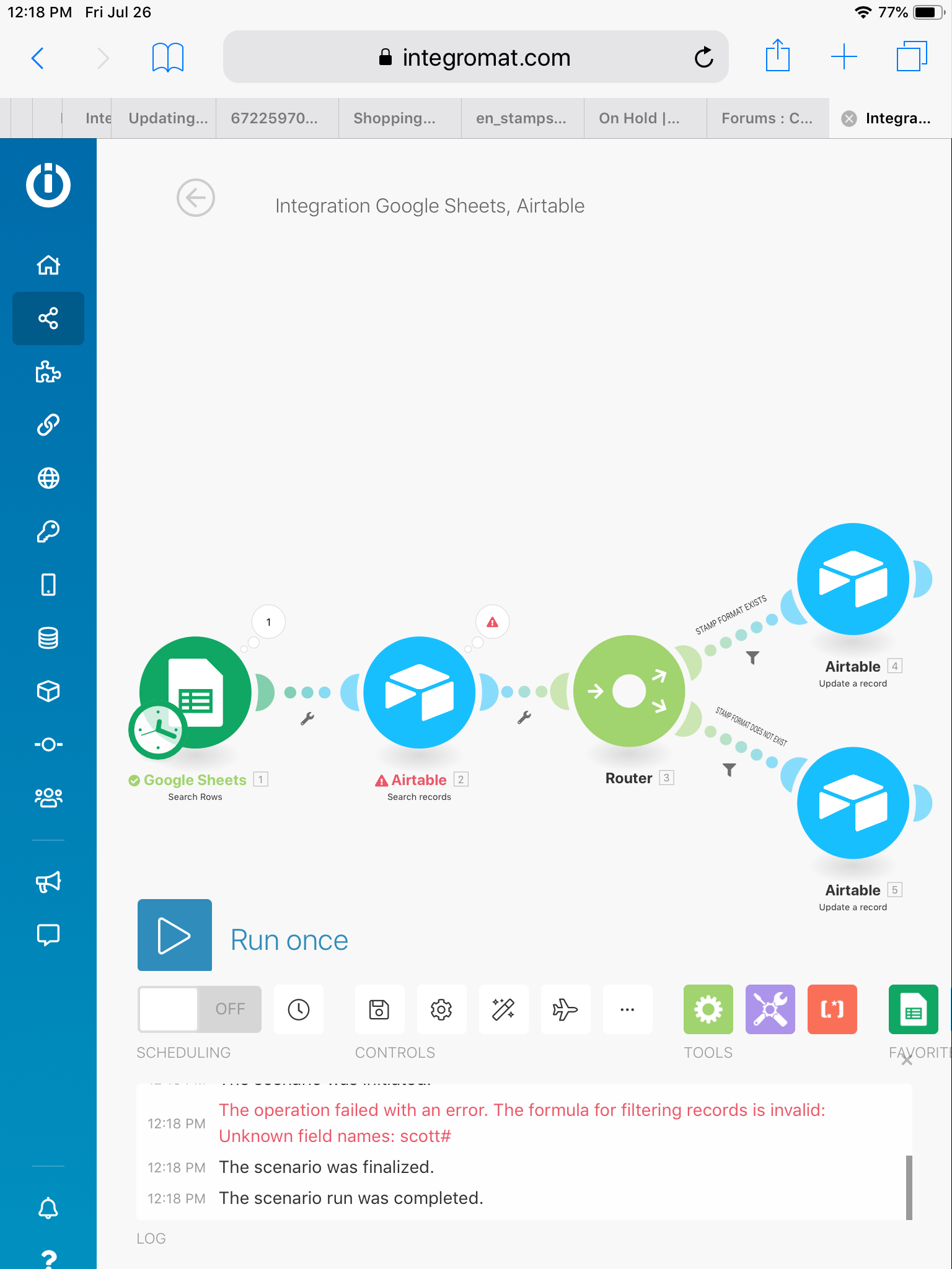

I am trying to update Airtable records using Integromat.
I am getting an error:
“The operation failed with an error. Insufficient permissions to create new select options”
I have found out that it has to do with my multi-select option fields in Airtable (when I remove those options the record gets updated.)
I would like to know if there is a workaround or some other solution, so that I don’t have to go back into the Airtable records and manually select all the options. I have over 200 records. I don’t want to have to do this for each record, that defeats the purpose of using an automation app.
Is there a solution?

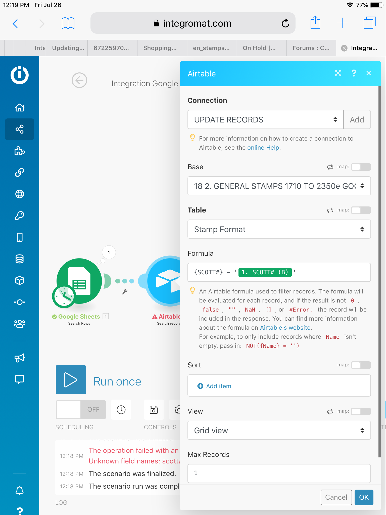

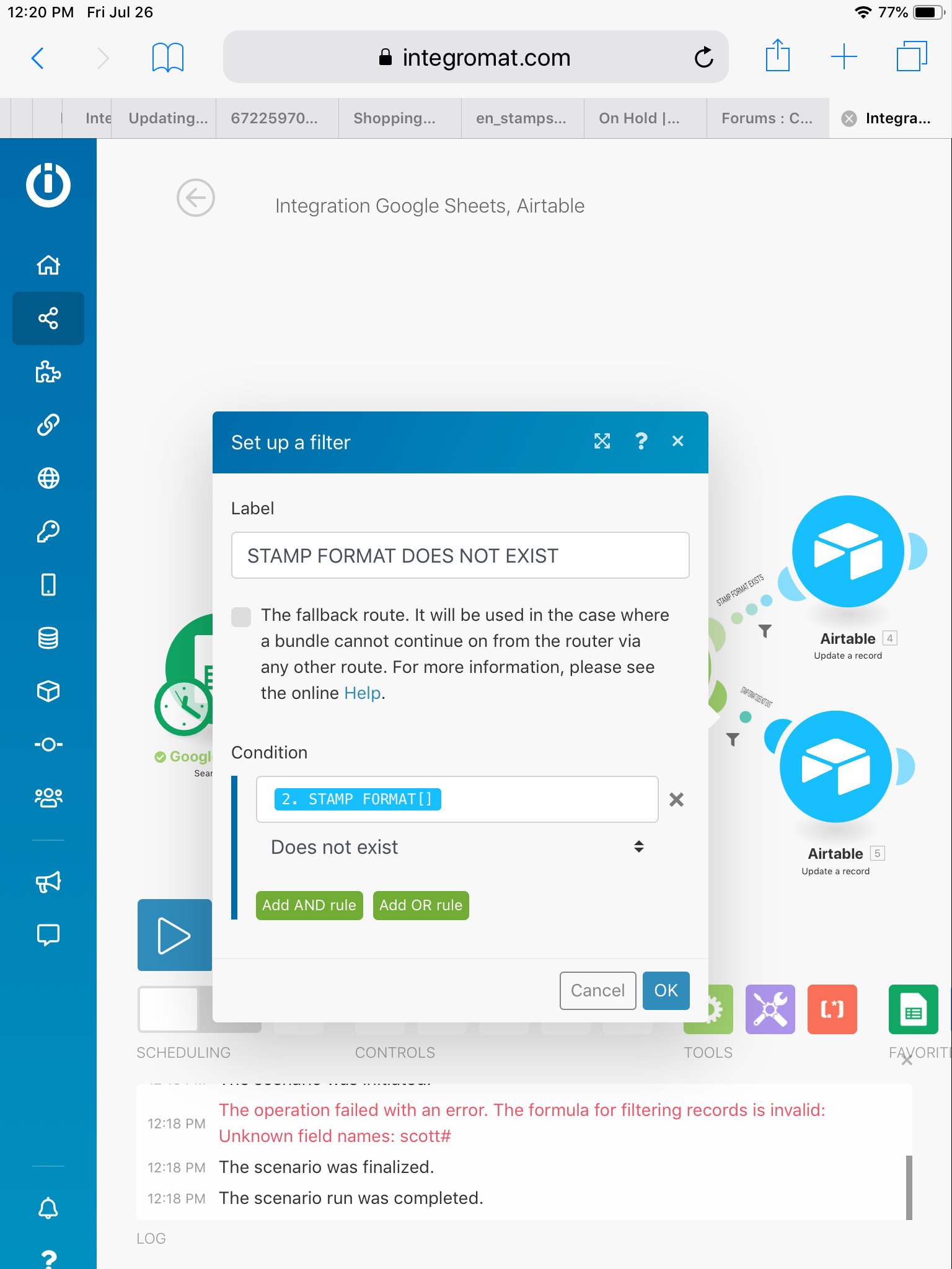

I think your formula in the Airtable module is incorrect. I see a minus sign where there should be an equals sign. You’re trying to look in the {SCOTT#} field for a value that matches what’s coming from the sheet, correct?
Forum|alt.badge.img+20
  • Jul 26, 2019 8:10 PM UTC

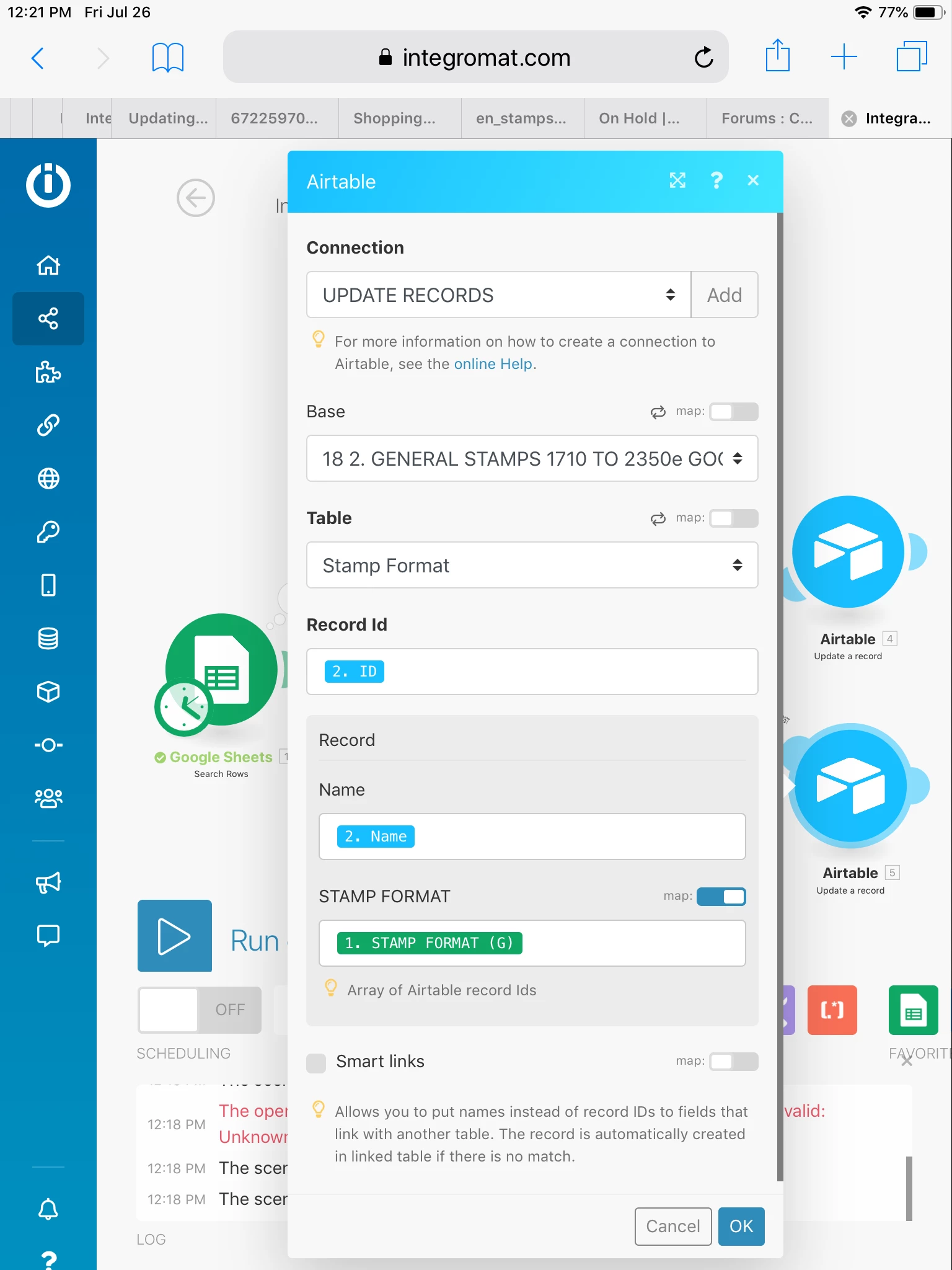

Hi @Justin_Barrett
I made the change, but I have different fields in the last two Airtable modules, maybe that’s why I am still getting the same error?
Did I setup the Airtable tables correctly?
Mary
Hi @Justin_Barrett
Mary

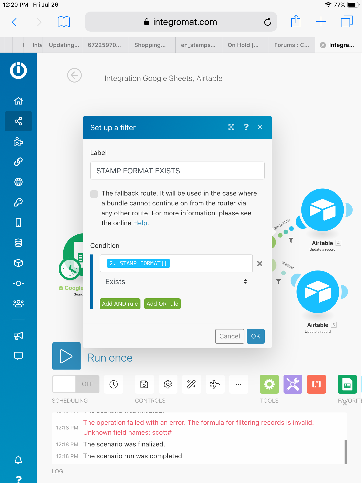

The tables look good from what I can see, and the later steps updating different fields wouldn’t have any bearing on why that first step is failing. Perhaps it’s because of the “#” in the Airtable field name? You might try removing it—perhaps rename the field to {SCOTT NUM}, then change the Integromat scenario accordingly and see if it still throws an error.
  • Jul 26, 2019 8:21 PM UTC
Hi @Justin_Barrett
So, even though, there are different field names (no SCOTT field name) in the the last two Airtable modules, in the scenario, that should not matter?
Mary
Hi @Justin_Barrett
Mary
Not at all. The earlier Airtable module is performing a search using that SCOTT field. The later steps are simply updating an existing record, or adding a new record, based on the results of that search. The search either returns an existing record where that filter formula matches, or it returns nothing, and your router and subsequent filters take the appropriate action based on that result. The SCOTT field is only used to filter the search, nothing more.
  • Jul 26, 2019 8:26 PM UTC

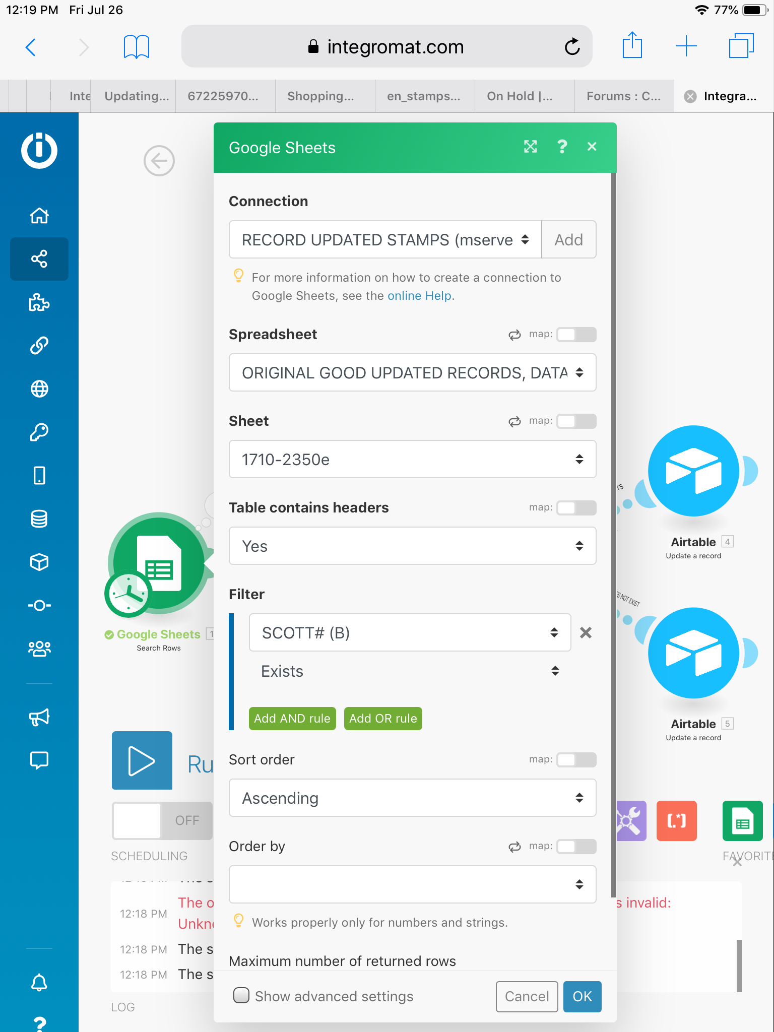

I managed to figure out why the scenario wasn’t working, I just added the SCOTT# field (it’s multi-serving) in the Airtable module to map and since it was also in the Google Sheet worksheet, it seemed to work.

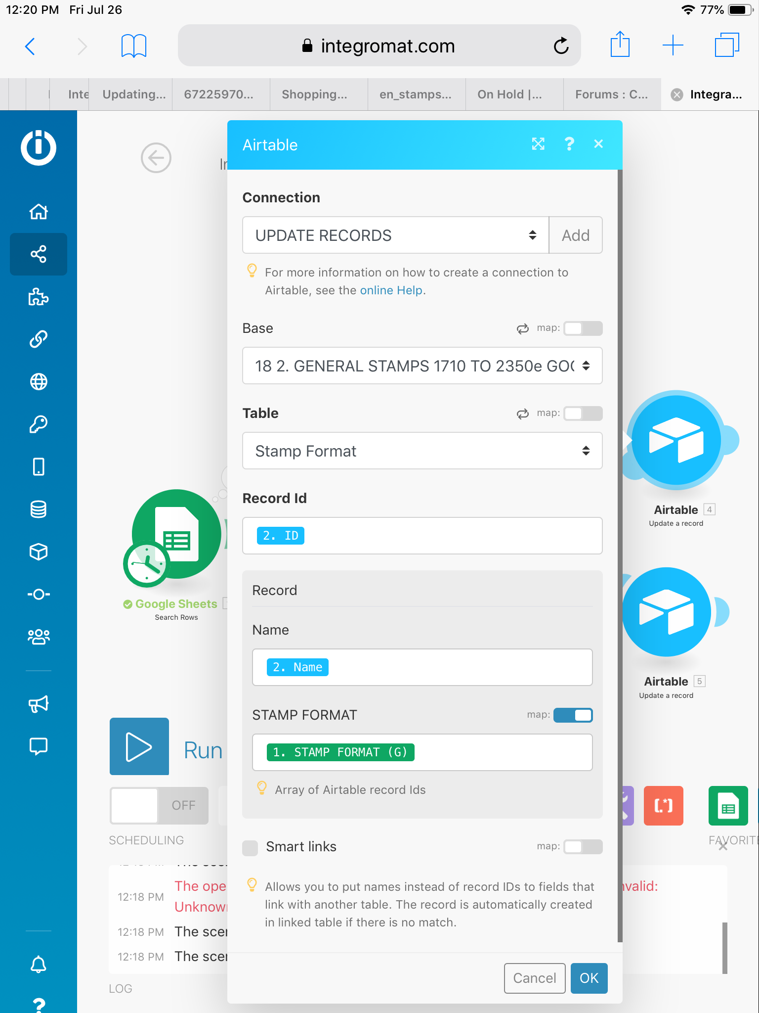

Just one way. Airtable automatically makes reciprocating links. So after making the link from [Imported Table] to [Stamp Format], you’ll see a matching link on [Stamp Format] pointing to [Imported Table]. Same thing for [Keywords].
SCOTT# has nothing to do with either the stamp format or the keywords. SCOTT# is part of what identifies a single stamp, so it should be part of the stamp record only.
I wasn’t sure what you meant when you said “I also linked SCOTT# field”, so I took a look at your updated table, and found that you’d added the SCOTT# values to the [Stamp Format] table as additional primary values. Those should all be removed. The only records in the [Stamp Format] table should be for actual stamp formats. You also won’t need a {SCOTT#} link field in the [Stamp Formats] table.
I think you might have misunderstood my comments on how to use this new [Stamp Formats] table (and [Keywords], as it’s doing basically the same thing), and I’ve also learned a little more since my last post, so I’ll re-do my suggestion with greater clarification of the process.
If I understand your project correctly, you’re migrating a stamp collection tracking system from Google Sheets into Airtable. As Integromat is going through Sheets data, it’ll pull up a row with stamp info: SCOTT#, description, stamp format, keywords, etc. The problem you had before when the {Stamp Format} field was a multi-select was that you couldn’t add a new format that didn’t already exist in the list. With the new field pointing at another table, and with the “Smart Links” feature of the Airtable module in Integromat, you won’t need to worry about that.

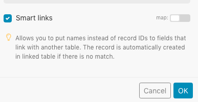

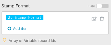

When editing the Airtable module to create (or update) a record, make sure that the “Smart Links” option (at the very bottom of the module settings) is checked on:
With that set, you can insert a pointer to the stamp format item coming from your Google Sheets module step into the “Stamp Format” field setup. Click on the “+ Add Item” link in the middle of the field, click in the Value field in the popup, choose the appropriate item from the Sheets module step, then click “Add”. You should have something like this:
Because of the “Smart Links” feature, it won’t matter that what’s coming from Google Sheets is a string like “Series of 4”. It will try to make a link based on the text. If’s there a matching record in [Stamp Formats], it’ll link to it. If it doesn’t exist, it’ll make a new record with that name, then link to it.
The problem isn’t with new vs updated records. The problem is with the available options in the multi-select. For example, if your multi-select field has three options named OptionA, OptionB, and OptionC, you can have Integromat fill in any of those for a new or updated record, and it won’t choke. But if you try to give it OptionD, that’s when the error pops up, I’m guessing because it’s tied directly to the field setup. That’s why the linked table workaround is preferable. Using Integromat, you can make new linked records on the fly, but not new multi-select (or single-select) choices.
