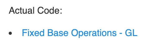

Hover Over URL:
Actual Code:
  • Fixed Base Operations - GL
  • Thanks Bill.

    Creation Code
    container+="<a href=’"+l[0][‘url’]+"’ target=’_blank’>"+f+"";
    Hover Over URL:
    Actual Code:
  • Thanks Bill.
    This is not the actual HTML code because the community platform is allowing the browser to interpret the HTML you are pasting. You need to paste an image of the actual code for me to see it.

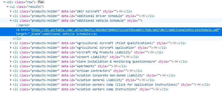

    Bill_French
    • Dec 12, 2019 3:26 PM UTC
    Was going to post the website but my API is exposed until I server side parameter the thing at launch. Bill if you have an email I could send you the site that way if you think seeing might help.
    Try this -
    1. Display the page;
    2. View the source;
    3. Find the place where this link is rendered;
    4. Take a screenshot of that area of the code from at least the beginning to end of the anchor tag.
    Forum|alt.badge.img+9
    • Dec 12, 2019 9:21 PM UTC
    Thanks again.
    Bill_French
    • Dec 12, 2019 9:51 PM UTC
    Thanks for pasting that image - it appears your code pulling from Airtable; the fields from the attachment collection are fine, and the HTML generated is fine as is the URL to the document.
    That leaves us with only one more place to focus attention - your DNS.
    Notice the error in this earlier posting - it references a DNS error server suggesting that the server hosting this page may not actually be able to resolve the Airtable URL for that document. Or… requests to https://ar.ecologik.net/ are somehow being redirected or refused in some circumstances. And quite possibly hinting at your original concern…
    But, without a lot more diving and access to all the machinery and a way to work within your network, it’s difficult to say what is causing clicks to fail and clicks into a new tab to succeed.
    One thing is clear though - your integration and HTML code appears to be just fine.
