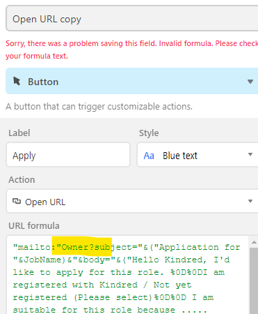

Hello! I cannot figure this out, would be grateful for any help.
I embed a view on our website and I want to include a button that will send an email to the collaborator named on the record.
However, I can’t seem to get the URL to incorporate the collaborators email address.
When I use the ‘owner/collaborater’ field in the URL it won’t save.

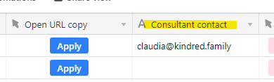

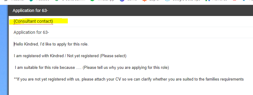

I then added a new field (consultant contact) with the collaborators email and used that field in the URL code, but the email it creates uses the name of the field (i.e. consultant contact) in the “to:” section instead of the actual information included in that field, i.e. the email address.

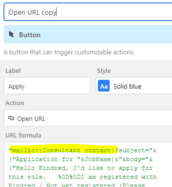

Hi @Karen_Lynch,
The beginning of your button URL formula has to look like this:
"mailto:" & {consultant contact} & "?subject="
One of the best ways for you to troubleshoot situations like this is to create a normal formula field with your entire formula that you’re trying to create, and see if it displays the proper string appropriately in the formula field.
Hope this helps!
