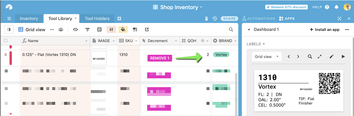

Hey all. I did some searching through the forum and support but don’t see this scenario. I’d like to use a Button Field to decrement (remove) one unit another cell (Quantity on Hand).
  1. The process would be to scan QR on a label made by page designer.
  2. On mobile you’d tap the button, REMOVE 1
  3. Button action subtracts one from the QOH cell of that record.

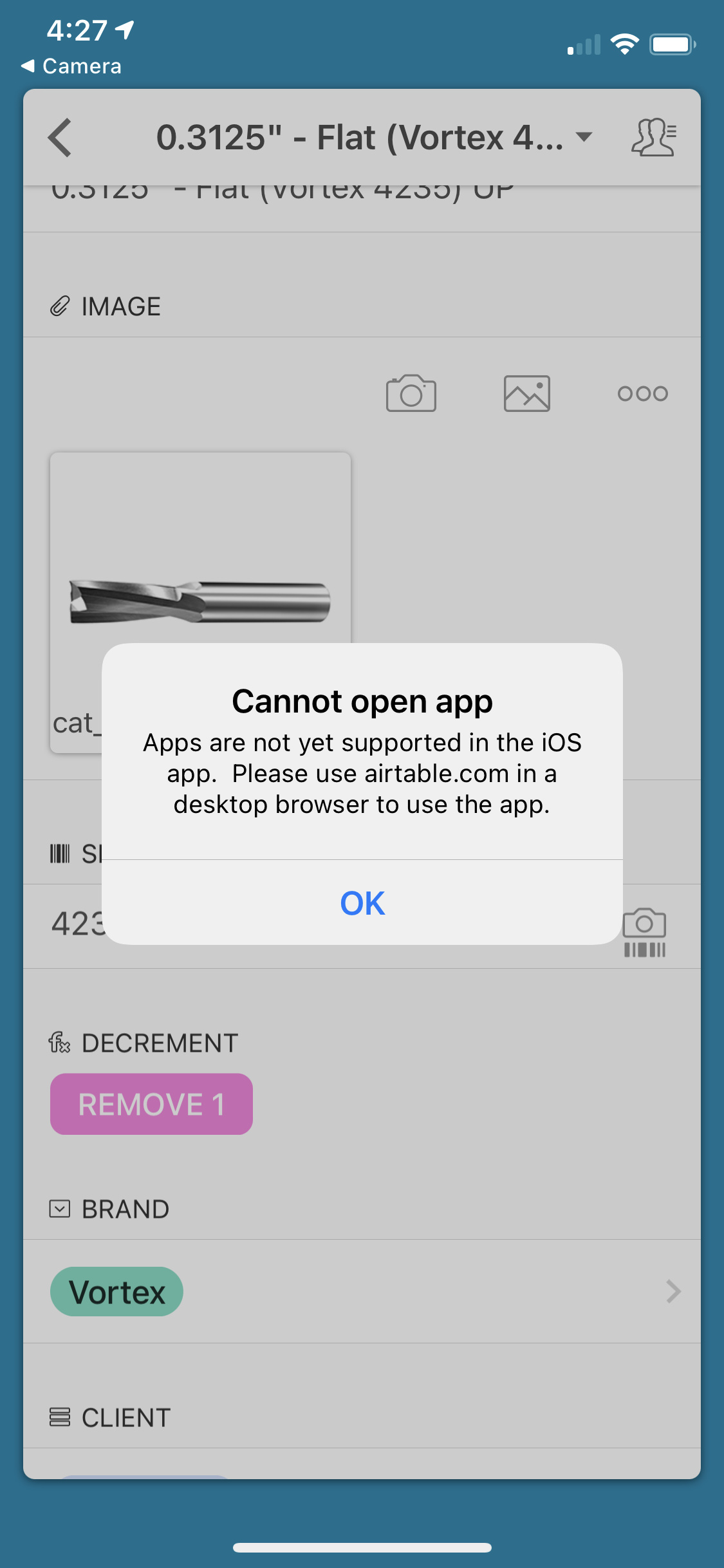

Holy moly that was a fast and perfect answer! This is fantastic - many thanks!
Edit - It worked perfectly on desktop and when I went to try it on iOS I got an error because Apps don’t work there yet - not something you @ScottWorld could change just relaying it for others finding this.
Hopefully, this changes soon?
  • Oct 11, 2020 11:54 PM UTC
There’s actually a workaround for this on mobile, which would be to use an Airtable automation instead.
However, you wouldn’t be able to use a button field anymore, because for some odd reason, Airtable has decided that buttons and automations are 2 separate things, and that buttons can’t trigger automations. Makes no sense. :man_shrugging:
So, instead of using a button, you’d have to use a checkbox field instead. Whenever you check the checkbox, the automation would decrease the number by 1. And you can even make your automation clear out the checkbox after you check it, so it’s ready to go again for checking again.
In fact, you wouldn’t even need a custom JavaScript to do this. You would just need a formula field that results in your current number field minus 1. Then, just have your automation set your number field to this formula field. And then have your automation clear out the checkbox field.

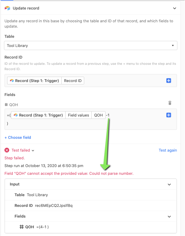

Oh no.
Silly question. I tried to make it a formula but it’s not liking that. Nor does it like QOH-1.
  • Oct 14, 2020 2:11 AM UTC
I meant that you actually need to create an actual formula field in your table, and then reference that formula field in your action step when you’re updating your number field.
Action steps themselves don’t support formulas, but it would be cool if they did!
