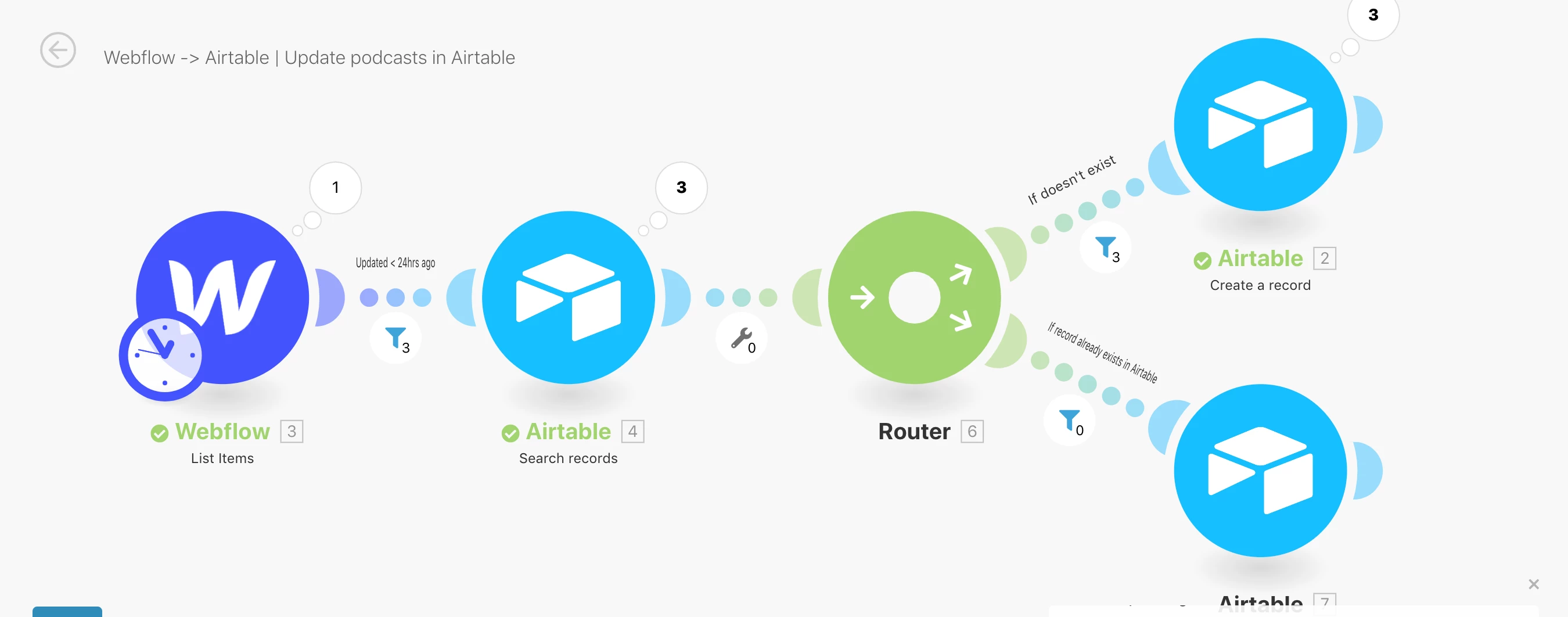

I have the below scenario in Integromat, which attempts to do the following:
  1. Lists all Webflow CMS items in a collection
  2. Lists all Airtable items on a page
  3. Where the Webflow item ID exists, update the Airtable base with the relevant Webflow details
  4. Where the Webflow item doesn’t exist, create the item

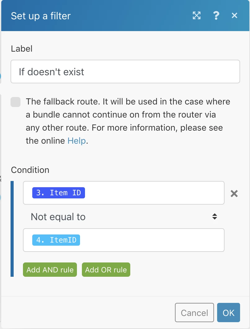

The ‘update’ function works fine, but I can’t figure out how to get the filter for ‘if ItemID doesn’t exist’ to work properly. It creates multiple versions of the same record.
My filter is also attached as a screenshot.

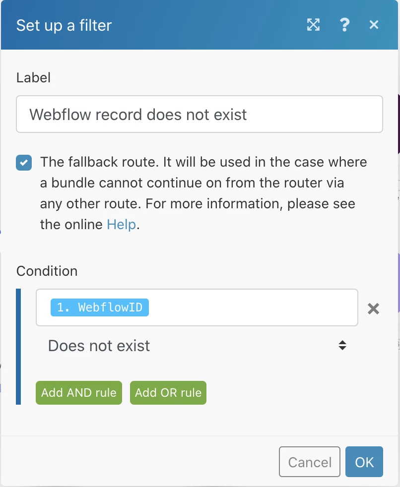

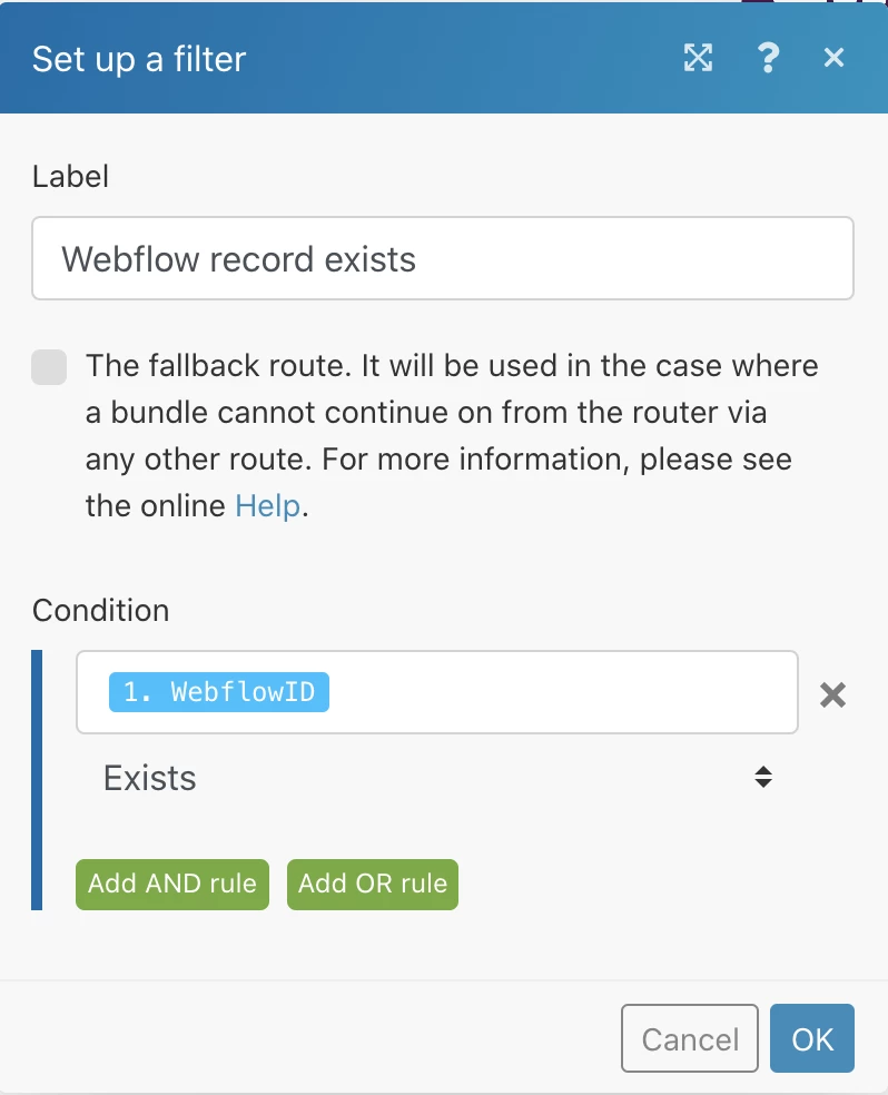

Hi @Alastair_Budge1, sure! The filter I used was ‘Webflow ID Exists’ or Does Not Exist.
Here’s what I did:
  • I created a column in my Airtable, and named it ‘Webflow ID’.
  • I imagine for my case, there can only be two scenarios. Either the item is already in my Webflow CMS, or it’s not.
  • Every item that has been uploaded to the Webflow CMS should have this ‘Webflow ID’. (Note: there are two IDs in Webflow. One is ‘Webflow Collection ID’, another is ‘Webflow Item ID’). We want the ‘Webflow Item ID’. You can find it in your Webflow CMS Collection.
  • If the item has been uploaded to your Webflow CMS, the ‘Webflow ID’ Exists. So we’ll just need to ‘Update Item’.
  • If the item is a new entry in Airtable, it hasn’t been uploaded to your Webflow CMS, the Webflow ID would Not Exist. In this case, we’ll need to ‘Create Item’.

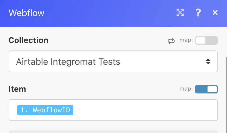

  • Now, I’m not sure if what you were facing was the same issue I had the first time. What I got wrong was the configuration of Item ID in the ‘Update Item’ flow. I thought Item ID was the Airtable ID. It should be the Webflow ID instead.
Hope this helps! Let me know if it works for you.

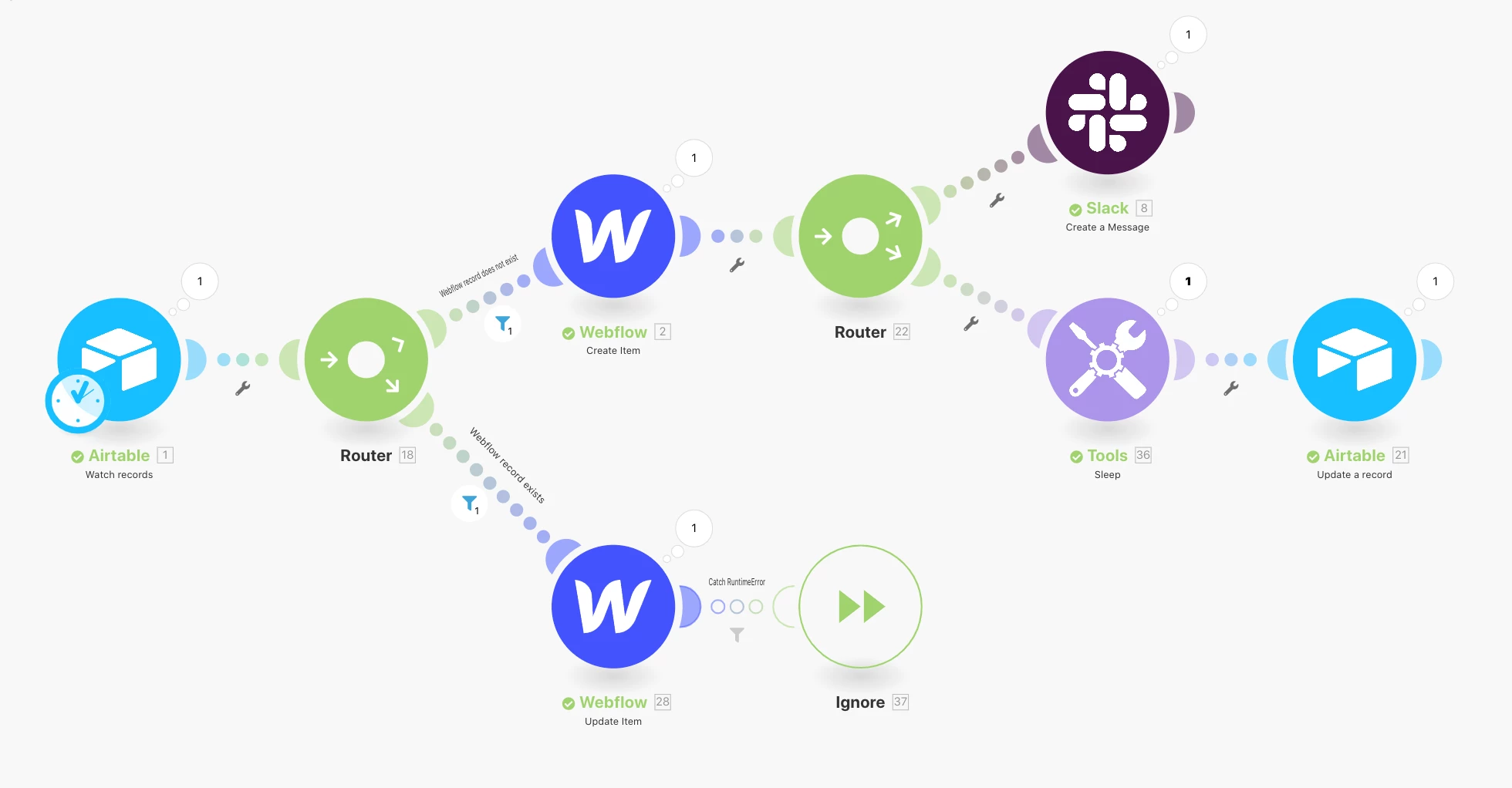

Hello @cor, I’m using Airtable as a CMS for Webflow too, via Integromat. I’m having some difficulties with Create item / Update item filters.
If it’s not too much trouble, do you think you can post your flow here, please?
Oh wait. Think I found the issue.
‘Item’ was set to ‘Airtable ID’. But it should be ‘Webflow ID’. Now it works!
Would you have some feedback for the flow here? Thank you!
