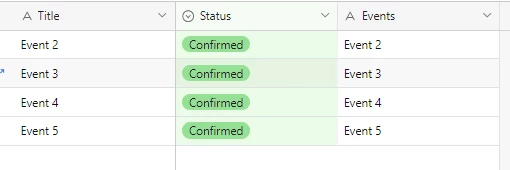

copy/paste content of field "Title" into field "Events":

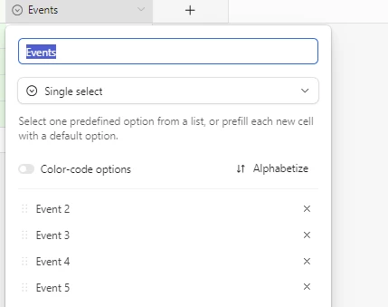

Change "Events" field type to "Single select" (I suggest to uncheck "color-code options" because this option does not make sense if your have too many events):

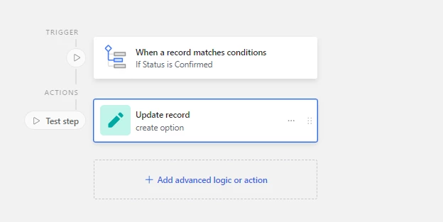

In order to avoid maintaining this field manually, you can create an automation triggered when status is confirmed:

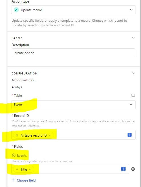

Action update record to push the Title field value into field Events and hence create the new option:

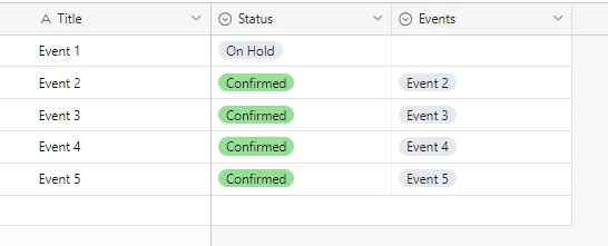

Now, if we consider following table with Event 1 not confirmed yet:
If we change the status to confirmed, Option "Event 1" is created into Fields "Events" and this record takes the value "Event 1":
