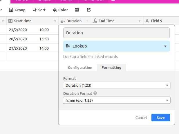

I’m trying to create a business schedule table.

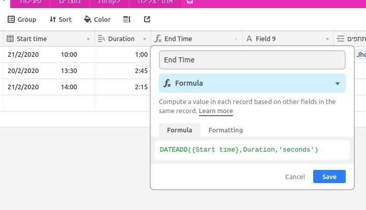

There are ‘start time’ and ‘duration’(a lookup value from a different base) fields, and I try to formulate the ‘end time’ field by aggregating the first 2.

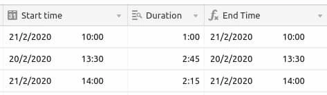

For some reason the below formula gives the start time unchanged.
DATEADD({Start time},Duration,'seconds')
I tried to change the seconds to minutes and hours with same result. {Duration} also didn’t change.
The formatting option “Use the same time zone (GMT) for all collaborators”, is disabled in both date fields.

Best answer by kuovonne
I was able to see the same problem as you. I suspect the problem has to do with the lookup.
My workaround was to force the {duration} into a number by adding zero to it.
DATEADD({Start time}, {Duration} + 0, 'second')
In my test, only {Duration} is a lookup; {Start time} is a regular date/time field.
