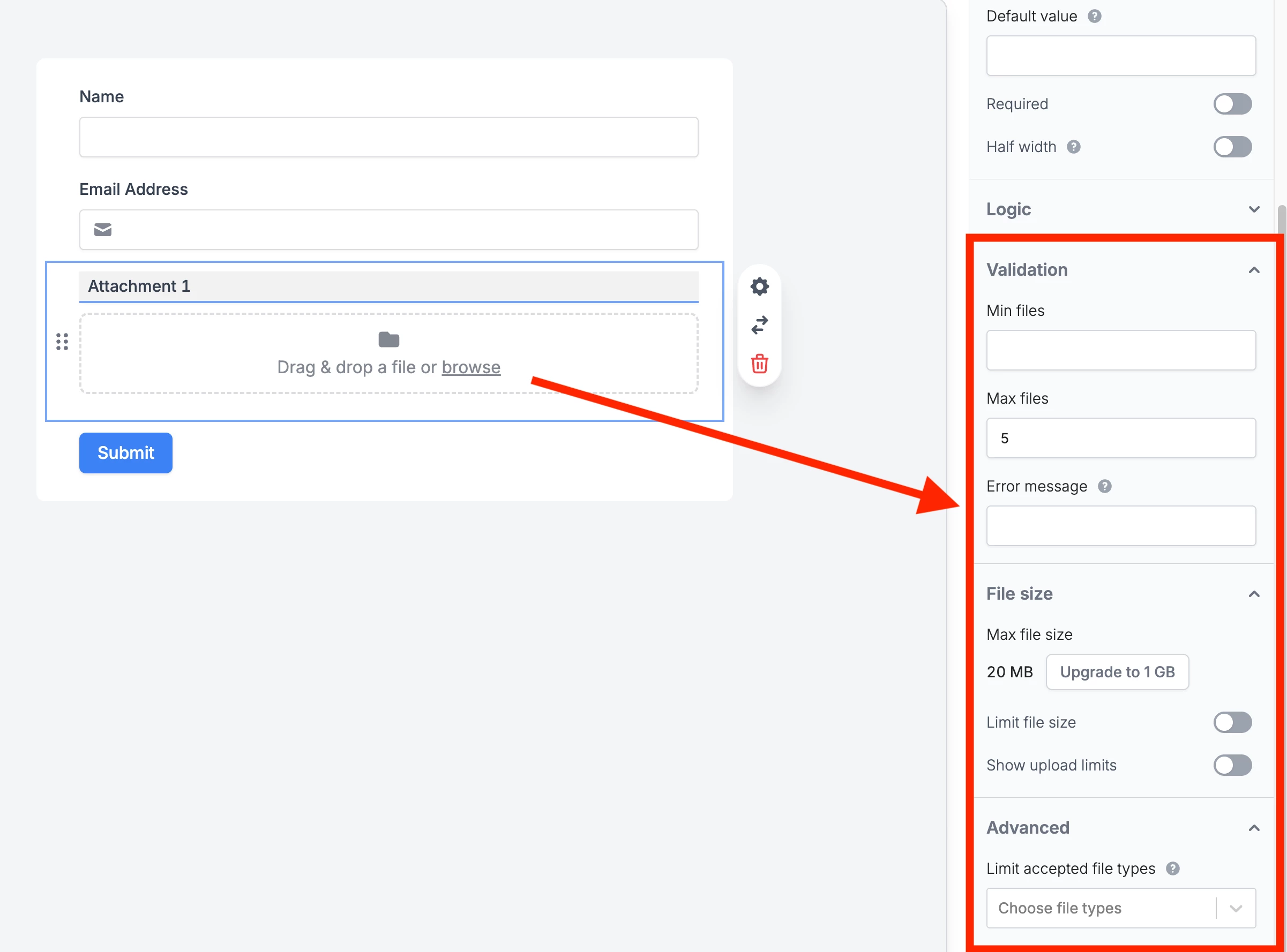

​@Team_Upp
Your best bet for all of this is to use Fillout’s advanced forms for Airtable.
Fillout is 100% free, and it offers hundreds of features that Airtable’s native forms don’t offer, including all sort of control over attachments.
Check out my screenshot below, and you will see that you can specify the number of files that you are accepting, you can specify maximum file sizes, and you can specify allowed file types.
Fillout also offers so many other things for Airtable, such as the ability to update Airtable records using a form, display Airtable lookup fields on forms, control access to a form via SSO or email domains, perform math or other live calculations on your forms, accept payments on forms, collect signatures on a form, create multi-page forms with conditional paths, create new linked records on a form, connect a single form to dozens of external apps simultaneously, add CAPTCHAs to your form, and much more.
