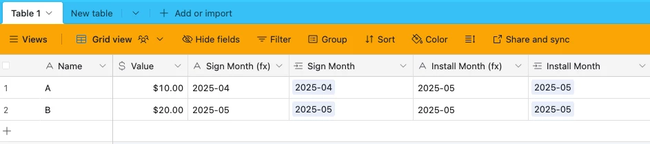

I have a database, which is extracted from our CRM. We sell and install equipment. There are two key dates, which are important: sign date (i.e. when we won the job) and install date.
I have created two formula fields (‘Sign Month (fx)’ and ‘Install Month (fx)’) to give the month in YYYY-MM format. I then have an automation in place to copy these calculated fields into ‘Sign Month’ and ‘Install Month’, which are linked fields.

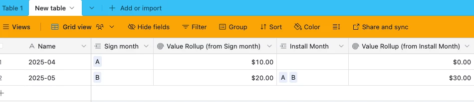

Hmm, I tried to set this up and got confused.  Here’s what I’ve got:
It seems like this does what you need but I can’t be sure.  If you could let me know where I got it wrong I’ll see what I can do!
  • Jun 4, 2025 5:17 AM UTC
Perfect, thank you. I missed that you can select the rollup source
