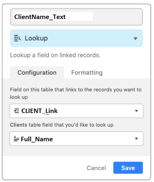

Hello Simon, please send a screen shot. If I understand you correctly, your solution is to create another field to extract the data from your linked record field in a more friendly fashion.
EX:
Lets assume you have an INVOICES_tbl (that shows the total amount owed to each client per invoice) and a CLIENTS_tbl (with contact info of each client, and a field for the clients name called Full_Name).
  1. Lets assume your linked field is called CLIENT_Link and it…
    • links to data in your CLIENTS_tbl.
    • and dislplays the name, but returns the record it in PoweQuery / Power BI
  2. So, to return the client’s NAME instead of the record ID, create a field called ClientName_Text like so…
EX:
Yep, this solved the problem, thank you very much for you hasty response.
