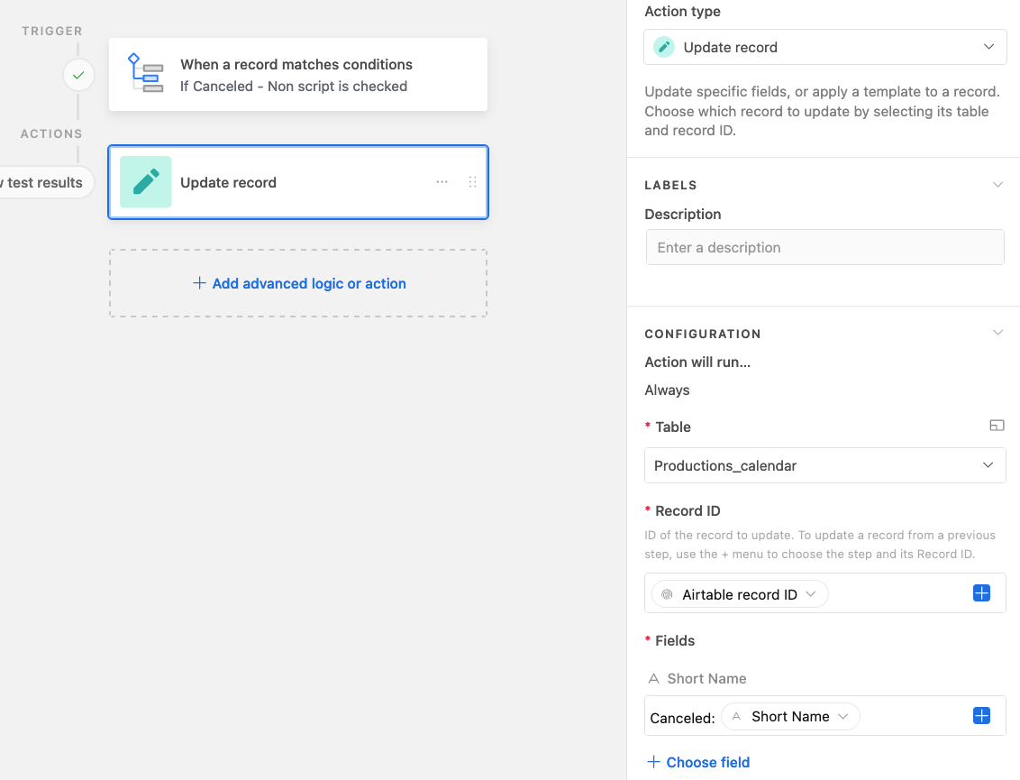

You can also do this without a script by setting it up like so:
And I've set up both automations here
Thank you for the tip on the script! It's funny, the latter (no script) method you suggested didn't work for me. It threw errors and would not run. It was what I tried first.
