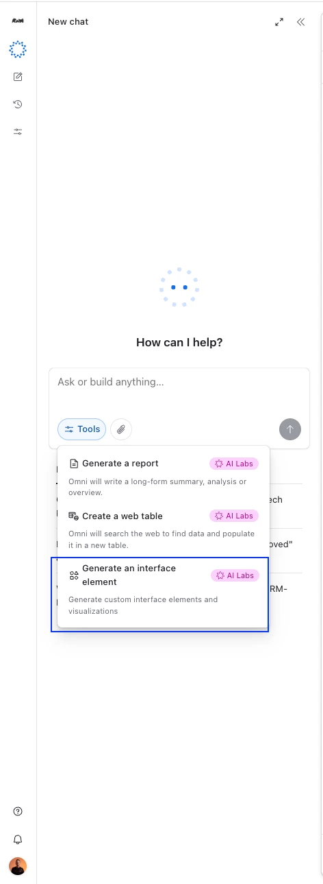

Once you’ve got the data - I find it best to use actual data in your tables so then you have a a solid base to start with and can see exactly how the information will be presented - use Omni and click the Tools > Generate an interface element (AI Labs should be switched on).
Click Tools then “Generate an interface element” - make sure AI Labs is switched on.

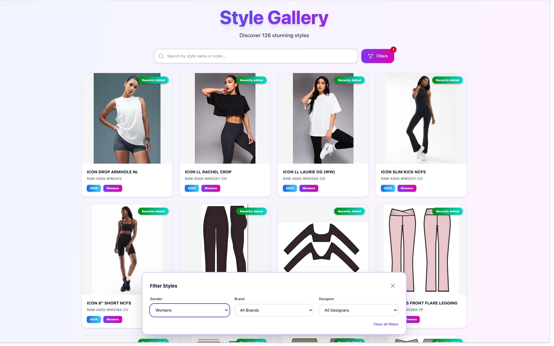

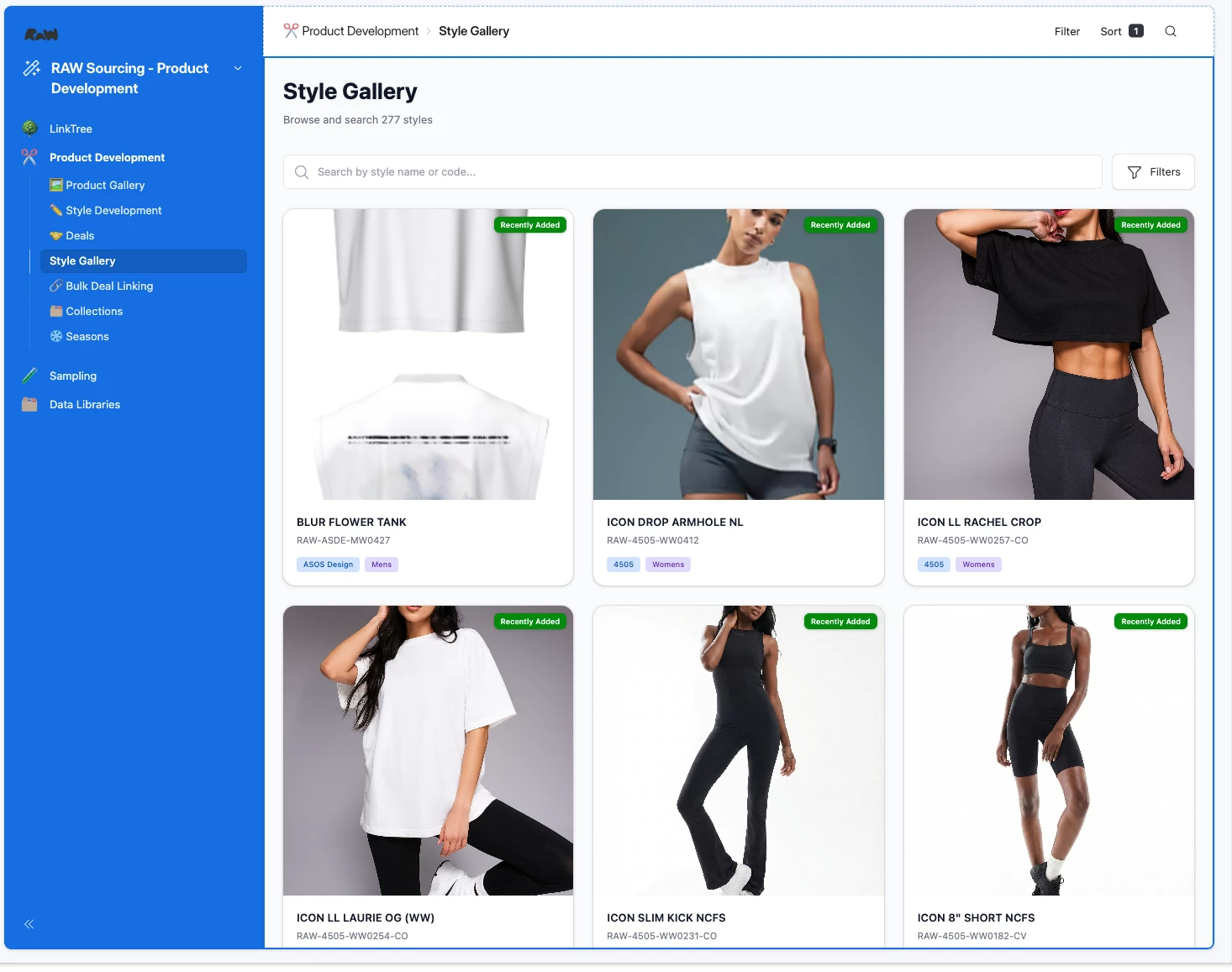

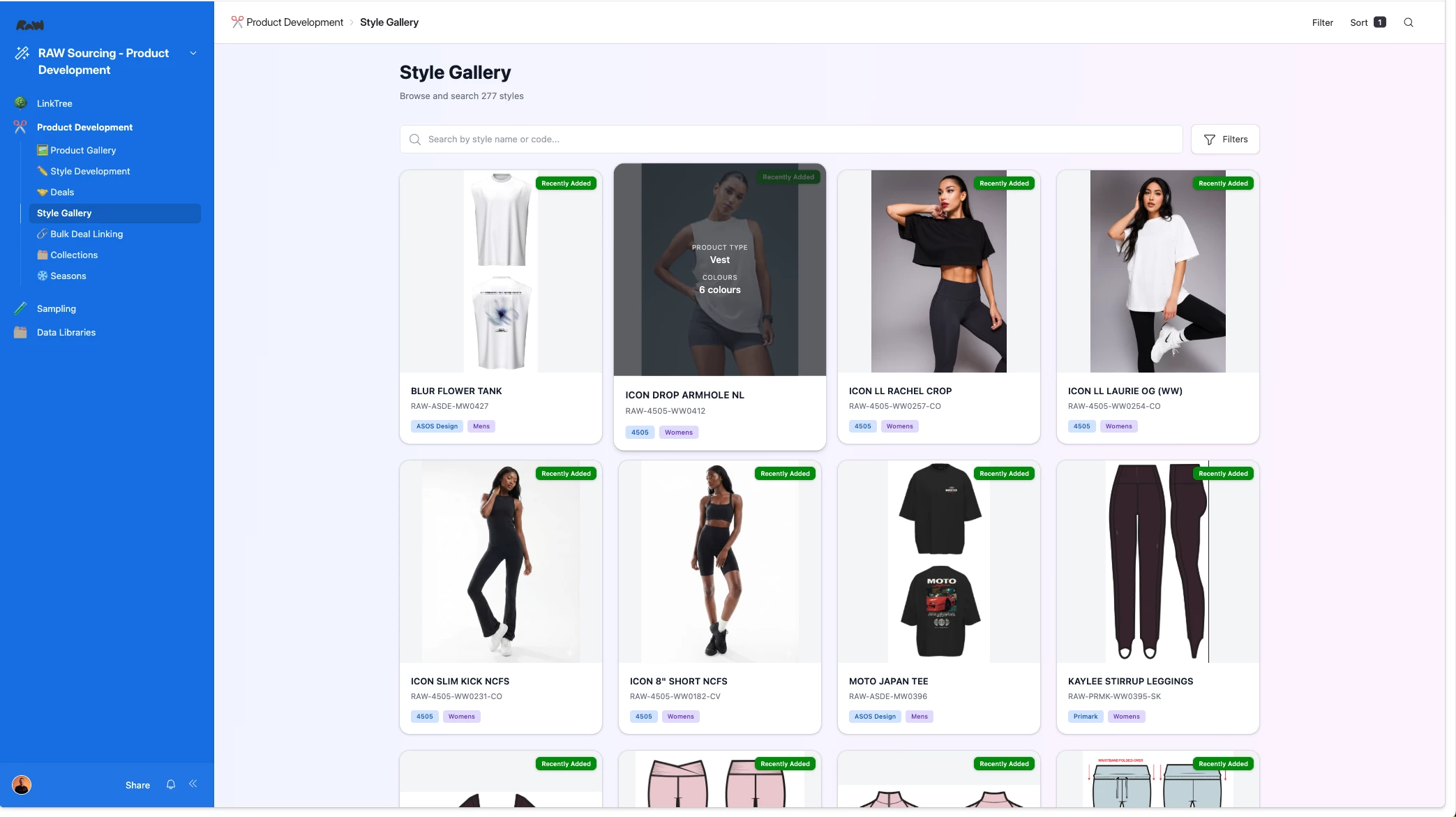

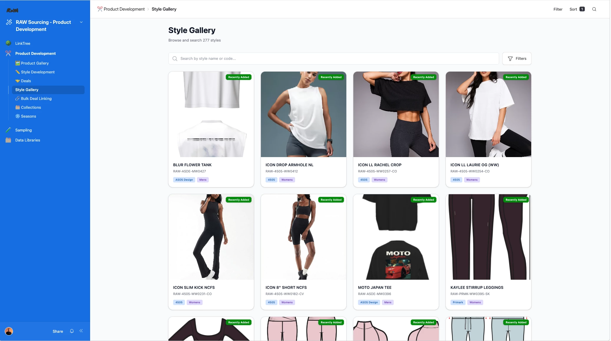

Here’s the first result:
Style Gallery created by the first pass of the prompt to create an interface.
It’s a good start, but there is still so much more potential. It also doesn’t always meet the requirements. For example, in this iteration I can’t click in to view record details, but the filters and the search work great. But now I iterate, so for this case, I want to see a record detail modal (like a pop up box for each style), and I want a bit more colour and flair to it, because it’s a bit basic.

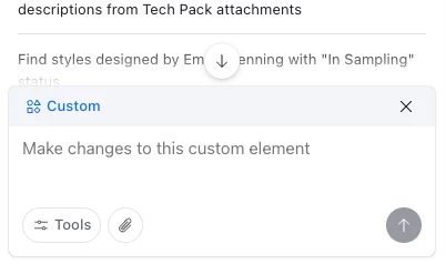

Click into the Custom Interface so it has a highlight box so Omni knows this is what you want to edit.
Double check there is a little “Custom” badge above the Omni chat box
To iterate, edit and change, make sure that you’ve clicked into the custom interface from the edit view and there is a little “Custom” badge on the chat box.

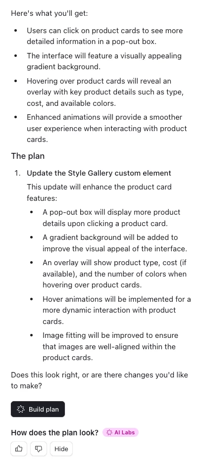

Omni then provides a build plan (if you have it switched on in AI Labs) that explains the changes it is going to make - if it makes sense, click build plan and it will regenerate the code.
Omni Build Plan (AI Labs)

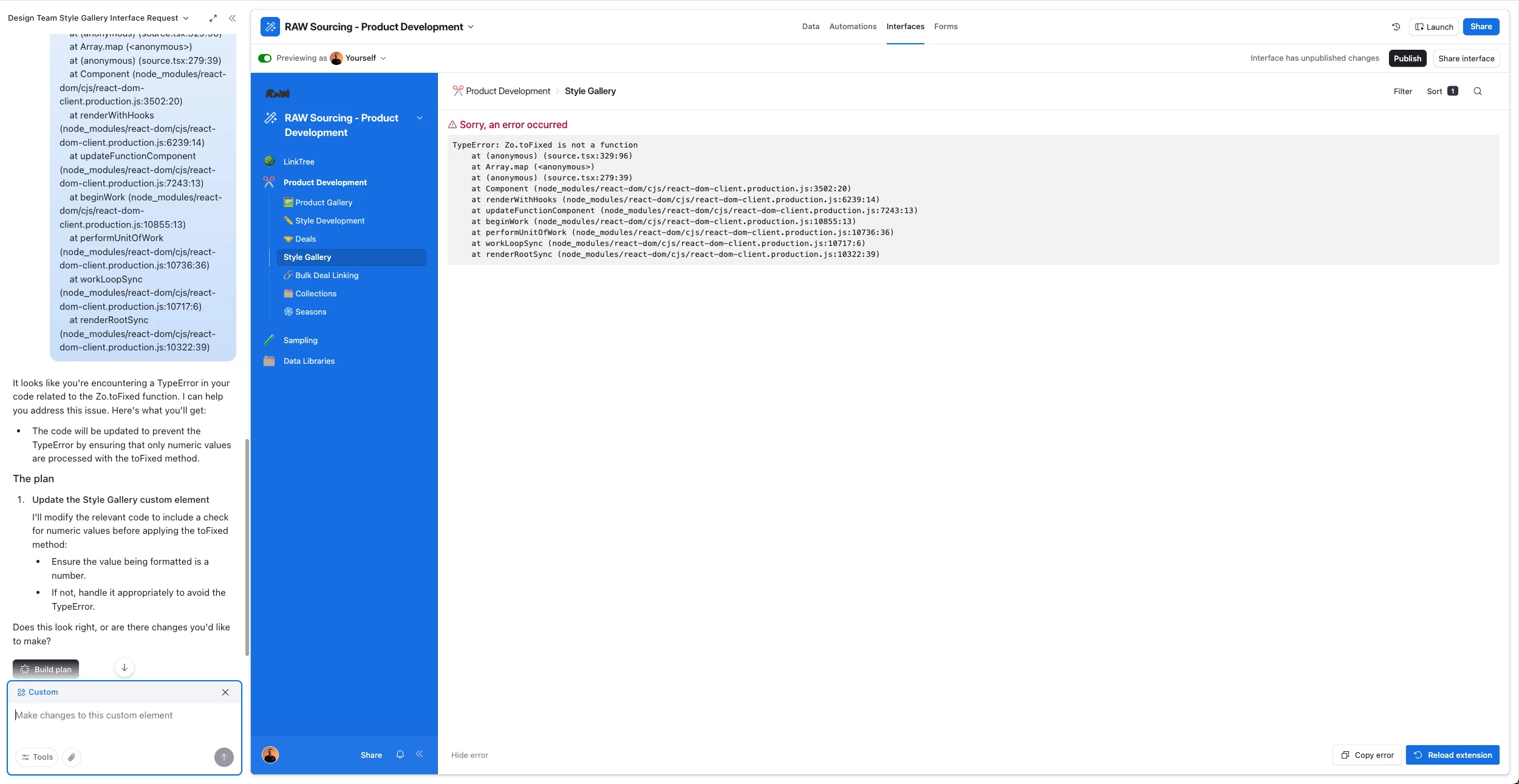

Sometimes Omni will throw an error during generation, but you can usually just copy the error and ask Omni to fix it:
Error Message - Copy and paste into the chat box

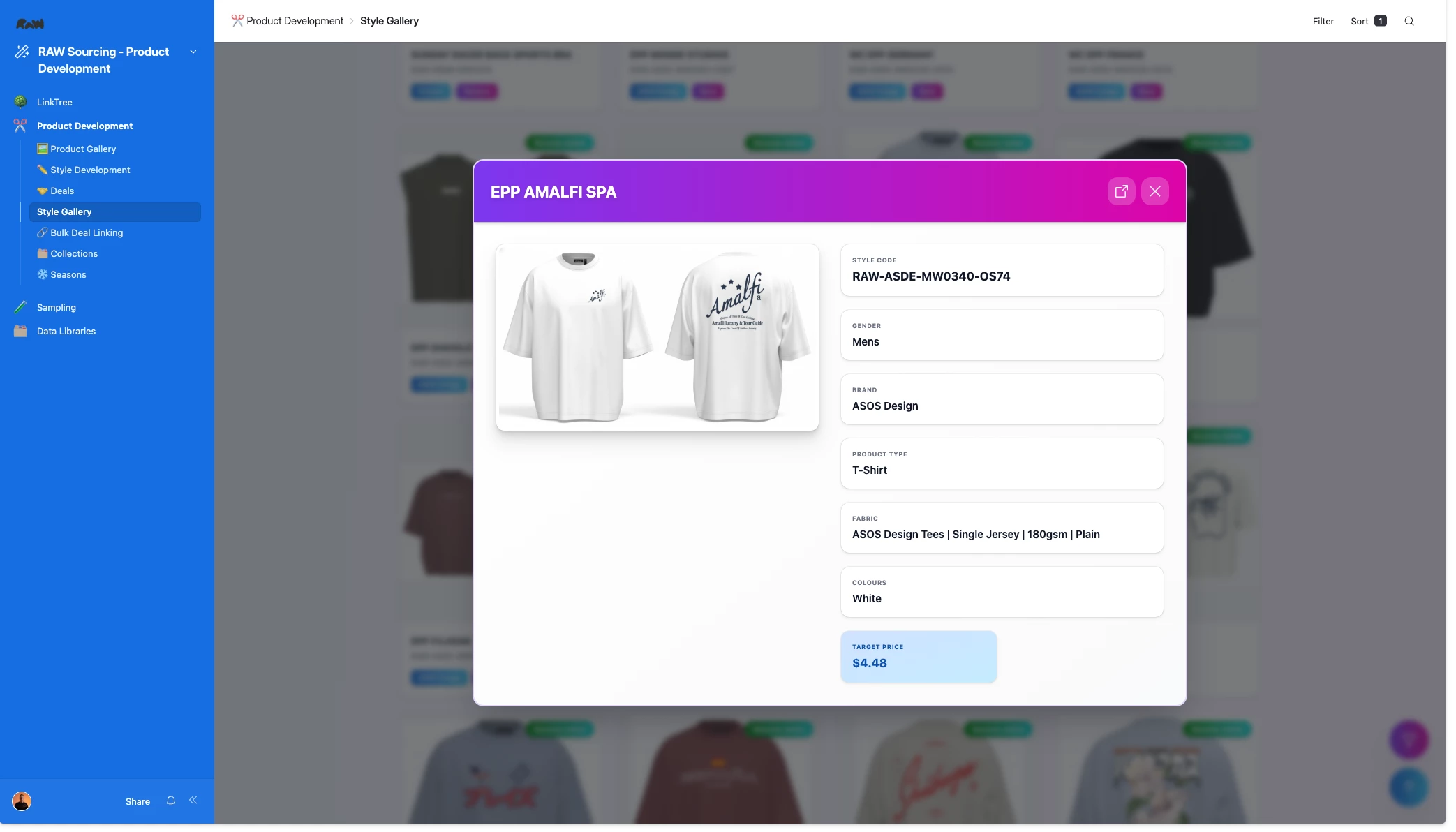

And here was the result:

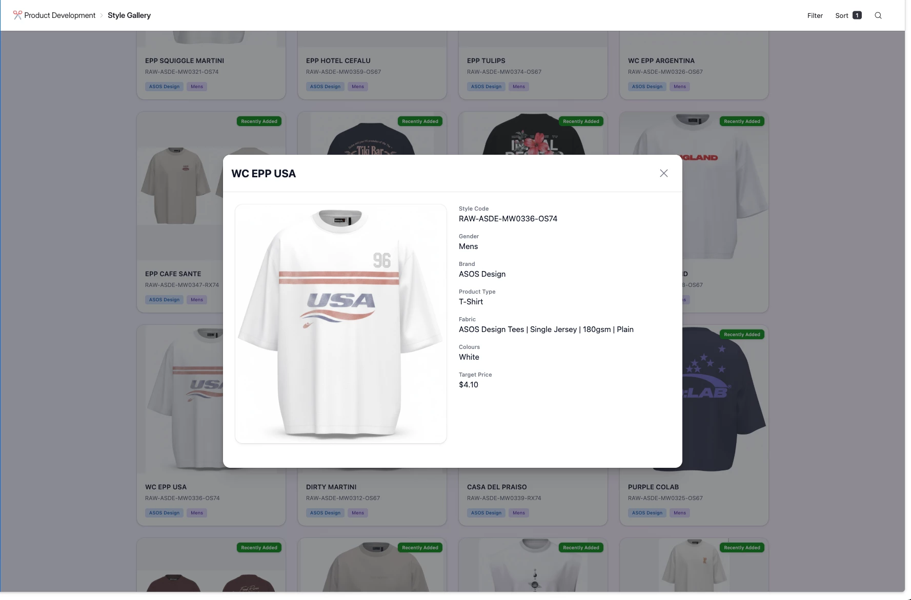

Interface v2
Modal Pop up box of additional product details
Hard to show in a screenshot, but as you scroll through the gallery, each product card has a small animation that shows which product you’re hovering over. This is pretty good and does what I need it to do, but because I like aesthetics, I want to make it flashier and prettier, so thats what I’ll tell Omni to do - I tend to direct omni in an aesthetic direction, usually gradients but you can be specific with your colours if you know exactly what you want.

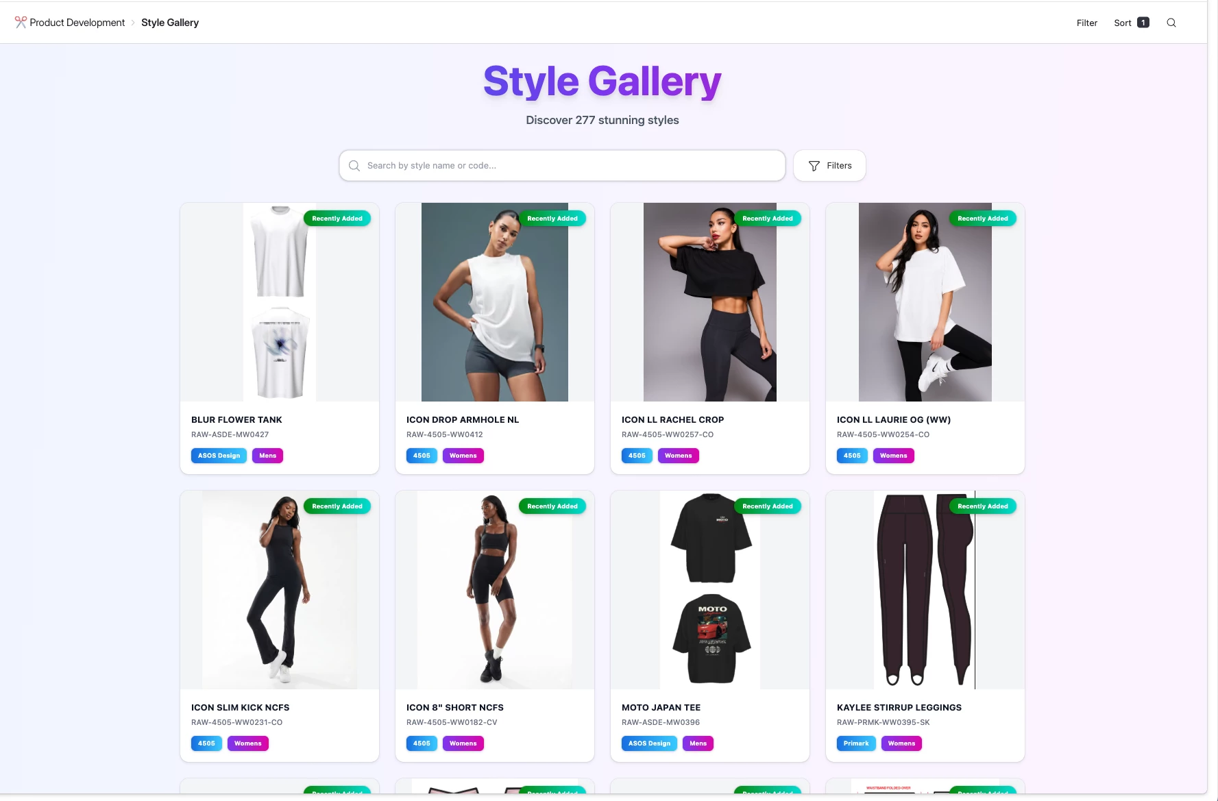

Omni Prompt 3:
Add some more flair to this interface. Add gradients to each of the tags - Brand, Gender and Recently Added. Make the filters a floating box that follow the user as they scroll and can be added or removed easily. Give the interface title a bit more theatre and add improve the visual of the pop out box for product details. Add an option to open record detail.
Again Omni should provide you with a build plan:
Here's what you'll get:
  • Enhanced visual appeal with gradients on tags
  • A floating filter box that follows users as they scroll
  • A more theatrical interface title
  • Improved visuals for the product details pop-out box
The plan
  1. Update your Style Gallery interface
    I'll enhance the interface with the following changes:
    • Add gradient styling to the Brand, Gender, and Recently Added tags
    • Implement a floating filter box that remains visible as users scroll
    • Enhance the interface title for more visual impact
    • Improve the design of the product details pop-out box
    • Include an option to open the full record detail
Does this look right, or are there changes you'd like to make?
And here is the result:
Interface v3
Interface Filters v3

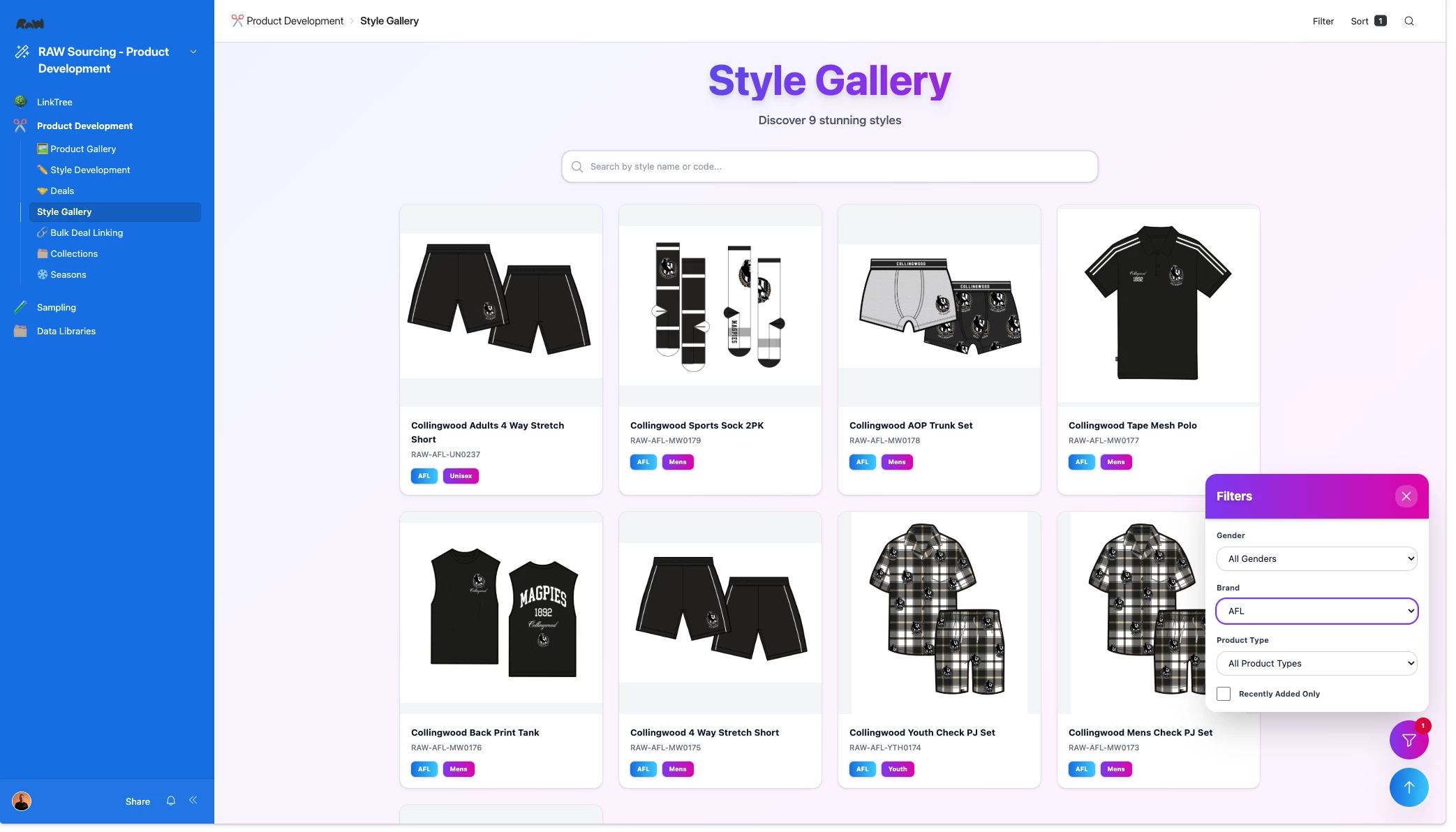

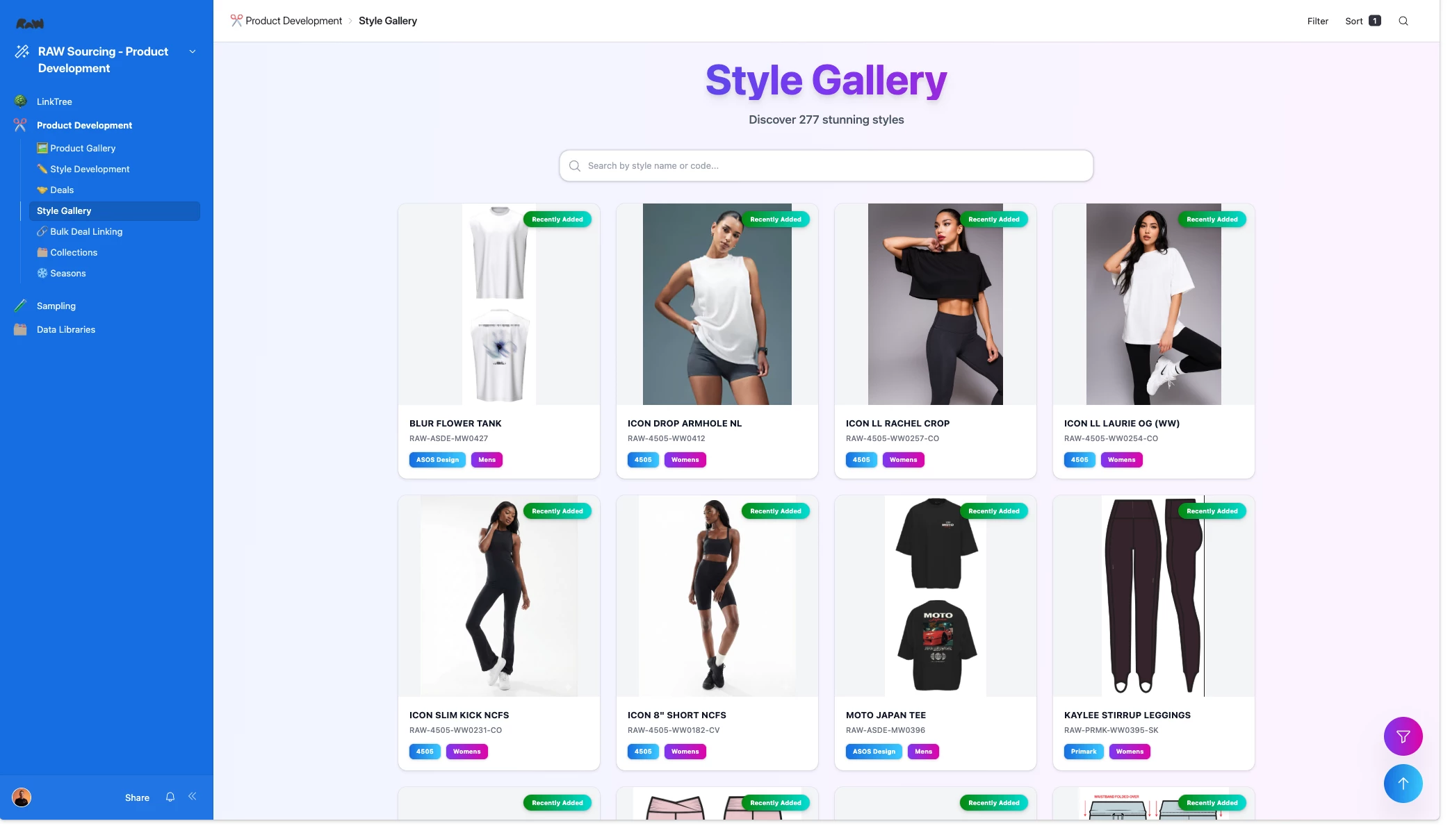

But this is not quite what I wanted for the filter so I have been specific in the next prompt:
The filters button should be a small circular button with a funnel icon, that remains in the corner of the interface and travels with the user as they scroll. Clicking the funnel should open a filter box which the designer should be able to minimise whilst scrolling.
Interface v4
Interface with Correct Filters
Interface v4 Pop Up

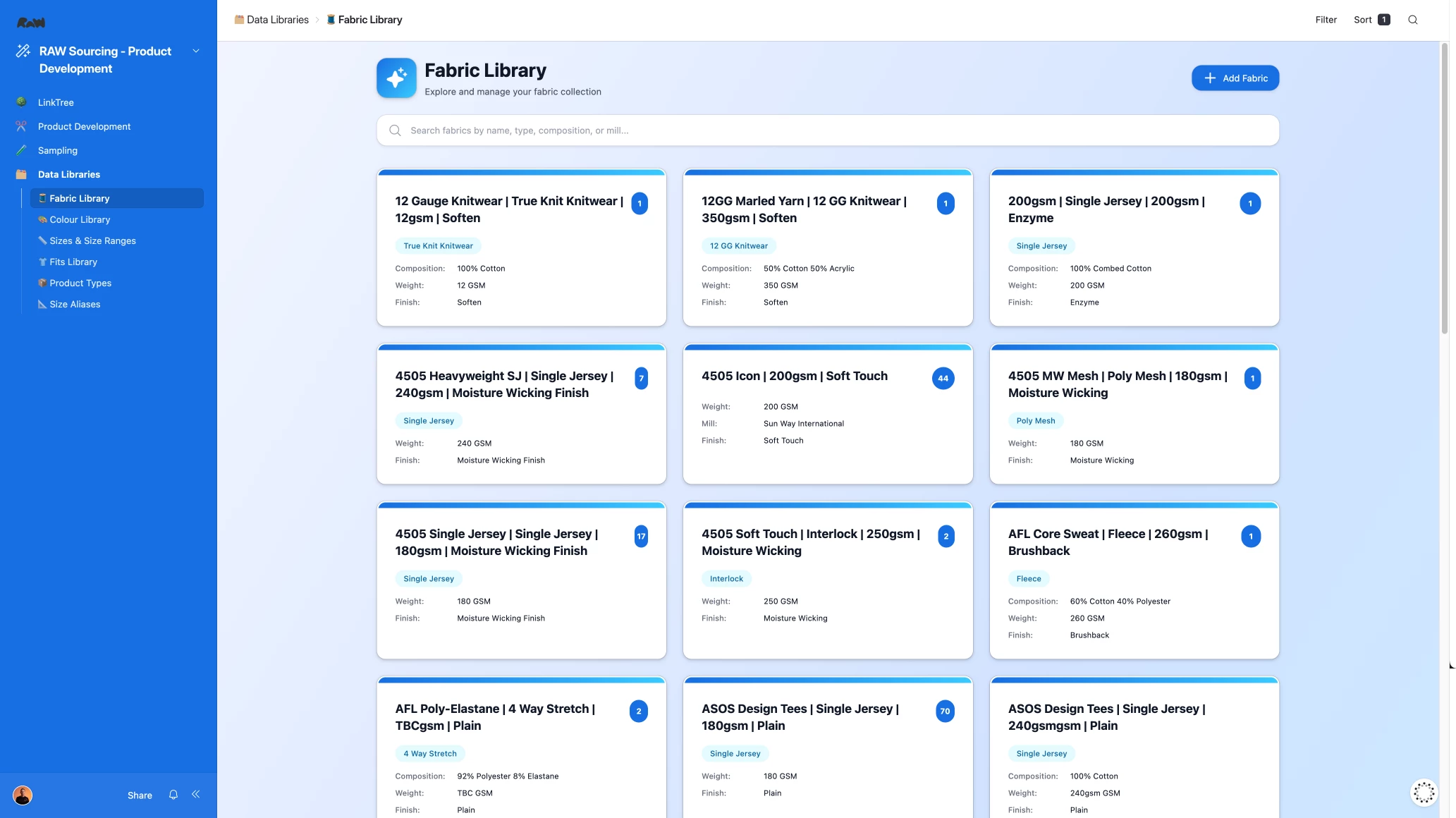

This was the final result, which I’m pretty happy with! I’ve attached a few more screenshots for some other interfaces I’ve created, and also a Loom Video that shows a majority of them in action (there’s no voiceover, just a visual tour).
Article Explore App

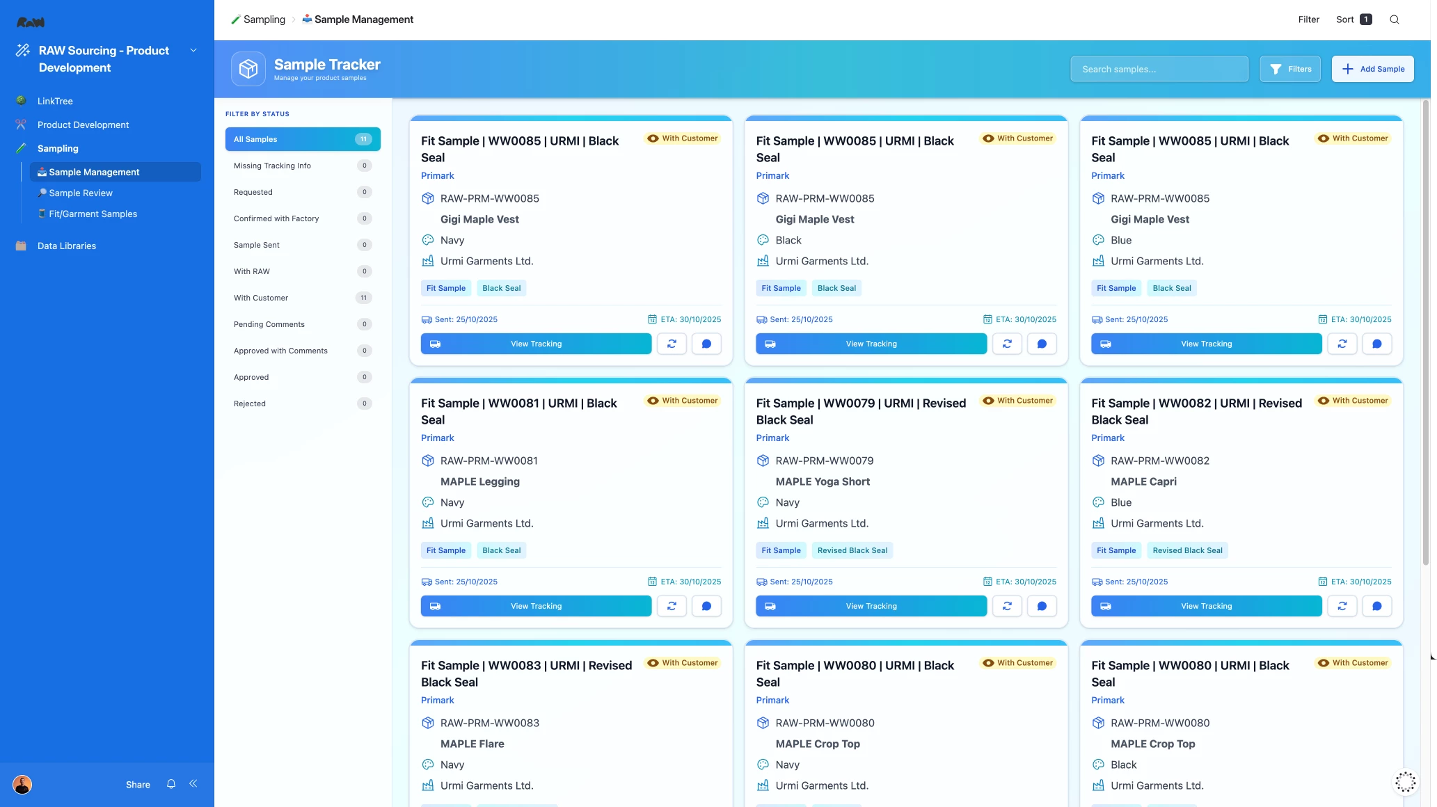

Sample Tracking
Fabric Library

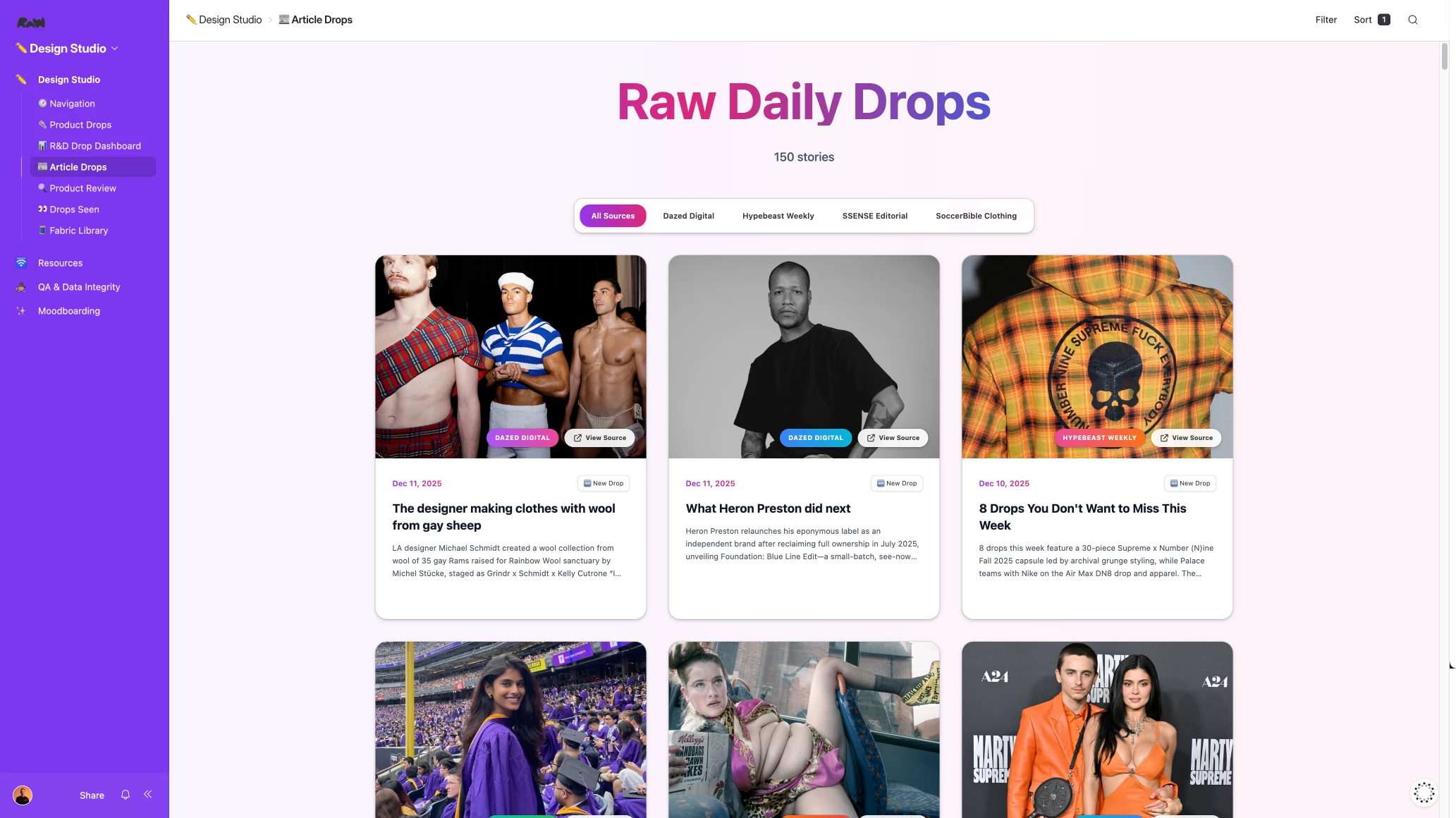

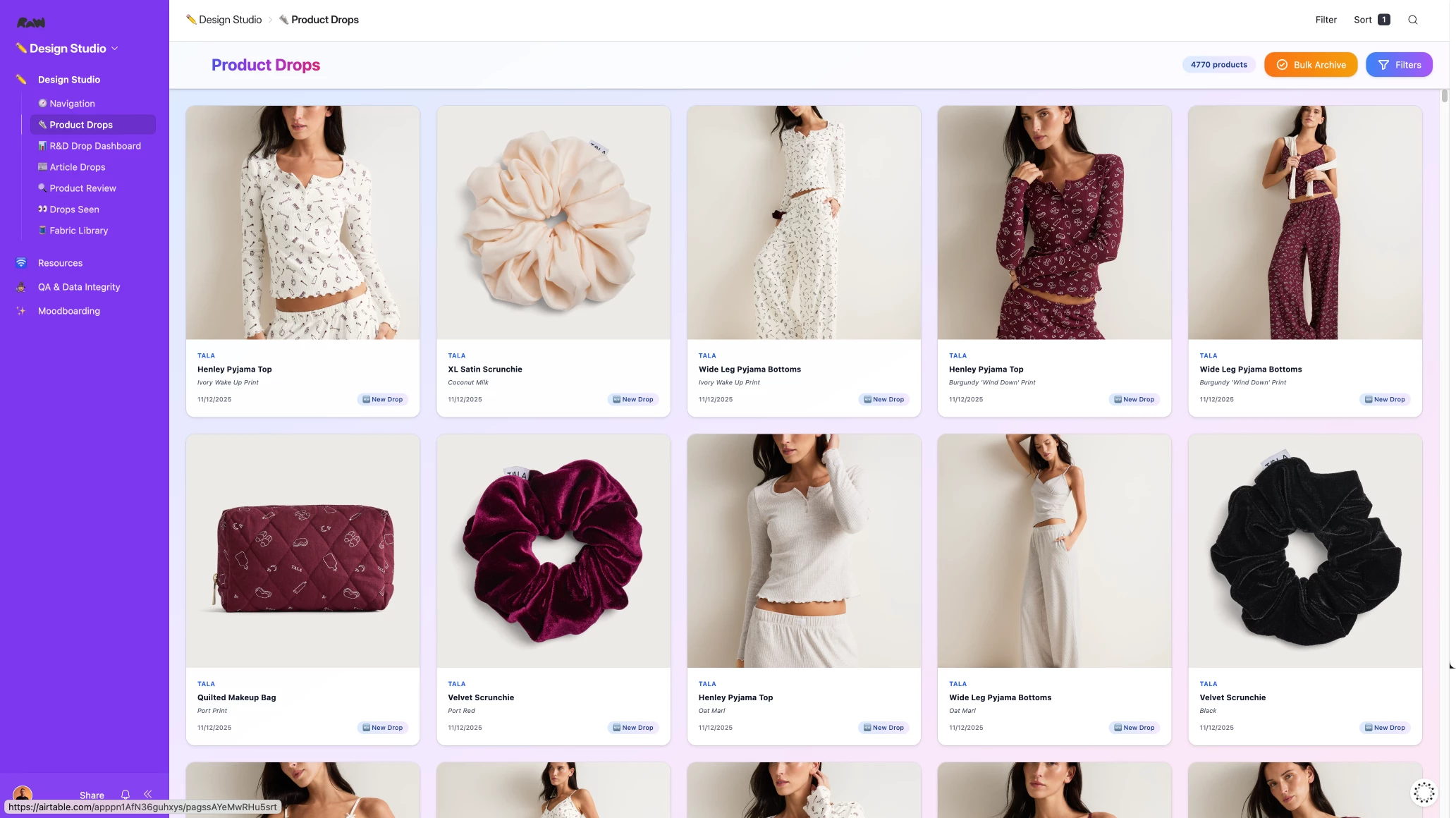

Product Drops (my current favourite)
You can probably see I have a specific aesthetic I try to meet on all of them 😂

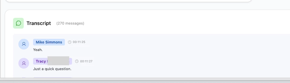

What I loved:
I have an integration Fathom<>Airtable which pushes raw json of the transcript from the recording into a long text field and “the interface” takes care of processing such data for different uses (showing participants, showing transcript in a very nice way as shown below, etc). So this allows me to be waay more efficient with record count and avoid helper fields!
