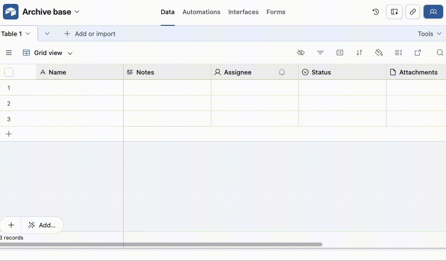

  1. Create a new base for archiving purposes
I’m pretty sure everyone knows how to do this one, so I’m just going to skip it heh

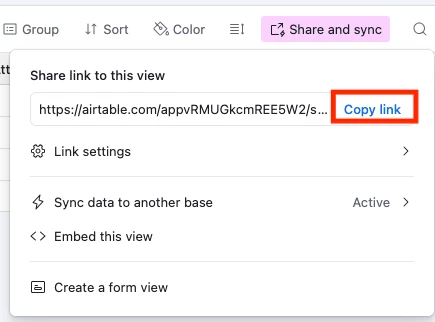

2. Create a synced view and sync it to the new base
  1. Click ‘Share and sync’
  2. Click ‘Sync data to another base’
  3. Toggle on ‘Allow data in this view to be synced to other bases’
  4. Optional but recommended: Set a password for this shared link
  1. Copy the shared view link:

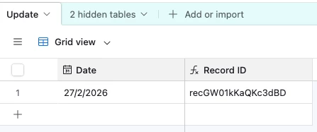

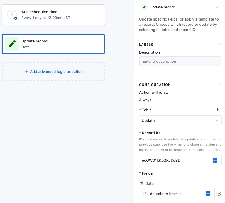

I usually just set up an automation that runs once a day, and its action is to update a date field with that date.  And so I have a table with one record in it and a Date field:
And an automation that fires once a day to update the Date field with the current Date:

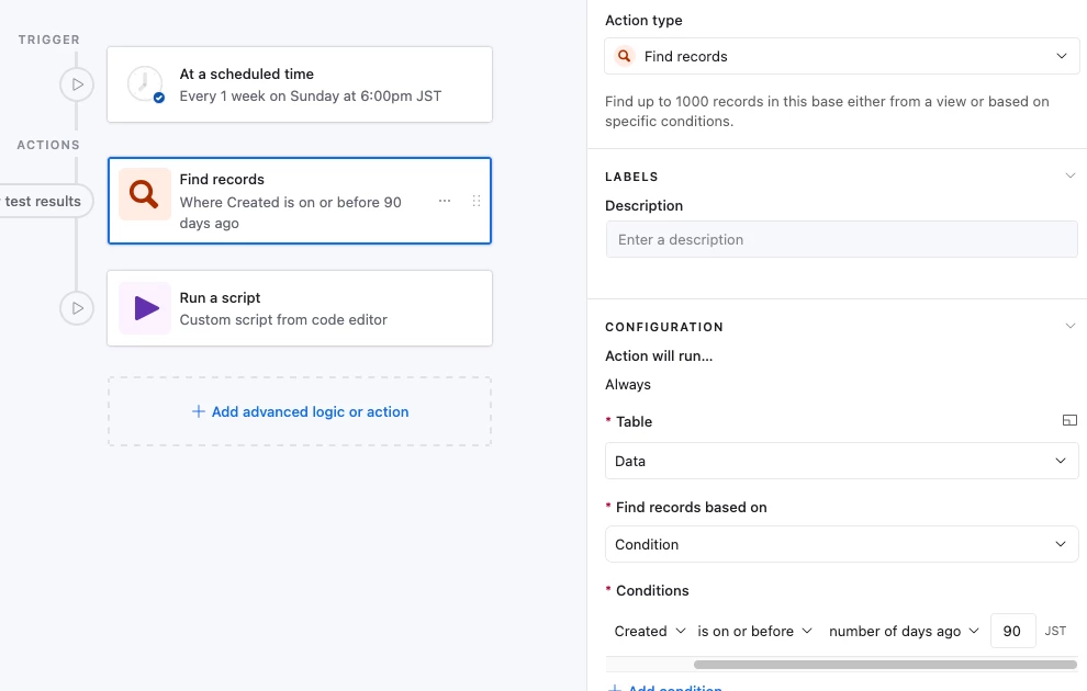

4. Set up an automation in the main base to delete the old records

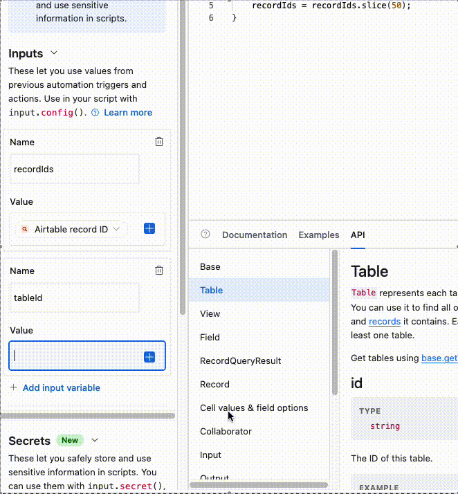

In the main base, create an automation that runs on a schedule and its actions will be to find the records that aren’t useful anymore and delete them.  To do this, you’ll use an automation with a ‘Find Record’ step to get those records, followed by a ‘Run a Script’ action to delete them

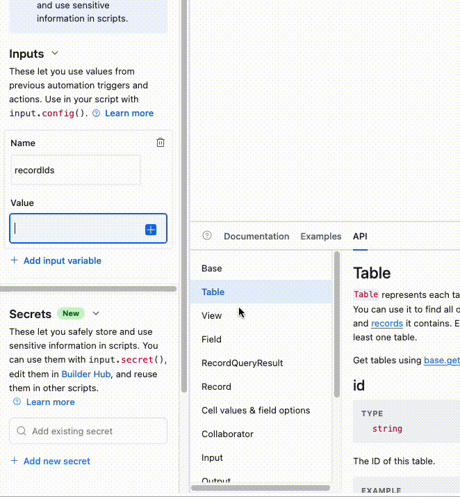

To set up the ‘Run a Script’ action, we’ll first add in two input variables:
  1. recordIds: The record IDs of the records we found with the ‘Find Record’ step:
  1. tableId: The table ID of the table we’ll be deleting records from:
And for the script, we’ll just paste this in:
let {recordIds, tableId} = input.config()
while (recordIds.length > 0) {
await base.getTable(tableId).deleteRecordsAsync(recordIds.slice(0, 50));
recordIds = recordIds.slice(50);
And that’s it!  Let me know if you encounter any issues and I’ll do my best to help!
