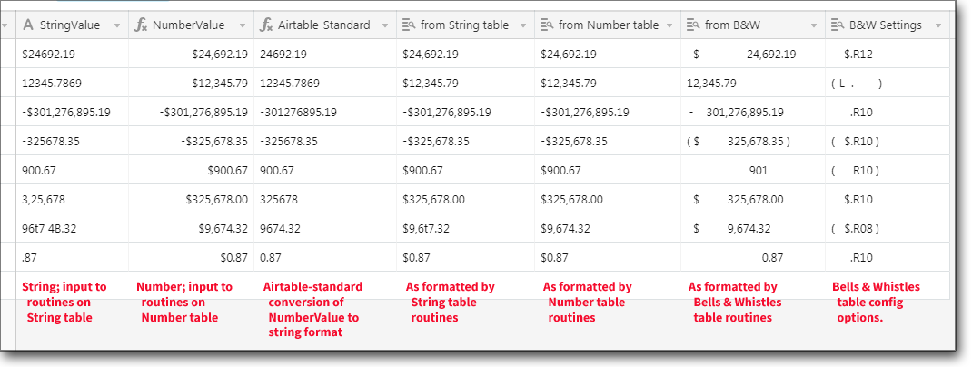

The base includes four tables: [Currency Demo], [String], [Number], and [Bells and Whistles]: [String] and [Number] contain the formulas to format, respectively, strings and numbers (clever mnemonics, no?); [Bells and Whistles] provides an interactive demonstration of the enhanced formatting routines; and [Currency Demo] brings everything together on one display, as so:
  • {StringValue} contains strings, some malformed, as input to the routines in the [String] table.
  • {NumberValue} is simply {StringValue} wrapped in a VALUE() function; you can see how Airtable interprets certain malformed numerals.[1] Here I have formatted the resulting values as currency, primarily to demonstrate how such formatting is lost when Airtable converts the field to a string.
  • {Airtable-Standard} illustrates Airtable’s standard number-to-string conversion. Note how the currency indicator, thousands separator, and forced decimal points are all lost.
  • {from String table} and {from Number table} are simply lookups of the formatted output of the two sets of routines, demonstrating the return of ‘pretty-print’ formatting to the numeric values and the standardization and normalization of string values.
  • Finally, {from B&W} and {B&W Settings} display, respectively, the output from the ‘bells and whistles’ routines and the current configuration of each field. (More later.)

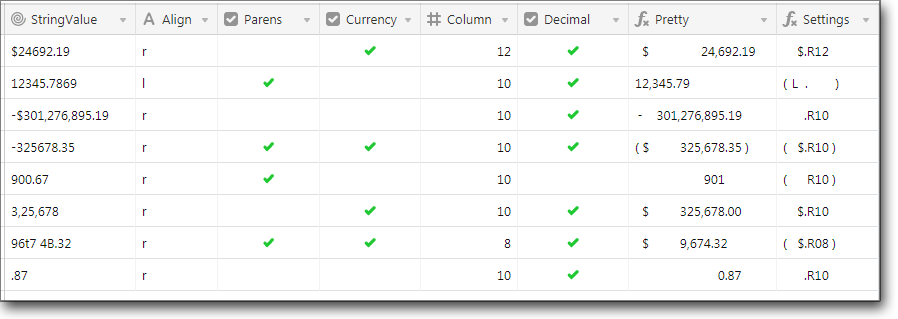

Bells and Whistles
The [Bells and Whistles] table provides routines for enhanced string formatting and an interactive demo of this functionality. It takes as its input a string value[2] and outputs a string according to a number of configurable options, as shown below:
  • [R]ight or [L]eft alignment
  • Parentheses or hyphen-minus to indicate negative values.
  • Currency or not
  • Number of columns to the left of the decimal point (only meaningful for right-aligned text, and column number does not take into consideration spacing for parentheses, hyphen-minus, or currency indicators)
  • Forced decimal (and two significant digits) or not
Each of these values can be changed in the grid view, with the output string automatically reformatted accordingly. The final displayed field, {Settings}, shows the current output configuration.
Unlike those created by the [String] and [Number] routines, [Bells and Whistles]-formatted strings right-align properly, regardless whether they are positive or negative values.
In practice, this code would not ordinarily be used in an interactive manner; instead, the routines would be adopted with configuration options hard-coded.

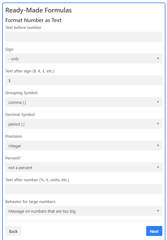

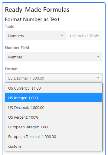

If you want to be able to have “Pretty Print” numbers without messing with editing these massively complex formulas, try out my Ready Made Formulas app. You just pick your number format and the app generates the formula for you.
You can also customize the number format if you don’t find a preset format you like:
Note that this particular formula requires a premium license, but the time you will save in setting up the formula is well worth the price.

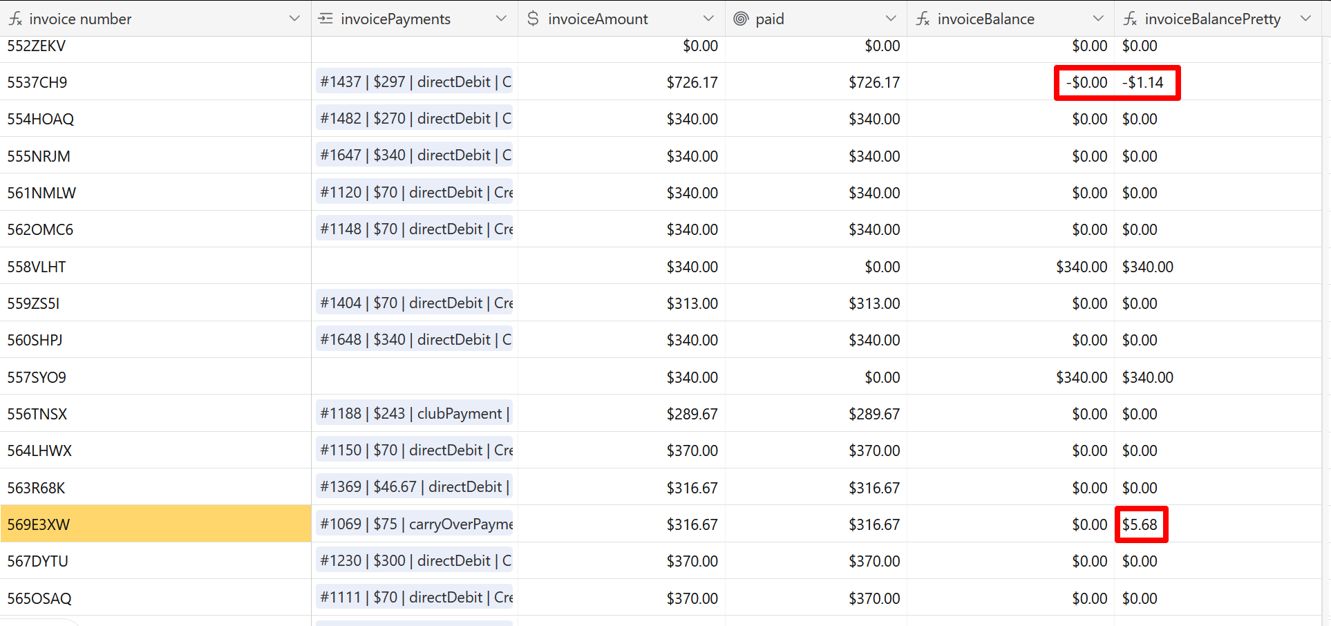

I have a crazy weird one.  As per the sceenshot, doing invoices.
  • invoiceAmount is a currency field, and is entered with an automation (it does not matter if I change it or enter it manually though).
  • paid (formatted as a currency) is a rollup of the amount field (currency) for the attached invoicePayments.
  • invoiceBalance is a formula (invoiceAmount-paid)
  • invoiceBalancePretty I am using the formula from the number (table) -> pretty (field) from the base attached to this thread.
Weirdly, three of these have wigged out, 3 of 715. That 5.68 is also not 5.68, but when I print it, becomes 5.65....e-14 (so this is some crazy fraction of 1).
Any thoughts?
