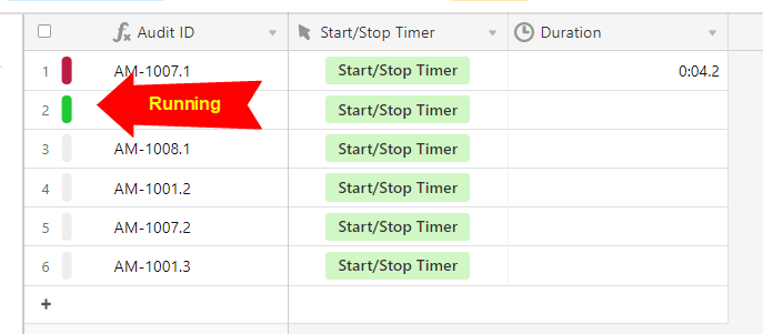

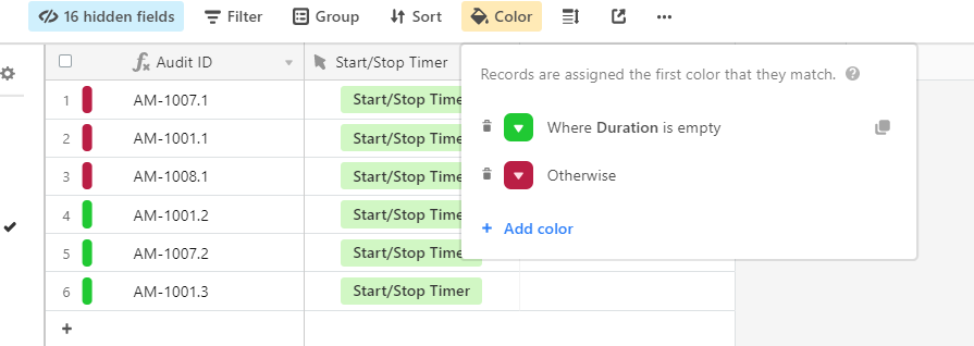

Pretty cool. I set up a little color scheme so that when stopped it’s red (Duration is not empty) and green when started (Duration empty). The only issue is the start. You have to click that first time to get this started. Not sure how we could indicate that the button has never been pushed before.

Using color conditions is an awesome idea! To add one that will trigger for un-timed records, add another color option above the {Duration} field check that sets a color when the data field is empty. It’s only going to be empty before the timer is run once, so that condition will only be true once. After that, the others will take over.
Ah, smart. Works great.
