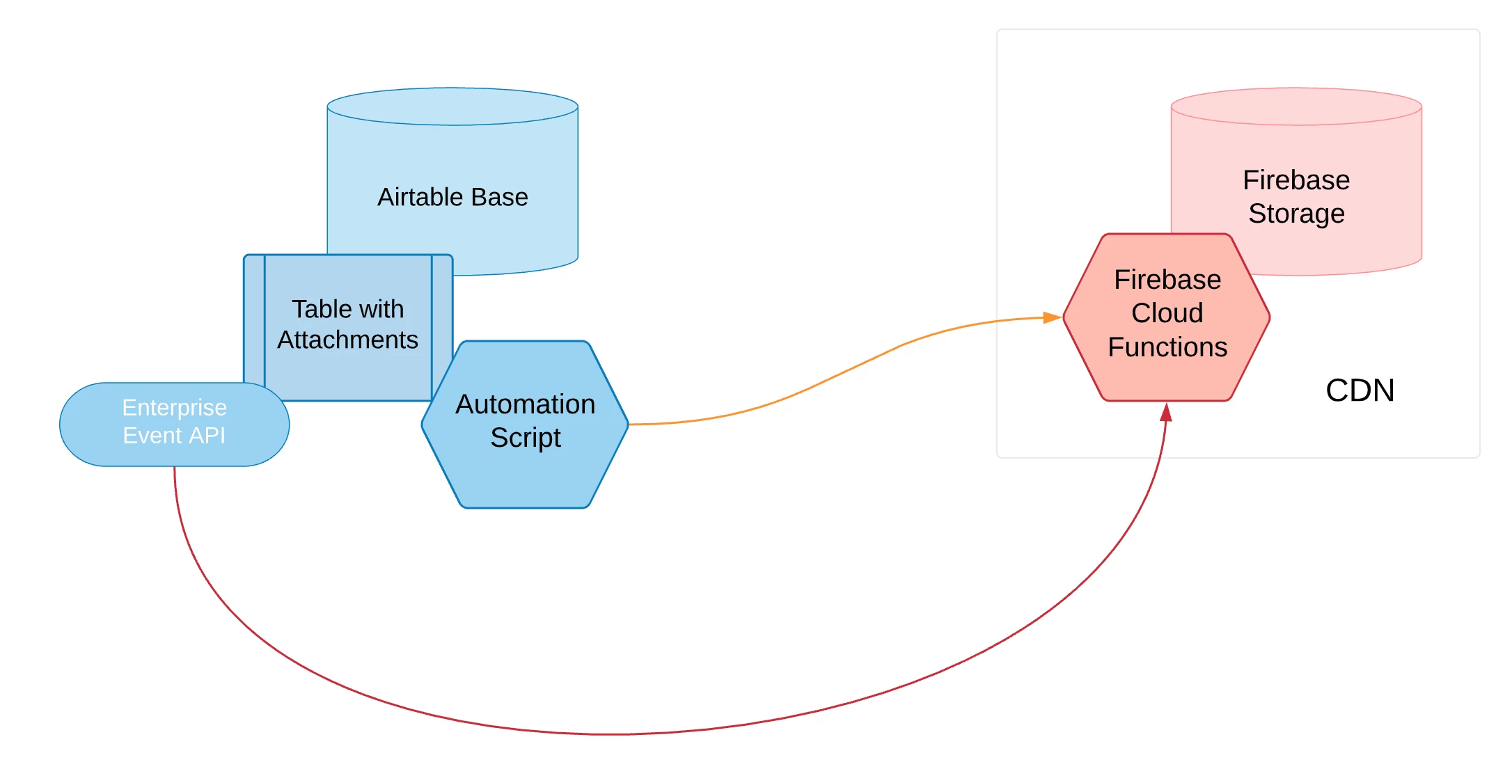

I’m already a miniExtensions Customer but I don’t have (yet) an account at CLOUDINARY so I haven’t tried it yet because I’m currently trying to build a reproduction of the Google Cloud path suggested by Bill French but with the help of ROWY UI and DX that I mentioned above, to make my life easier as a beginner in Firebase, Firestore, I think for the moment and until any evidence to the opposite.
At Firebase experience beginning, it filled my 3rd screen with ‘awesome’ :winking_face: logs and not very easy to interpret but I still have a few days left not too busy at work outside my own Airtable activities to try to finish and publish some kind of report to share with you for better or for worse, in the state I will have reached. If I can do it in this small remaining time.
About the miniExtension (ME) you are showing, I don’t see where I could automatically retrieve the URL (an URL pointing to Cloudinary of course) of the image saved (transformed) in Cloudinary at the end of the work done by both ME and Cloudinary, without additional means (which ones?) to what ME offers.
However it seems mostly important to me that if an image saved in an Attachment Field of Airtable reaches Cloudinary thanks to ME, when the image is returned processed (or not) from Cloudinary, its reference URL should be written in an URL Field of Airtable, in order to be able to subsequently use the image saved in Cloudinary by its reference URL in an App that is neither Airtable nor airtable’s Shared View. (a built-on-top-of Airtable API frontend App e.g.).
This ME is no longer maintained by its DEV, so it will probably not evolve in this direction.

This is correct; you are responsible for tracking the immutable URI; Airtable doesn’t do that in attachments, and in fact, it destroys the origin URL. This - in my view - is unfortunate. Airtable could easily add an attachment attribute/feature that allows it to copy the image for its use in the Airtable UI as well as sustain it as an external URL from whatever CDN it came from.
