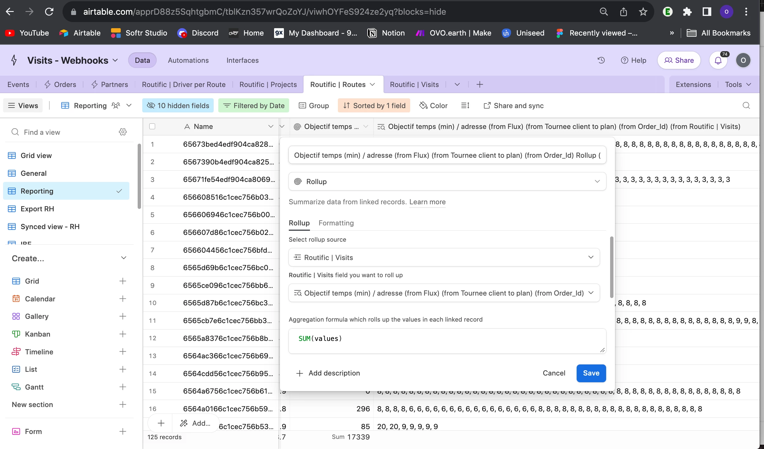

Hello, i'my trying to compare efficiency of real-time project durations to theoric template durations.
Projects are linked to tasks and tasks templates ;
-> total duration of a project = sum of the duration of each task
-> duration objective (efficiency) of a project = sum of the task duration objectives
In each project, Im trying to lookup the tasks theoric duration and sum it up to compare it to the actual project duration.
I'm doing this this way :
- I link projects to tasks
- Each task is linked to a ''task template''
- I look up the ''theoric duration'' of each task and Sum it up in rollup

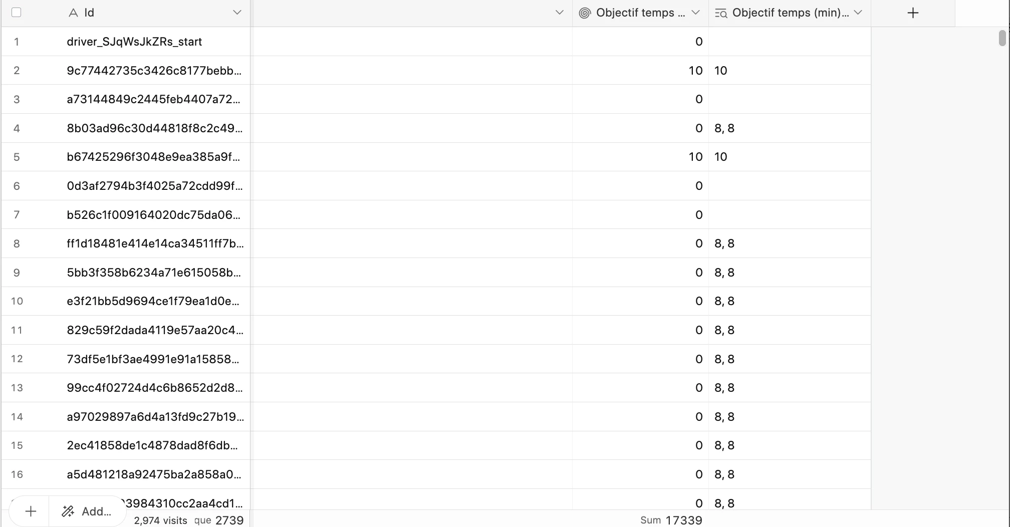

The problem is that the sumup calculation is incorrect : see screenshot ->

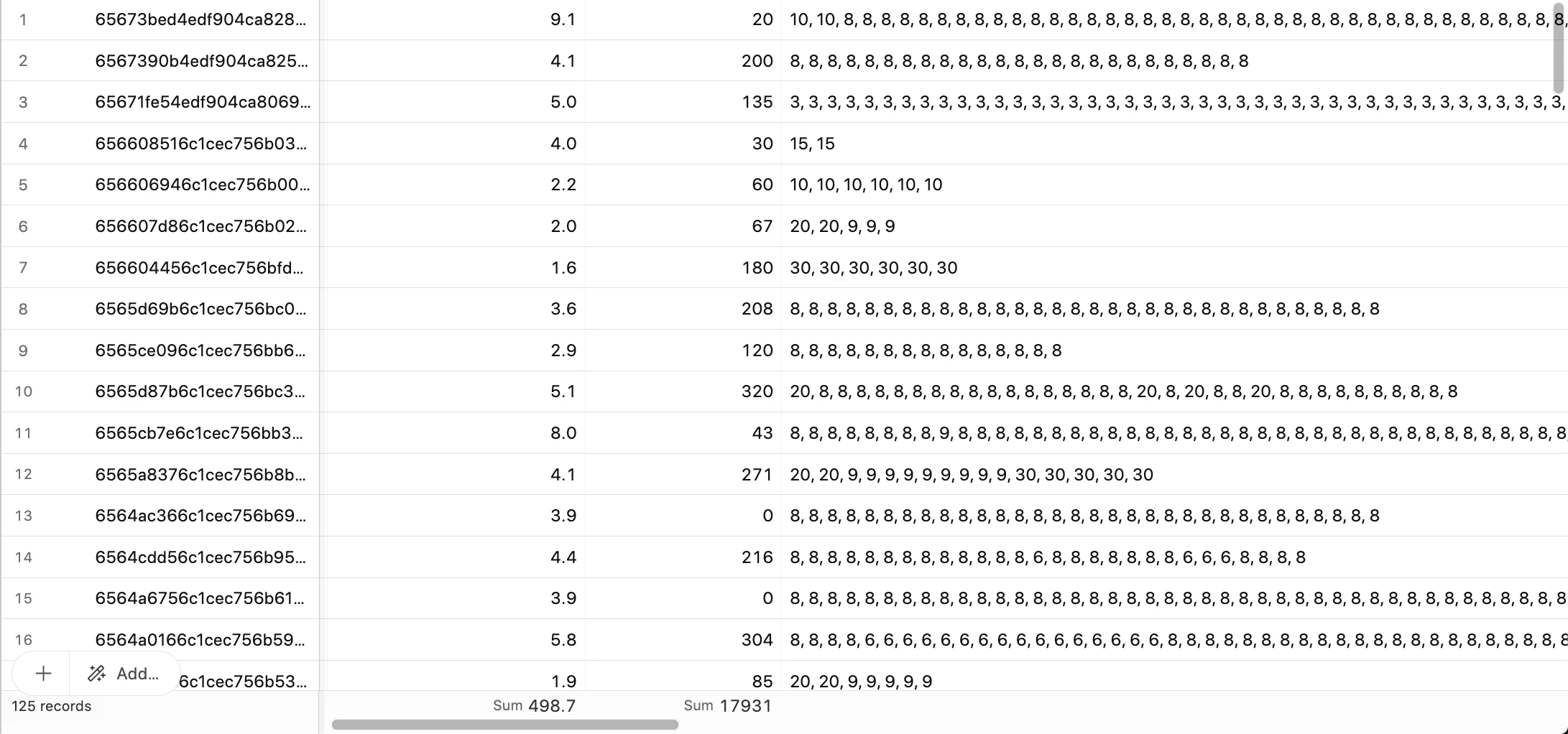

- the first row, lookup values for theoric durations per project are as follow : 10, 10, 8, 8, 8, 8, 8, 8, 8, 8, 8, 8, 8, 8, 8, 8, 8, 8, 8, 8, 8, 8, 8, 8, 8, 8, 8, 8, 8, 8, 8, 8, 8, 8, 8, 8, 8, 8, 8, 8, 8, 8, 8, 8, 8, 8, 8, 8, 8, 8, 8, 8, 8, 8, 8, 8, 8, 8, 8, 8, 8, 8, 8, 8, 8, 8, 8, 8, 8, 8, 8, 8, 8, 8, 8, 8
=> And the calculated Sum is 20...
Does anyone encounters problem with this kind of sumup ?
Thanks for your help

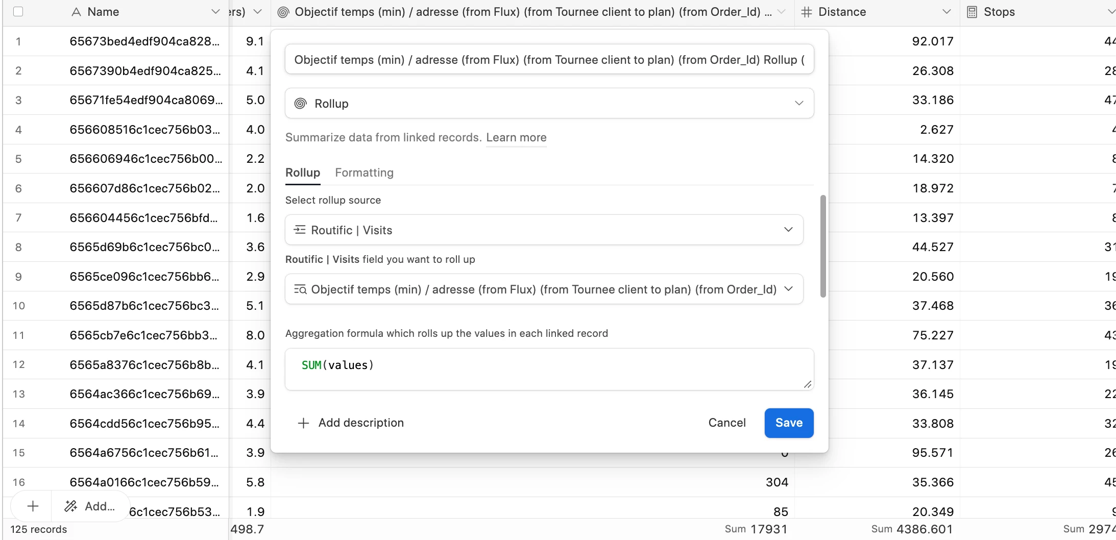

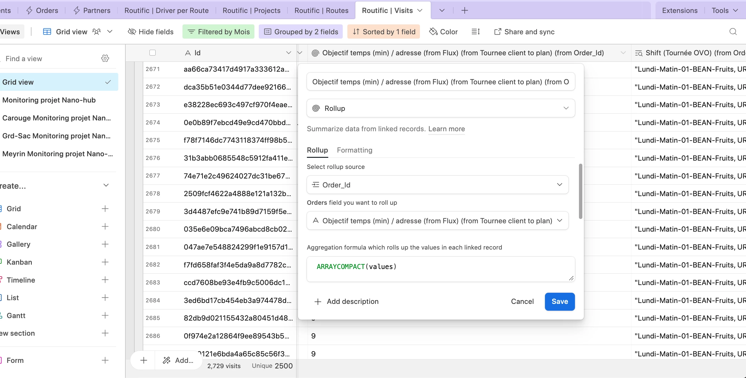

Hello, not sure if i understood correctly, see screenshot of the rollup formatting :
- Table projects (Routes) : rollup of the lookup fields of field ''objectifs temps' in table tasks (visits)
- Table tasks (visits) : lookup from a linked field (order_ID) to get the ''objectif temps''

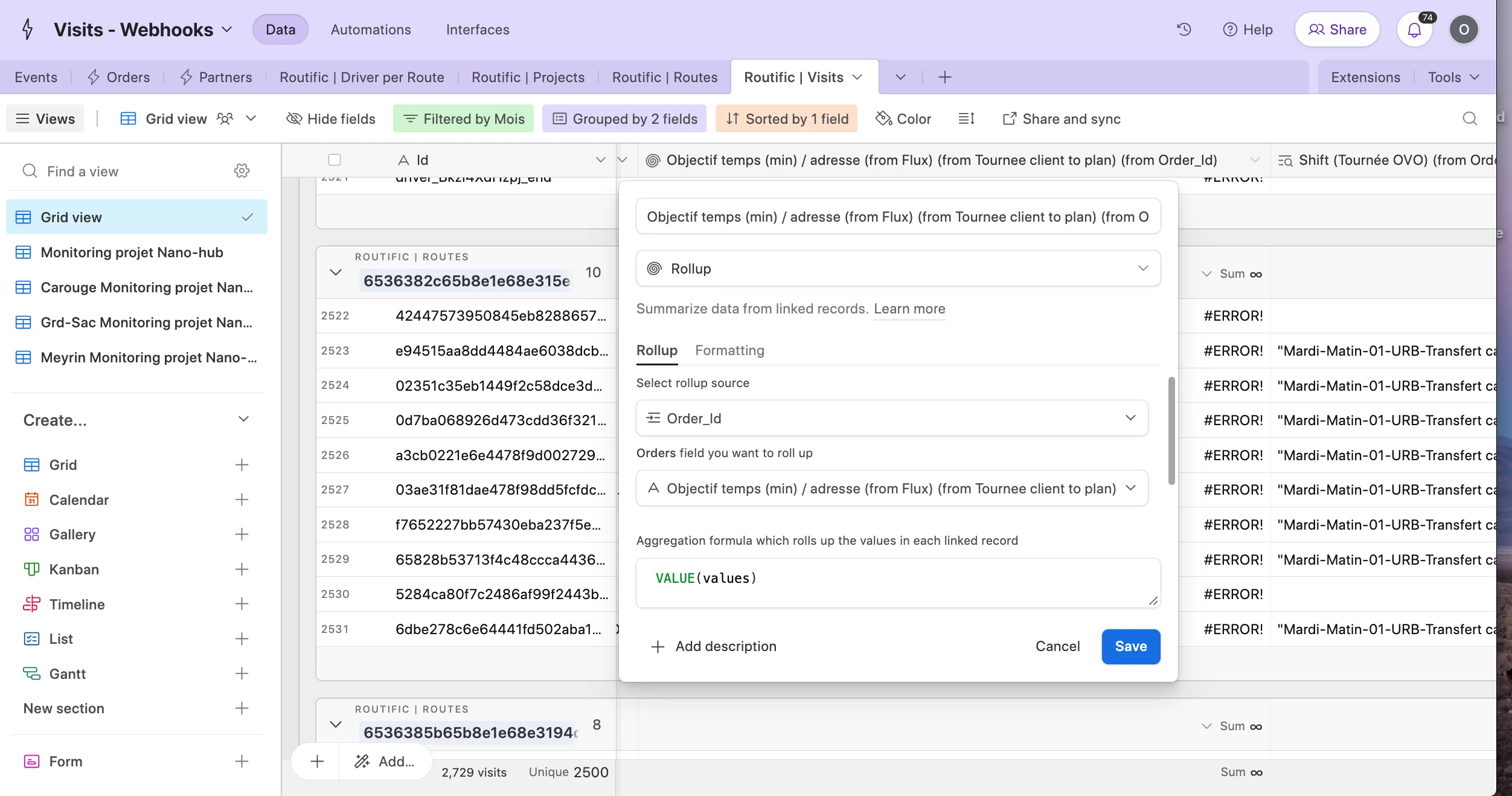

"Objectif temps(min)/adresse" is a string, which may be the reason why the total fails.
If it is a number, it will be displayed on the right side of the cell.
How about changing the Lookup field to a rollup field and using the formula Value(values) to convert the values to a number field?

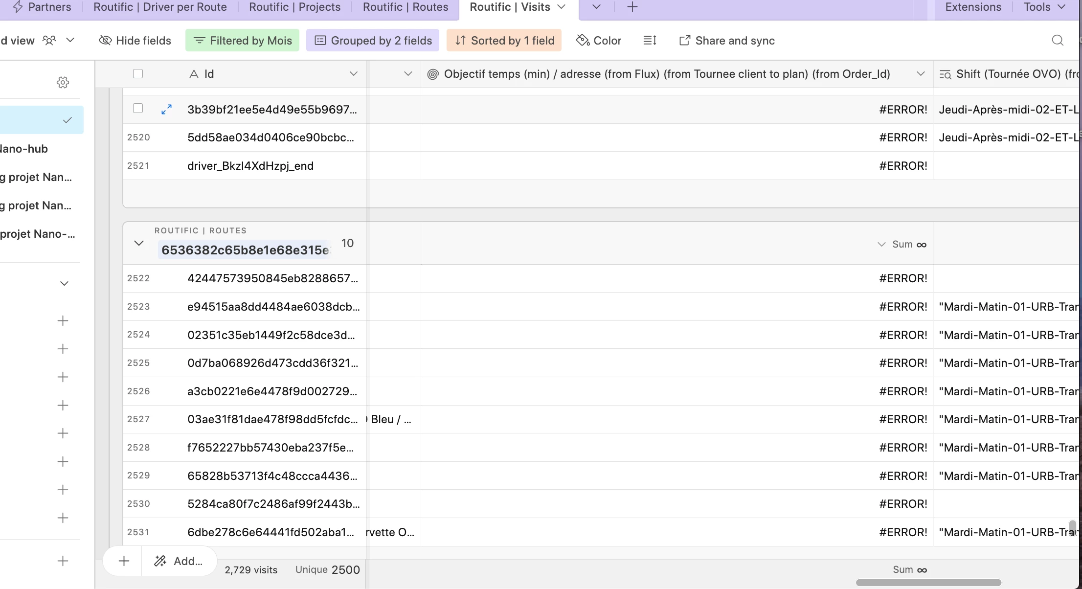

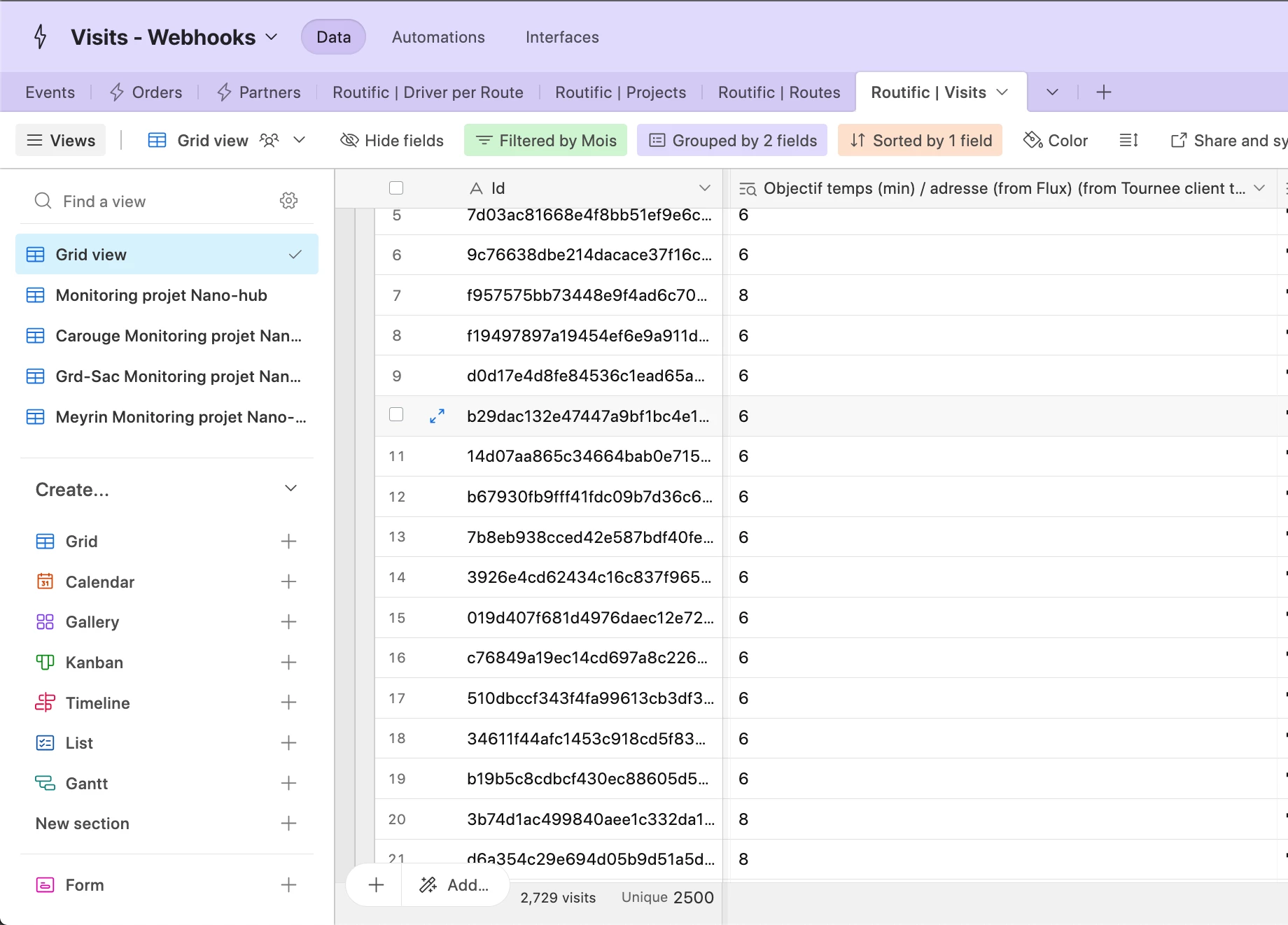

Hello !
Thanks for the suggestion, just tried it but it returns ERROR message, see screenshot

Forum|alt.badge.img+24
  • Dec 7, 2023 2:42 PM UTC
Oops, value(values) is an error.
Try sum(values)

  • Dec 7, 2023 3:21 PM UTC
Try sum(values)

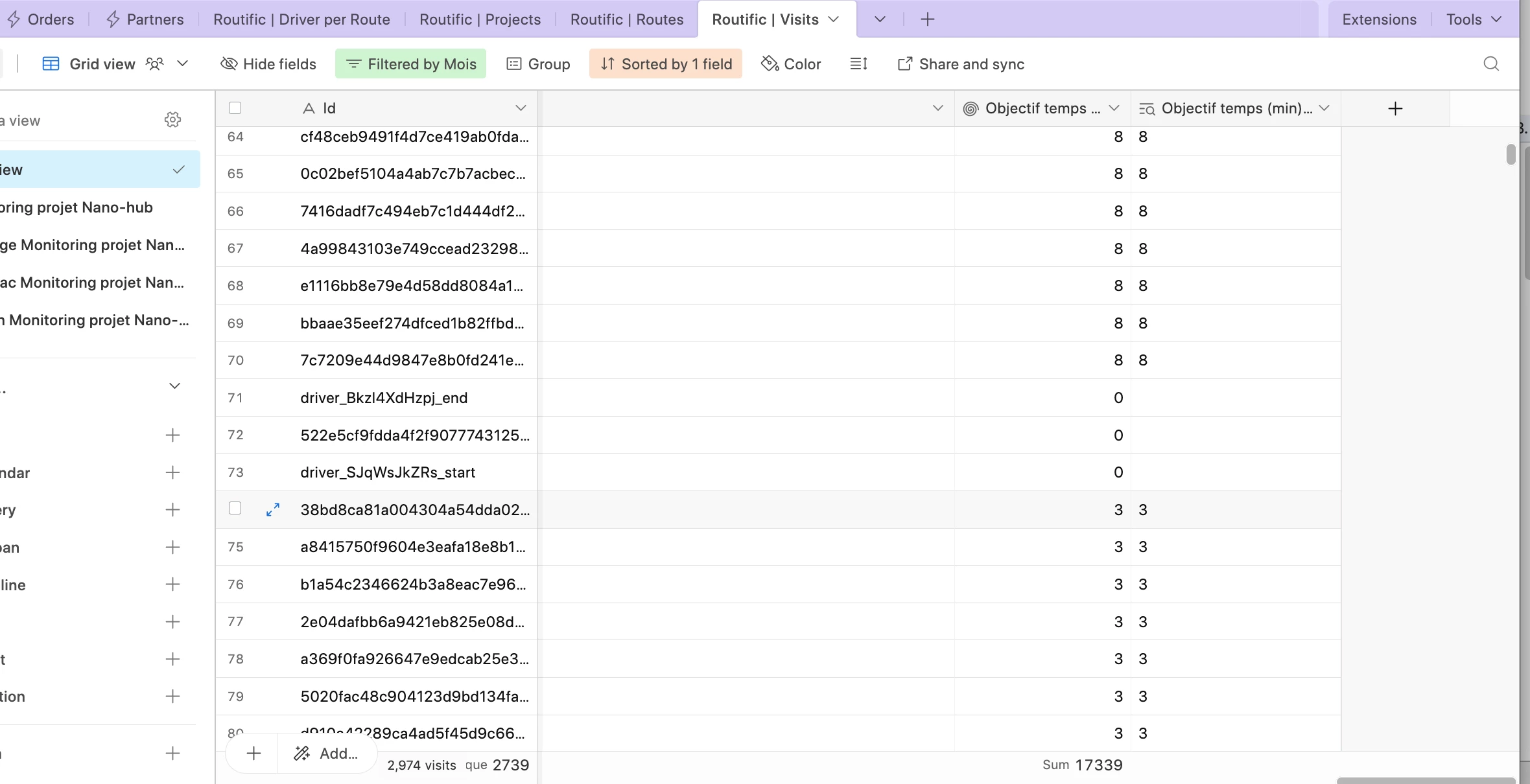

Oh OK guys i think i almost got it ! it seems airtable rollup field switched to 0 the data when the lookup field has multiple values, see screenshot attached
Lookup = 8, 8 ===> Rollup = 0
Lookup = 10 ====> Rollup = 10
Lookup = empty ====> Rollup = 0
Considering this, how do you thin i should solve this ?
  • Dec 7, 2023 3:31 PM UTC
@Databaser is right, the original Lookup field also needs to be a Rollup field.
