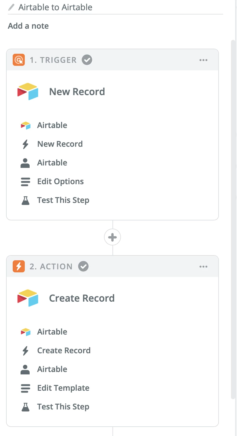

What might work (I was testing this out for another purpose) is the use of a Zapier integration. You can set up a Zapier that says “When a record is added to THIS table, then create a new row in THAT table.”
So here’s what the Zap would look like:

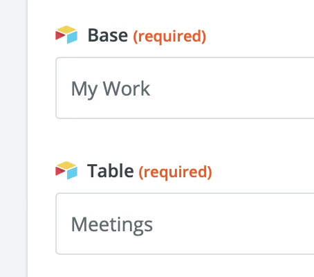

Then the “From” definition would be:

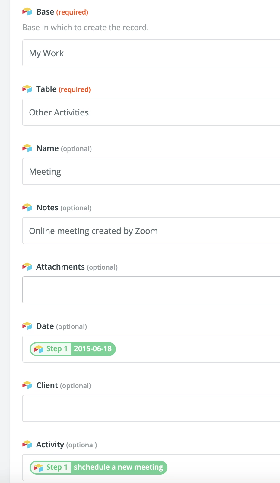

The “TO” entry looks like:
This is saying when a new entry is put into my “Meetings” table in the “My Work Base”), then create a new row in the “Other Activities” table, pre-populating the Name field with the word “Meeting” but then populating the Date and Activity field with the values from the form.

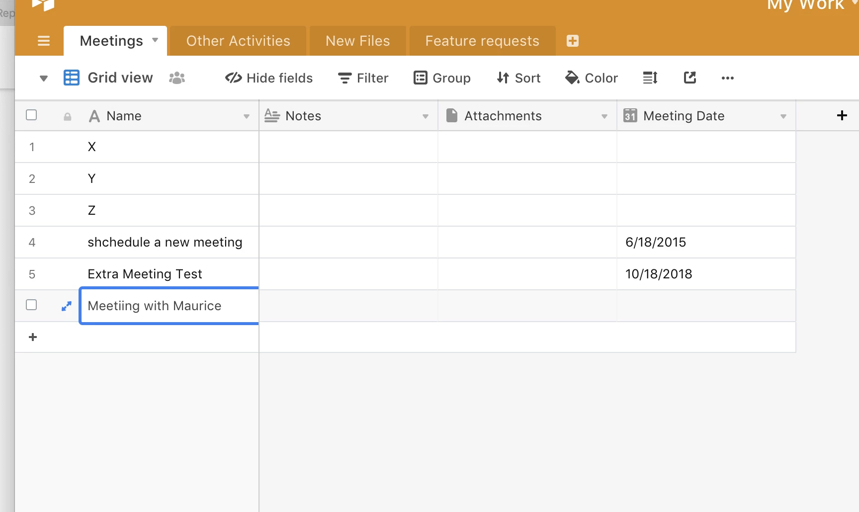

I have one Base with three tables: “Meetings”, “Activities” and “Feature Requests”.

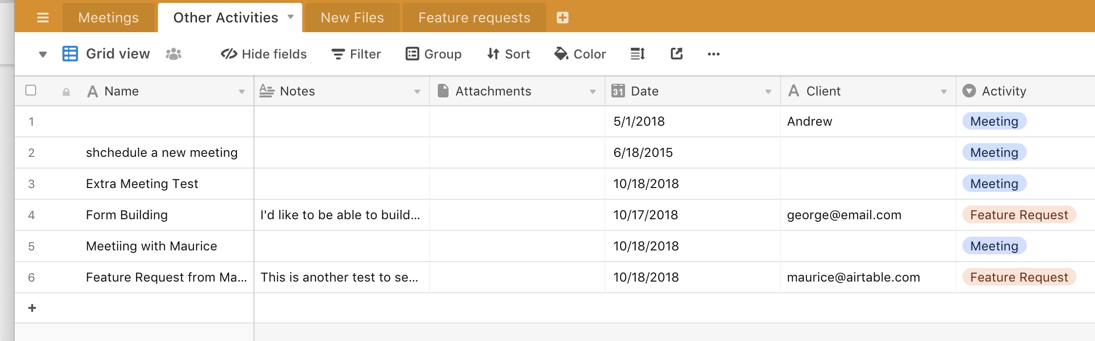

I have one zap that says when a new record is added to the Meetings table, look for an entry in Activities with the same Name and if it doesn’t exist, add it using the word “Meetings” as a Type.
I added this entry.
Then waited ---- remember that Zapier takes 5 minutes to check.

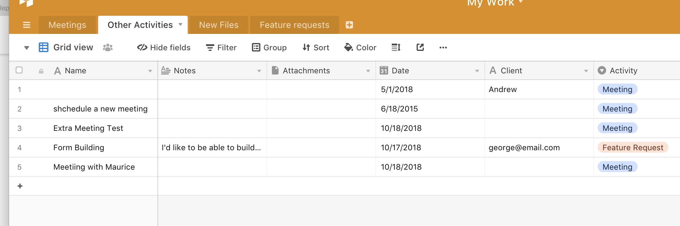

And voila:

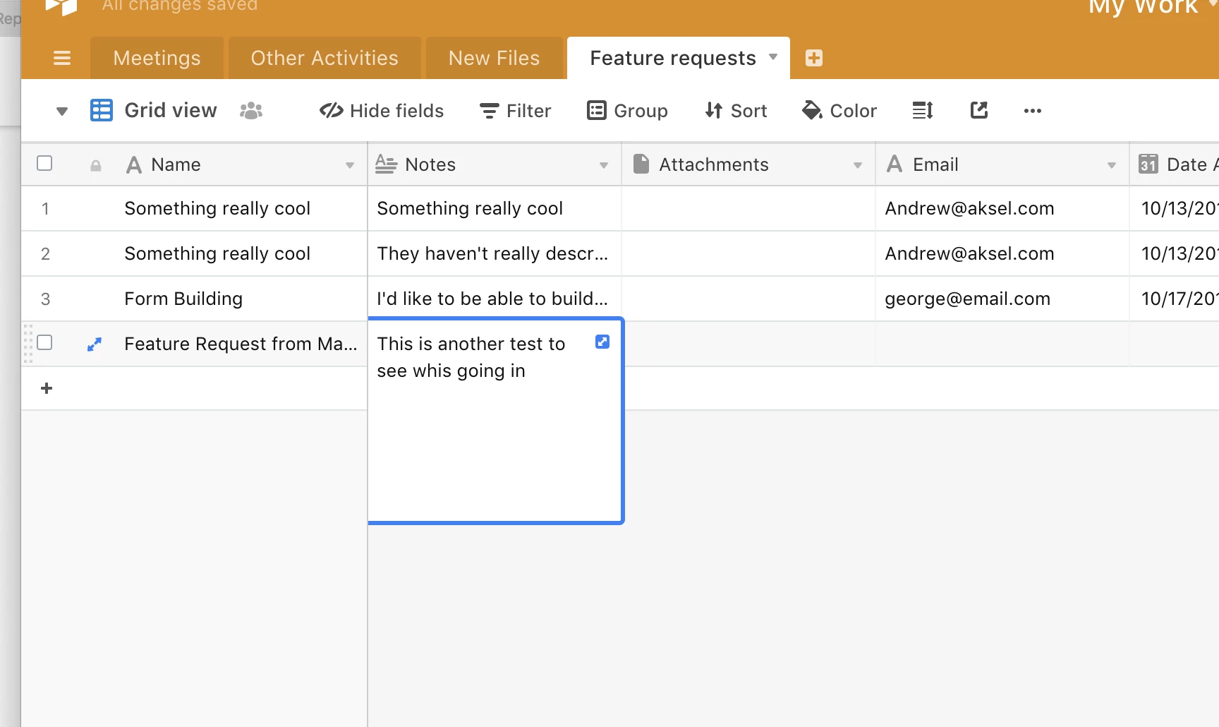

I have another Zap that works exactly the same way but uses the Feature Requests table as an entry. My entry:
Here are the results…five minutes after

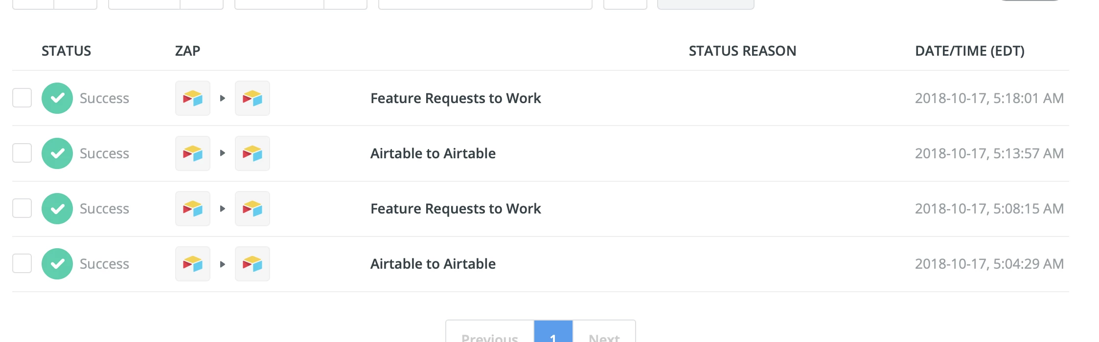

Here is what Zapier shows…
Now note the time differences - it does take a few minutes for the changes to show up.

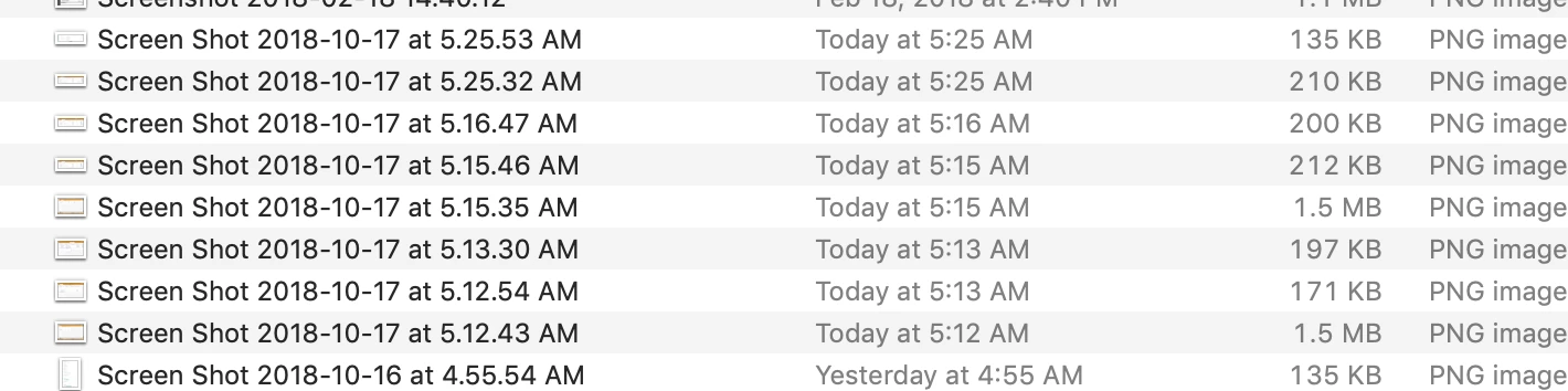

Here are my screen shot dates so you can see they were taken at the specific times.
So the logic does work, it may just take time to show up. Let me know if there’s something more I can do on my end. The only trick here is to ensure you have a field in the originating table that can be used as a unique key field name in the activities table.
