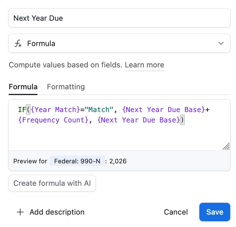

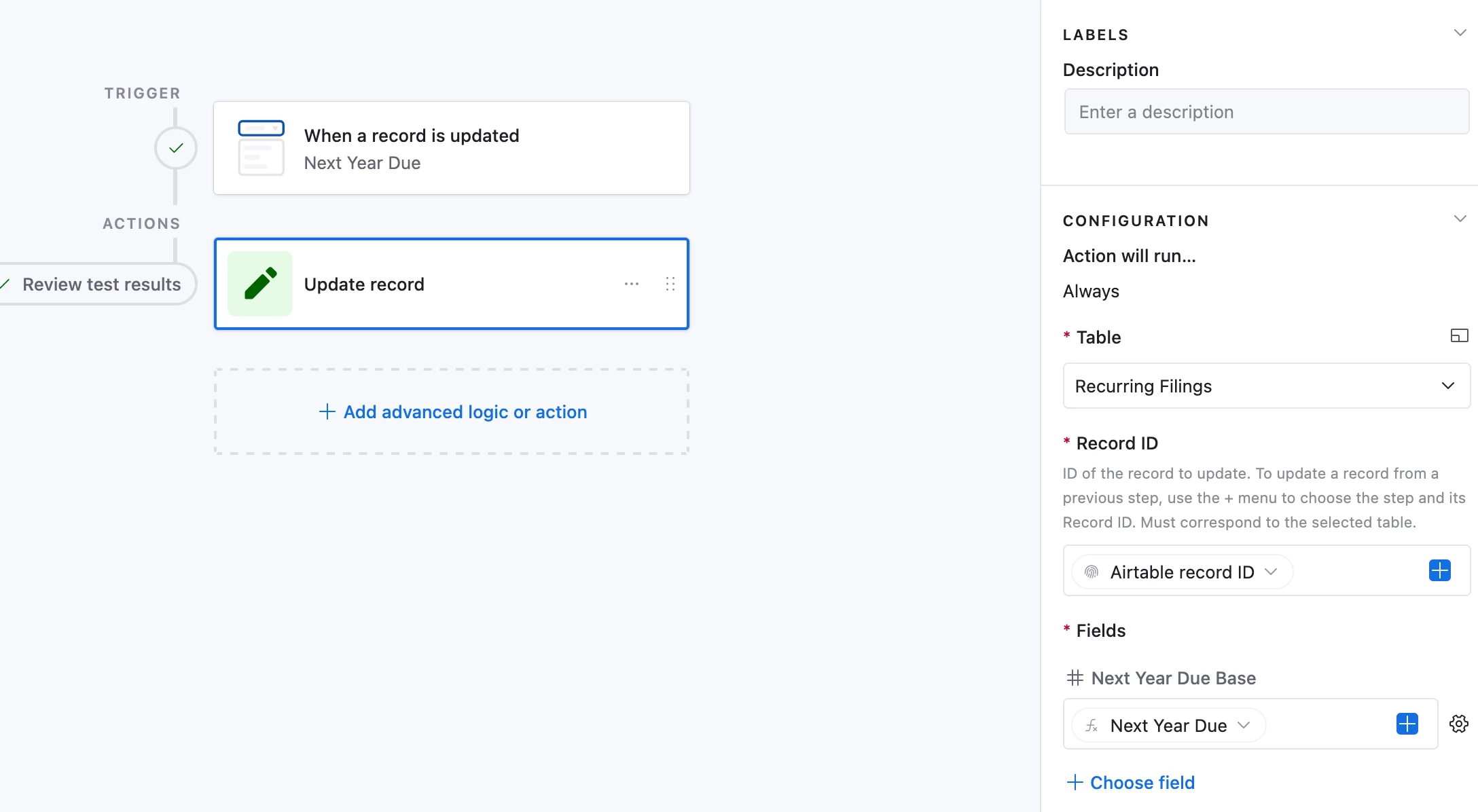

This worked, thank you!! I did find another complicated way to do it that required adding several unnecessary fields and didn’t actually use a date field at all. First, I added a formula field that looks at the single select frequency and generates a number based on the selection (annual = 1, etc). I created a number field that I titled as “next due year base” which served as a starting year for the due date. I changed my match to check against that (set it up to not show the thousands separator). To calculate the next year a form is due, I did a formula field that said if the years matched, add that frequency count field to the base year.
From there, I set up an automation that when the next year due field updated, to update the “next year due base” field with that value.
I also created a single line text field with the month/day of the due date since that is static each time. To get a field with the full updated due date, I did a CONCAT formula to combine the month/day field with the next year due.
In the end it worked, but I’m very happy to now get to delete a bunch of unnecessary fields!
